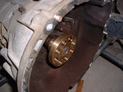

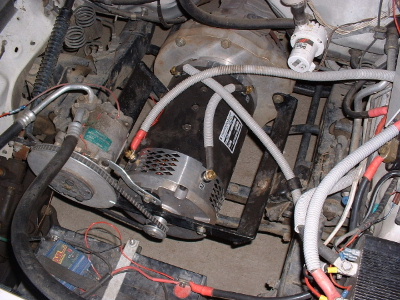

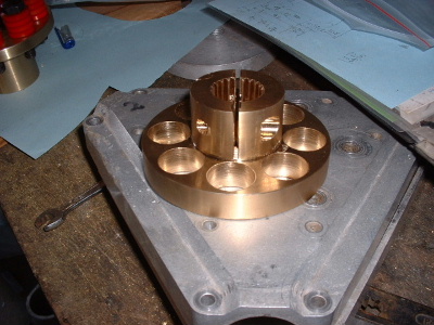

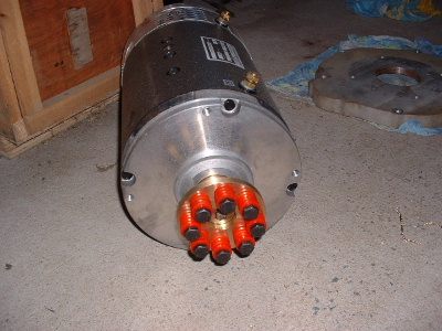

New motor, same as the old one, but with a shaft out the front to fit the airconditioning. The airconditioning pump does not show any variation in the amp draw of the motor.
Nothing wrong with old motor, used for testing on Foxcon aircraft test rig. If anyone wants to buy it let me know.

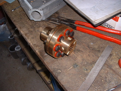

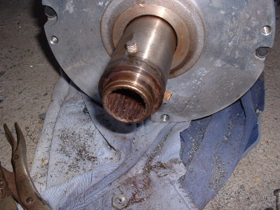

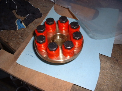

After removing old motor, found that he spline from the centre of the clutch plate was almost all worn out. It had rusted slightly too, so was extremely hard to get off.
A new flex coupling was cast and machined out of Manganese Bronze. The part that fits the spline of the geabox shaft is clamped with 2 bolts through the sides. The part on the motor has a bolt in the end of the shaft. The only movement now is on the red washers, easily replaced. This is the same design as the coupling that we make for Foxcon, the connection between Subaru EA81 motor and reduction drive box on their aircraft.

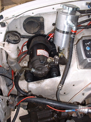

Power steering is now complete and works very well. Runs on 12v. Amp draw is 15A going up to 50A as required when turning. Super quite. Highly recommended for any power steering needs.

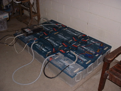

Posted: 10:23am 21 Aug 2008
Had done some driving in town to see what range may be possible with the Pwersonic AGM batteries, at town speed and driving conditions.
I did not drive continuously until batteries were empty, but in approx. 50km I had used less than half the power according to the Curtis fuel guage. I think it is safe to assume that 120km or so should be acheivable.
There is no sign of power or capacity loss with these Powersonic batteries, but the new set of Thundersky Lithium batteries have arrived, so the Pwersonic batteries will now take on a different role.... wind and solar power.
The 2 dirty ones (outer corners away from the wall) were the ones in the back box.
768kg out.
Speedo reading was 350153 minus original speedo reading of 340092 = total distance driven of 10,061km minus the couple of weeks with the first set of lithium 635km = 9426km. Not bad at all, with no sign of slowing down yet.
Edited by Trev 2008-08-22
Trev @ drivebynature.com

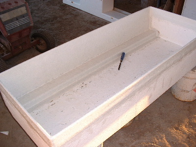

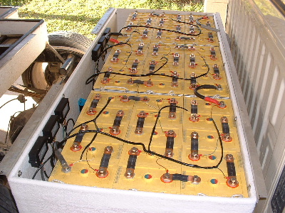

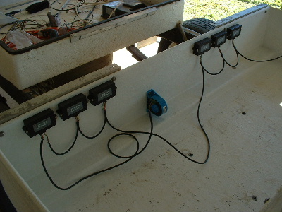

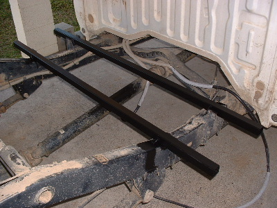

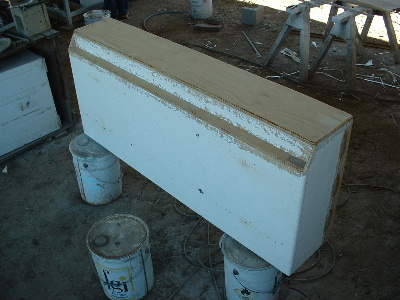

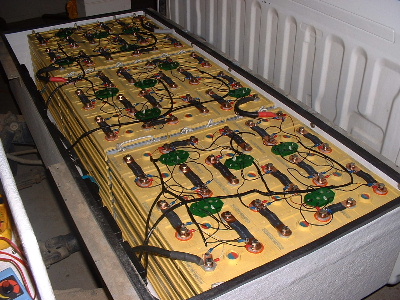

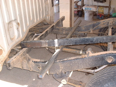

Time to make the changes needed to accomaodate the new set of Thundersky Lithium Batteries.
The back part of the battery box was cut off and the height of the box raised. This was all glassed over and flow coated again.
The steel mountings on the chassis was cut out and lowered, one at a time to be able to measure the new height. The new steel rails are welded in, same as before.
The bolts that hold down the box have also been changed to 8 x countersunk M10, 12.9 grade high tensile. The bolts themselves have more holding power than the 6 others that I used to have, and now with less than half the weight, but have used more bolts as I now don't have big flat washers.
342kg in.
It has been discovered that the Thundersky recommended BMS does not equalize the cells, but Thundersky still maintain their recommendation. We are using & testing this BMS for now.

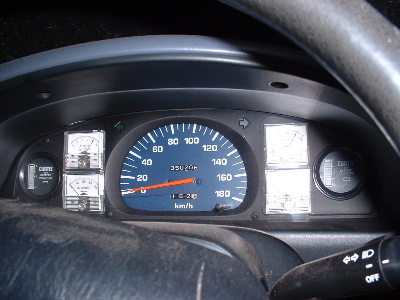

The speedo reading for the change of batteries 350153. Photo taken at 350208

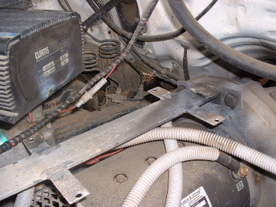

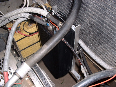

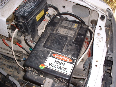

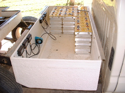

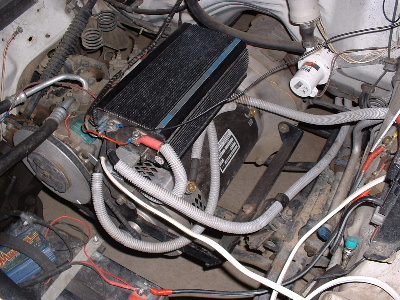

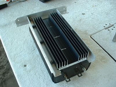

Couple of months ago I changed the speed controller to above the motor, in more air flow. The reason, behind the left headlight is very little air flow. In the summer the speed controller had cut back because of excess heat. But, on top of the motor, it has proved to be not as good as I thought. So I will shift it again, when I can find some time.
The other reason is, I wanted the space for the Zivan NG3 charger. I could not put the charger above the motor because it is not sealed against water ingress. Here in the front corner is ok for it. I have driven in rain, and has not been a problem.
Now there is no power in the rear box.

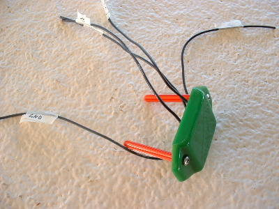

Gordon [GWatPE] has made an equalizer for 4 x Thundersky cells. Thanks heaps Gordon. I changed the AGM lead acid 12v for 4 cells x 90ah Thundersky Lithium in my EV.
Cell voltage balancing is a significant problem with lithium batteries. Overvoltage and undervoltage of LFP cells can cause damage, or cells can just stop working, (even fire in other lithium chemistries). LFP are deemed to be fire safe, but still the voltage boundaries must be observed.
I have seen individual cells in a battery pack with up to 0.5/0.6V variation between cells during charging. This is not good. When one or more cells have a higher voltage than the others, the chances of reaching an overvolt situation with these cells is greater. In my main pack I have to watch the end of every charge and manually switch of the charger when the high volt cells reach there maximum voltage. The Thundersky BMS is helpful by monitoring and signalling an alarm when overvolt occurs (I set to 4.1v/cell, max is 4.25v), but does not equalize the cells.
The Thundersky BMS also has external alarm outputs which could be connected to automatically shut down the charger, but still does not address the problem of reduced overall capacity of the pack. While some cells are full, the others are not.
I have tested Gordon's equalizer here and it works extremely well. It is connected to the battery cells only. I don't know exactly how it works, but it makes the cell voltages become equal. It seems to equalize the cells at all times. It has a high voltage warning LED, but the charger could not reach the high volt warning. It has a low volt warning at 12.4v (12.4v/4cells = 3.1v) and another low volt warning at 11.2v (11.2v/4cells = 2.8v).
It is not like other BMS. It is not dependant on a charger. It does not have charge current bypass at a particular voltage on any cells. It does not burn off (wasted as heat) any power as other BMS units do.
As already said I have seen 0.5/0.6v differences in these 4 cells while under charge. These recordings are when I first connected Gordon's cell equaliser to the battery and covers the first charge.

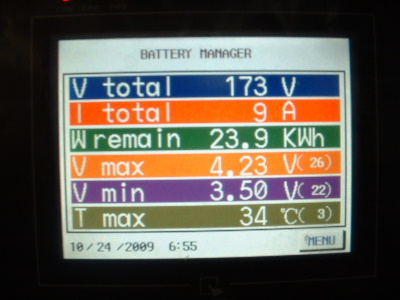

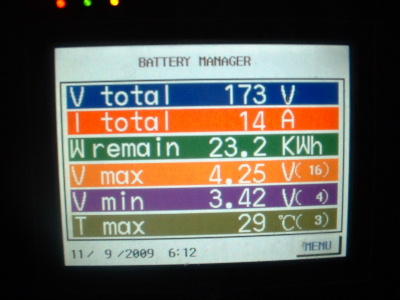

Trev
Joined: 15/07/2006
Posts: 676
Posted: 11:31am 17 Nov 2008

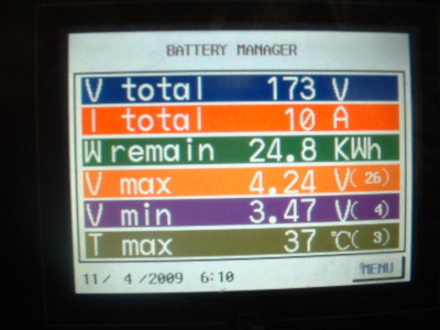

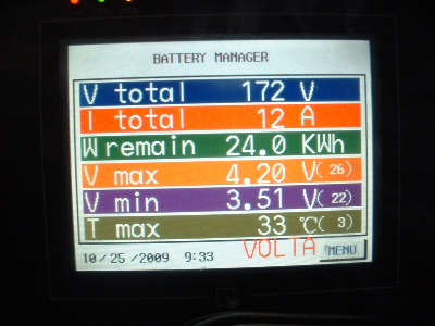

The equalizing issue is a big one.

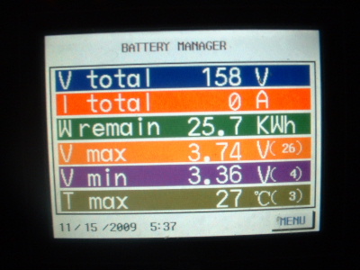

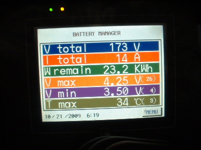

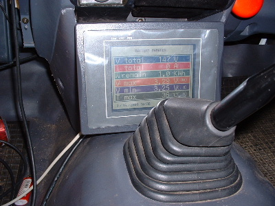

To be told that the Thundersky recommended BMS (Battery Management System) was the best there is, is simply not true. However, I do give a big thankyou to Thundersky for clarifying that this BMS does not equalize the cells. To cut back a charge current or switch off the charger (Thundersky Charger) altogether when a cell reaches its maximum voltage does not allow the full potential of these batteries. Don’t get me wrong, this BMS is a great Battery Monitoring System. It does have a lot to offer for a monitoring system, however the low and high voltage alarms are not consistant.

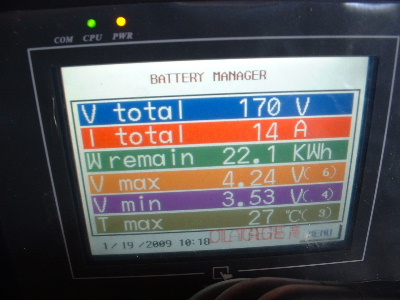

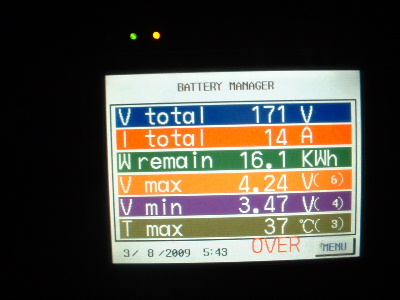

With no equalizing, each cycle the cells become more and more out of balance. When I first fitted the TS-200ah cells the difference was around 0.3-0.4v between the highest and the lowest cell in the pack of 45 cells. Over time this difference has become more outstanding. At times, for some unknown reason they appear to be equalling.
After a while I started to photograph the screen. The dates on the screens are wrong, but I think I have them in order. Here you can see the red writing at the bottom of the screen, sometimes but not at other times, which is over voltage alarm. I set this over voltage alarm to 4.1v. The charger was manually switched off whenever a high voltage was reached. Very annoying every morning keeping a check on the battery charging. The kWh reading is also wrong, don’t take any notice of that, I have not calibrated it properly yet. In each screen, the differences are 0.71v, and increased to 0.77v, then decreased 0.75v, 0.73v, 0.69v, 0.66v, but then started to increase again, 0.77v, and 0.83v.

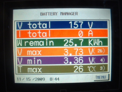

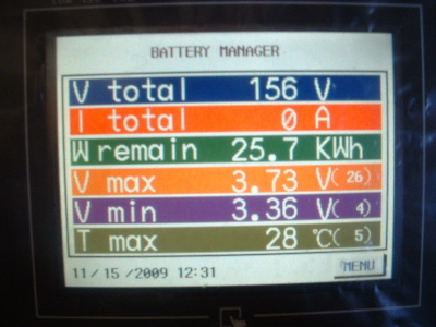

Trev
Joined: 15/07/2006
Posts: 676
Posted: 11:38am 17 Nov 2008

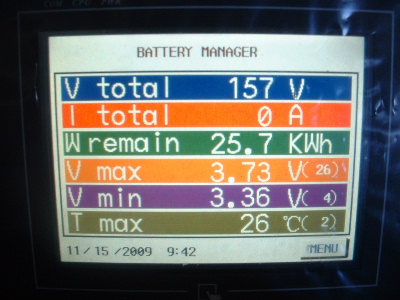

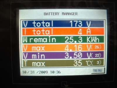

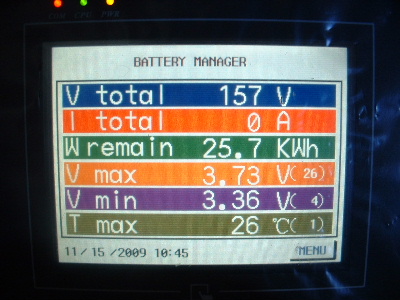

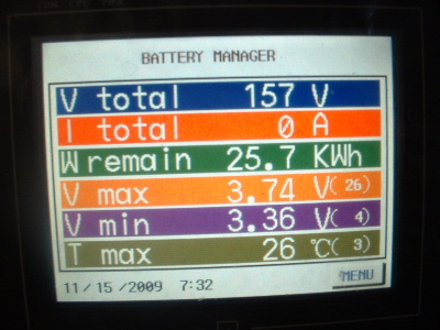

Here are a few screen shots after charging, after the voltages have settled. The date is still wrong, but take note of the time on the screen. There is no equalizing.

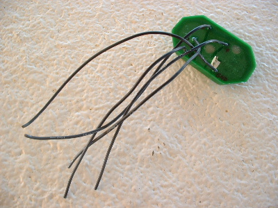

Trev
Joined: 15/07/2006
Posts: 676
Posted: 10:00am 19 Nov 2008

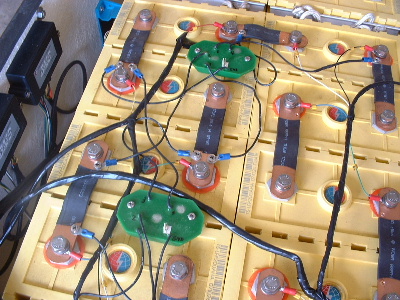

Here I believe is the answer.

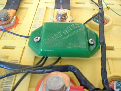

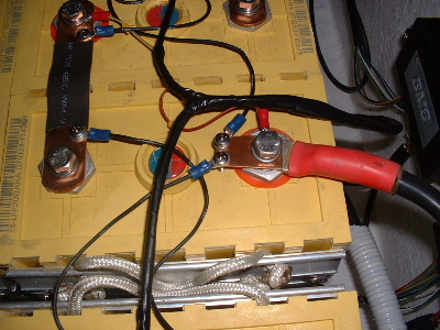

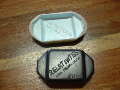

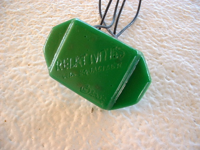

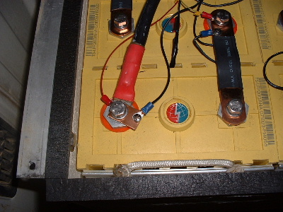

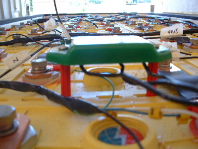

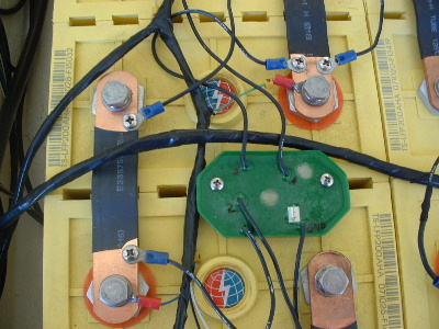

I received the new equalizers from Gordon. The circuits are smaller than the original prototype. A potting box was made and all the circuits were sealed to protect from dust, water and vibration. The circuit fits in the thicker part of the potting, leaving the thinner wings able to be drilled for mounting. The name given to this equalizer is Relativities and is engraved in the original pattern. It is a Lithium type battery cell voltage equalizer.
I wanted to mount them with the name up as shown in the first few pics but because the LED indicators are on the other side it makes more sense to have them on the top. The 2 LED’s are directly under the white circle area seen on the side where the wires come out. One LED is to indicate the circuit is on and working, the other is to indicate high or low voltages. This same side also has the plug connector for a lead wire to have a LED in the vehicle cabin to indicate these high and low voltages.
Red wall plugs are a very good fit in the gaps between cells (200ah) so these were screwed on and simply pushed into the gaps between cells.
These equalizers are made to equalize 4 cells, but in larger battery packs they are overlapped. I have 15 equalizers to cover the 45 cells in this pack, each equalizer is overlapped by one cell except the equalizer on the most negative of the pack is overlapped by 2 cells. All wires must be used for the equalizer to function.
These equalizers are very voltage sensitive, so much care must be taken in connecting. The battery cells must be connected in series and these connections cannot be broken. The wires must be connected in the correct order or they burn out. To best facilitate this all individual wires need to have there own screw down point. Push on connectors are not acceptable, as one poor connection with vibration over time will lead to burn out.
All connected and all working.

I like to comment on your very neat installation and pass on a tip that may help with the long term reliability of the battery connections.
I see you use plain copper bus bar type links. These might want to be tinned once you are past the experimenting stage.
One of my jobs in the past involved making switch boards with lots of heavy gauge copper bus bars. They were always tinned at the connection area. Having seen how quickly plain copper can go green with moisture present, the tinning was well worth the effort.
If you have never tinned before, get the thickest resin cored solder wire you can find, a non synthetic rag and a propane torch. Heat the busbar end with the torch, testing frequently with the solder as you don't want it too hot. Once the solder flows freely cover the contact area and, very quickly, wipe it off with the rag. You have a neatly tinned contact area on both sides now.
It does help to wear some heat resistant gloves for this job

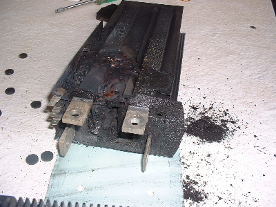

The Curtis speed controller burnt out and so the Hilux has been parked. The new speed controller arrived today and has been fitted up front with heat sinking, something that should have been done a long time ago.
Curtis say that heat was the main contributing factor for the premature failure. They say that if the speed controller cuts back at all, then more heatsinking is needed. In all locations, I have had this heat related cut back, at least twice that I remember, cut right out. With a little time the speed controller cooled enough to drive again. But this time when it burnt out, it did not cut out, it went full throttle, proving necessity of the battery shut down switching.
Curtis think that it should be ok now. Time will tell.
