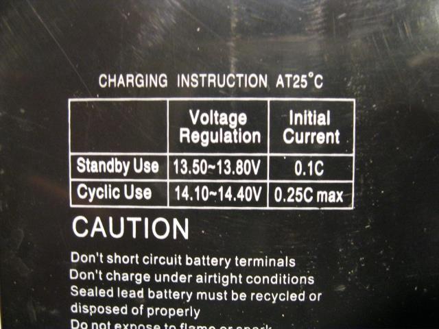

My daughter has a 36 Volt electric bike, but the batteries are dead (I measured 0.7 Volt across the terminals of each 12 Volt battery). So I assume that there is no hope of recovery. Each battery is 12 Volt, 12 AH.
Thus I'm looking for replacements. I have attached a photo of the info on one of the batteries. Could someone please tell me what 0.1c & 0.25c means?
Posted: 08:58am 13 Aug 2018
Larny, AFAIK your 12Ah = C. So 0.1C = 1.2Amps, 0.25C = 3 Amps.
You cannot charge sealed batteries too fast hence they show the max charge current. Do use a proper regulated charger.

Posted: 09:42am 13 Aug 2018
Thanks Klaus,
That's what I thought but could not confirm it with internet searches.
I understand that charging batteries in series is not a good idea as one battery can be overcharged (or possibly under charged) so I am intending to use 3 chargers - one for each 12V battery.
The reason I wanted to know the meaning of C is so I can design a current limiting circuit that will not allow the current to exceed the safe threshold.
So it appears to me that I should set the limit at a little less than 3 Amp. Is that correct?
