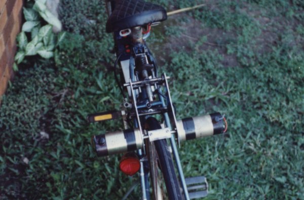

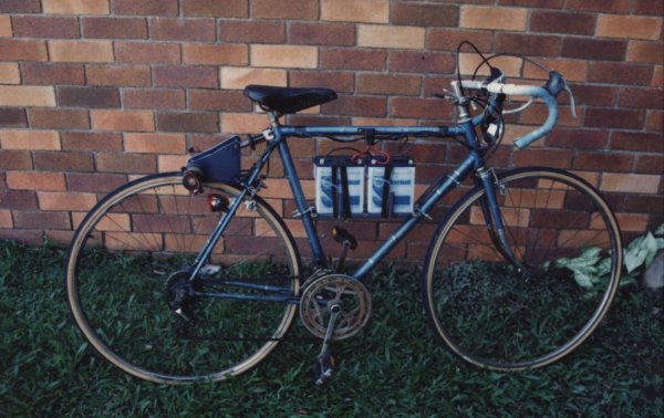

I was sorting out some boxes of junk and I found these two photos.
I made this about 15 years ago. The two motors were from old Telecom Telix machines, about 100 watts each. They share a roller drive on the back wheel, the whole assembly held against the tire with a simple shock absorber made with a Datsun engine valve spring. Power was from a couple of motorbike batteries, 24v in total. The control was simple, basically two speeds with the batteries either in series or parallel to give 12 or 24 volts.
I remember it worked pretty good. I used the bike to go to the corner shop every evening, about a 2km round trip. The batteries needed charging every couple of weeks. Top speed was 20khm. The motors didn't have a lot of power, they could accelerate the bike from standstill, but hills were a no no. Puddles of water were a problem, the roller would slip and spray water up my back!
It was a fun project. I still have the bike, but the EV bits are long gone.

Hey Ron, some details from memory.
The motors are mounted end to end, with one motor connected in reverse. The roller was made from a short lenght of 25mm aluminum rod, drilled to suit the motor shafts and grub screws fitted at each end to tighten onto the shafts. The whole motor assembly could be adjusted from side to side to center the roller, and tension against the wheel was also adjustable. More tension reduces the chance of slip, but increases current ( increased current equals less speed and less range ). The trick was to back off the tension till it was about to slip.
Control was a single DPDT switch, center position off. Sit down with a bit of paper and you can work out how to wire it up. Dont forget to add a fuse!
