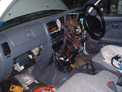

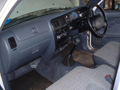

That fan on the dash - I beat it. It now works.

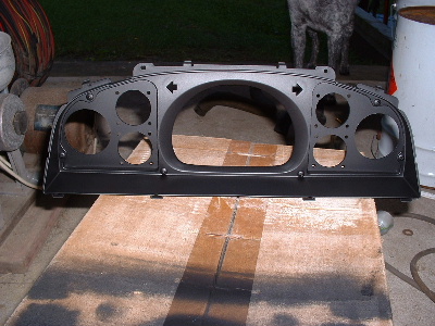

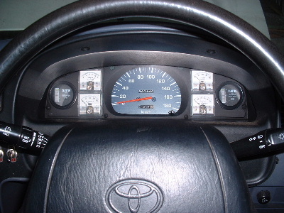

Have run some wires for the guages that will be in the dash. The other guages that I ordered should be here in another week or so. The 2 x fuel guages (12v & 144v) have been fitted to the dash panel.

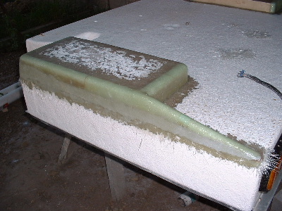

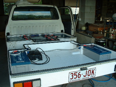

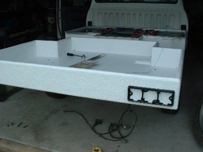

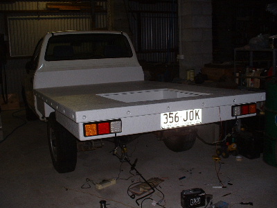

The rear storage box is fitted.

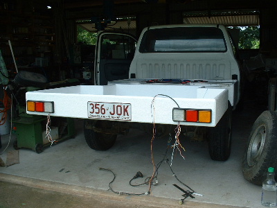

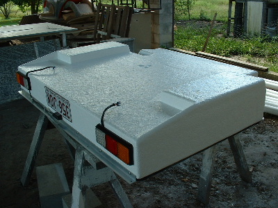

The rear lights also fitted and wired in. Still yet to cable tie them up. The lights are these new LED type that use very little power. Though not really significant in terms of the volume the main motor will take.

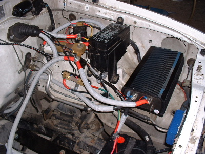

The megapulse units are strapped in for protection.

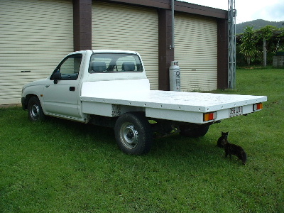

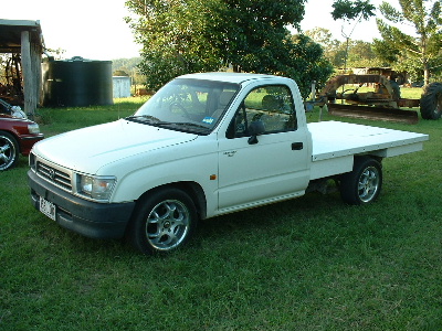

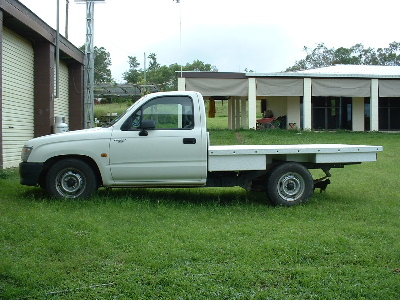

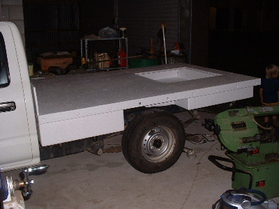

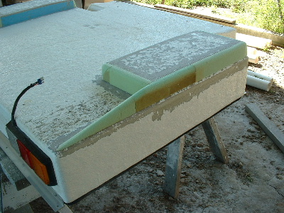

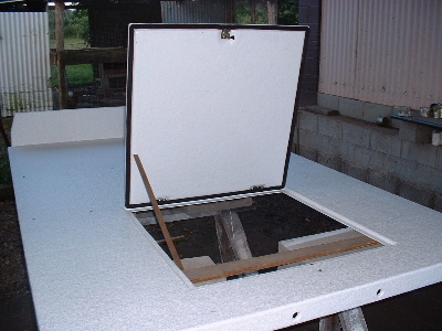

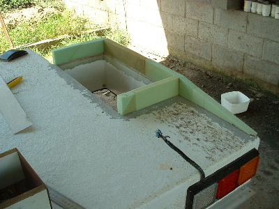

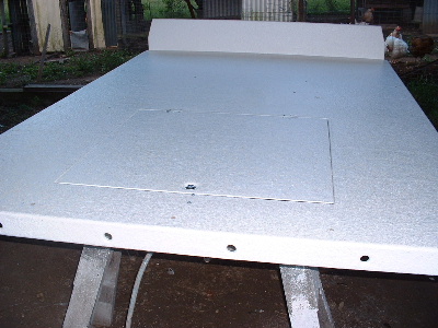

The tray is on. The hatch cover is still waiting for the rain & humidtiy to drop off, so it can be flowcoated.

Only got the hatch flow coated and fitted this week.

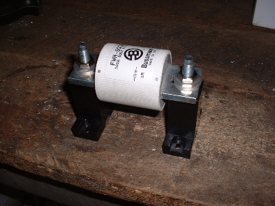

Fuse(500A), SWE-FWH, $225

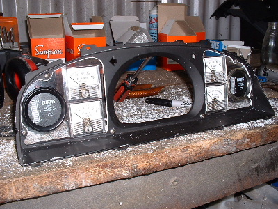

I really thought I would have had the volt & amp gauges by now, but they still have not showed up. The dash is basically all that needs to be done so I can go for the modification plate.
Also the big 500amp fuse. When I re-run cable to the 500 amp shunt, then this fuse will also be incorporated.

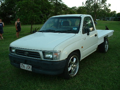

We had an afternoon with family and friends trying on different wheels.

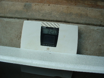

Also pictured here is the Tray weight(- the hatch)32kg. And the 500amp fuse yet to be fitted.
Gauges have arrived, very good quality too. The dash has been cut to fit the gauges in. These will be fitted and wired in when other important bits are done (see below).

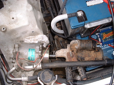

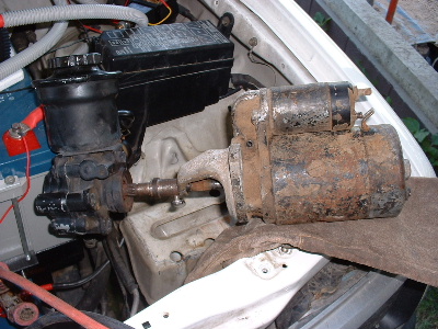

Tested the amp draw of an air conditioning pump clutch, 2.8 amps at 12v.
Tried several motors on the air conditioner and power steering pump. The only one that could give some decent amp draw readings was the modified starter motor. The linkage from the solenoid was disconnected and wiring not used. I rewired the brushes to make it spin the right direction. The end was cut off to expose the end of the shaft. Made adaptors to connect to the pump’s.
Connected to the air conditioner pump the amp draw (12v) was 200 amps.
Connected to the power steering pump the amp draw (12v) was 110 amps.
The quest for sourcing motors for these pumps still continues. Although I am now thinking I may not use the power steering. There is a commercial made power steering pump available for vehicles that do really require power steering. We can steer the vehicle without too much hassle.
Have discovered a weight problem in the front, and currently modifying the rear box under the tray to carry the two batteries that finished making up the 144v system. With 126kg of lead shifted to the back, this makes the steering even better. With this change, also comes other changes that go with it. New mountings & cabling etc.

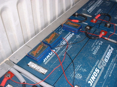

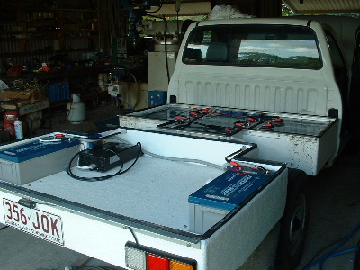

Some pics of modifying the rear storage box to fit the big batteries that used to be in the front. Batteries are now fitted and the necessary rewire is complete.

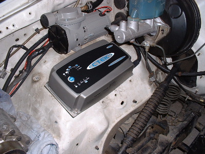

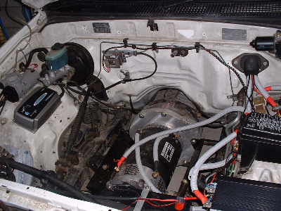

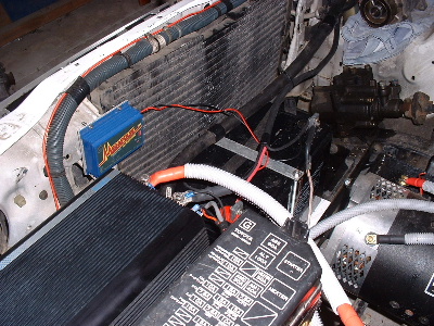

Amp shunts and 500amp fuse is fitted. The speed controller and the two chargers are re-mounted differently too. Gauges fitted but dash not completely back together yet....tommorow. Pics on these next time.

Pics of the new mounting for the speed controller, also showing the 500 A fuse and the amp shunts. Only one short cable could not be reused in the new configuration, an extra cable had to be made and one had to be lengthened.
The 12v charger is re-mounted on the right hand mud guard. The 144v charger can be seen in the previous post, in the rear storage box. The 12v battery has been downsized for now and left in the same place the larger 12v battery was. We plan to change this later to 2 x 120 a/hr in the rear storage box and none in the front. So then the 12v charger will also be shifted to the rear storage box.
The dash is all back together now.
