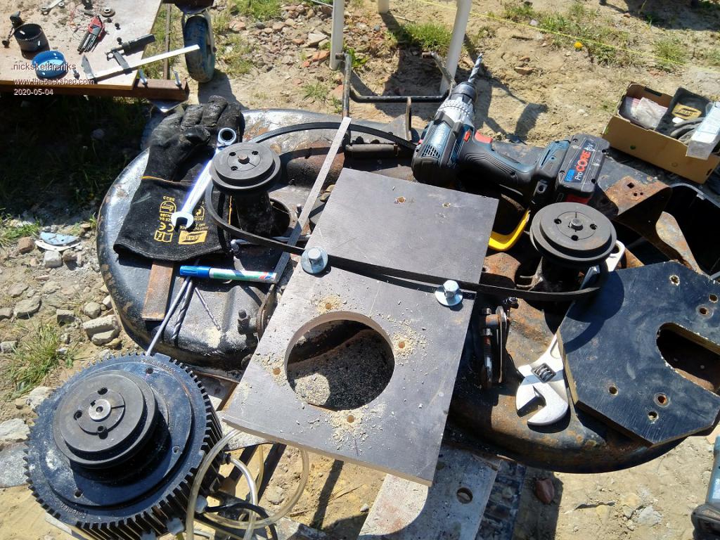

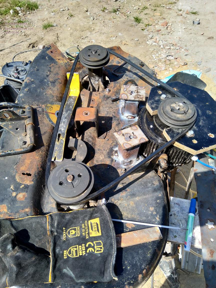

I will use a goldenmotor 5KW 48V, I just did a test ride on 24V and it was actually just enough to cut the long grass with sharp blades. No load was 20A, I think around 60-70A when cutting the high grass. It is used in combination with a Kelly kls6035.
I replaced the old mosfets in the diy motordrive with Hy4008, they were hot after 20min but I was not ecoriding. So I need active cooling in the future, or use parallel mosfets. There is something wrong with the left hubmotor, there something loose in it. So I need to fix that, could be there is one hall sensor loose…
It was not the plan to use the goldenmotor, I wanted to use 2 stiga 48V 1500W (don’t know about that is you look at the size of them compared to the goldenmotor). The goldenmotor was for the traction in the sit mower. But I need to wait for parts (hub to mount the blades on) for another 2 months....
I will soon post another video.

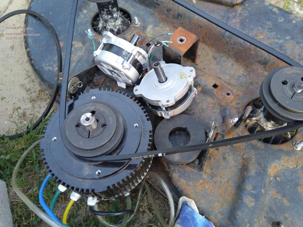

Here is a picture of the mowingdeck under construction.

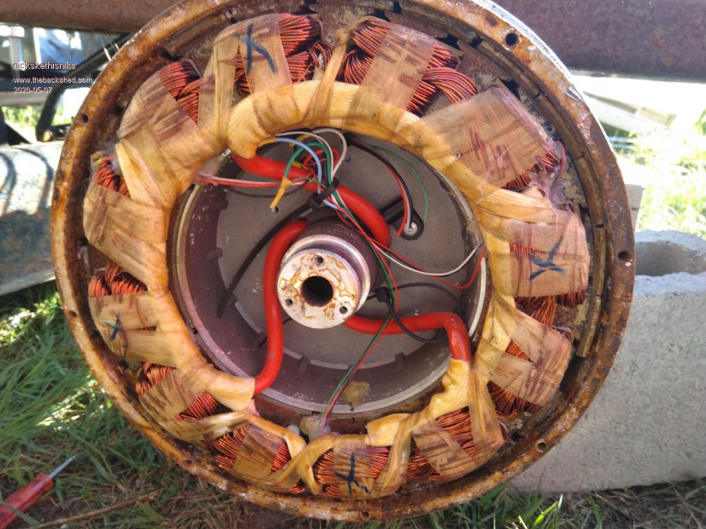

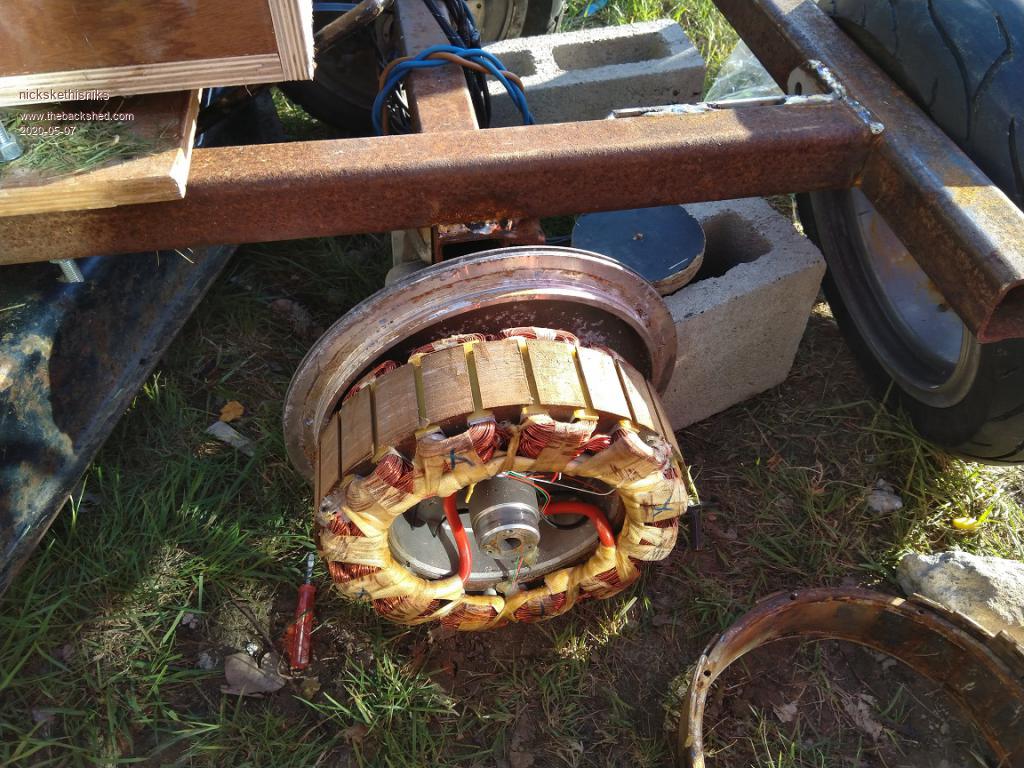

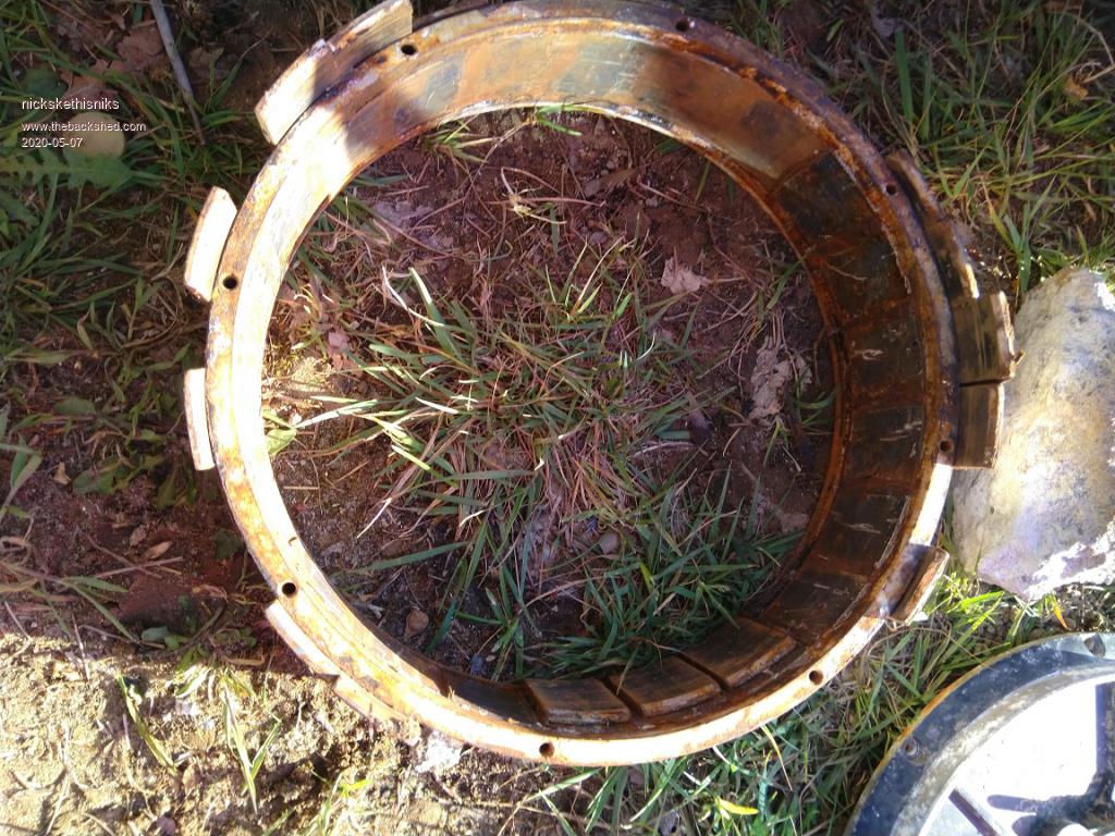

Disaster struck, I was talking about a strange noise in the left wheel previous post, so I discovered there were magnets loose…. 5 of them… And after opening the wheel it was an easy job to loosen all the other magnets….  It’s a mystery how that can, what I did notice was that I didn’t positioned the hall sensors optimal last time.
The controller is acting badly as well, timing is bad, and I think that’s why my controller ran hot after 20min. Thinking about that it’s a wonder I didn’t blow mosfets… I think the current limit is working well. The wheel was not spinning properly, and no load current would be extremely high I guess.

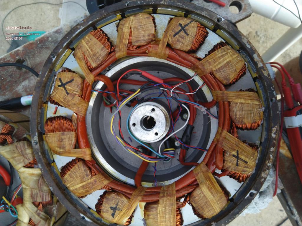

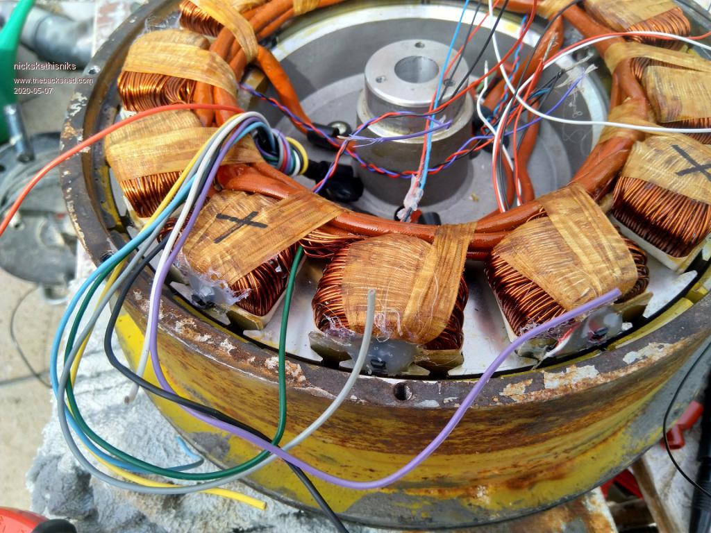

So since it will not be a joy to put the magnets back in I spent a whole afternoon putting hall sensors in another wheel. I have 5 hubmotor wheels like this… But they don’t have the hall sensors in yet, there are, but only 2, I use 3. It’s possible they are cos sin for more accuracy.
I now put 6 sensors in, 3 with the right position in my opinion now, and 3 with the position the other wheel had. That I put in when I first started with my “learning curve”. That way I can learn some things.
Here you can see the loose magnets:
Removing all magnets of the rotor:
Clear view on the stator:

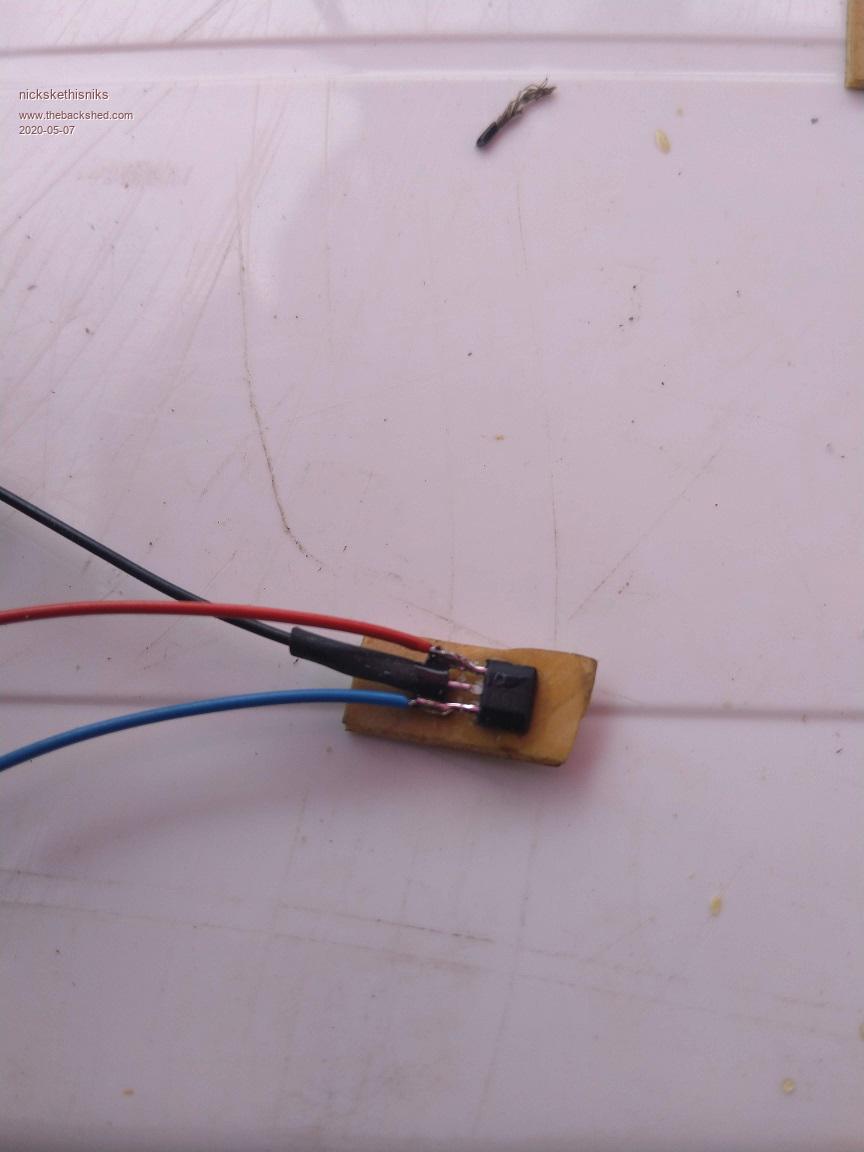

Preparing the hall sensors: (I use TLE4905 )

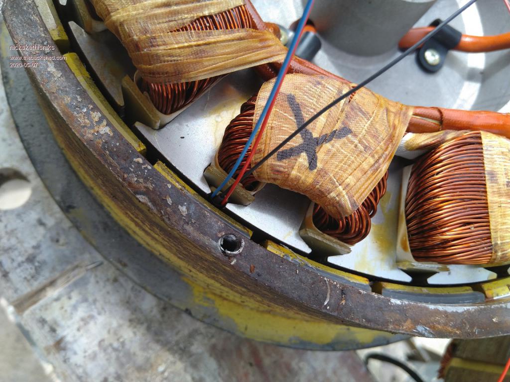

Finding the right position for the hall sensor:
What I think would be better (NOT):
All wired up:

Ok when it was all put back together...
I had fun finding the right phase for the right hall sensor. Especially because I swapped 2 hall sensors in the 2 sets… Turns out, the hall set that I thought were right weren’t so I kept the old position. So the wheels are turning again, both have about the same no load current (+-5A, so +-100W of losses).

Although it’s good it’s not good enough for me, the mowing deck needs some further adjustments, it’s not level. The back of the deck needs a proper mounting system, and not those griptie’s. The front of the deck is hanging on a horizontal M14 threaded rod, on the side there are plates with 4 holes, so there are 4 base heights, Simple.
I’ll need to sleep about it for one night, I must remember to make it interchangeable with my sit lawnmower as well.
