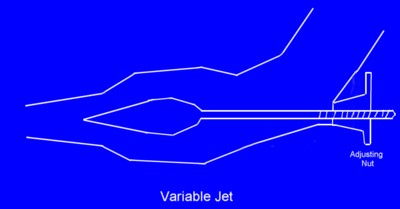

A Hydro has a fixed head, so a fixed pressure. This would be like a wind generator that has an exact [say] 30kmph wind blowing from the exact same direction 24 hours of the day. Wind and solar just don't come anywhere close to these babies and the setup costs are a fraction of the other units with the same peak output. I estimate that on an overall comparison my 30Amp hydro is 15 times better than my 30Amp solar. But I digress.
There are two aspects that require control on a hydro. The first is as Gordon has identified and proposed, a non electrical(power dumping) solution to over charging of the battery.
The second is drop in available flow.
By explaining the situation with flow I'll then explain how I'd modify Gordon's proposal to cover them both.
When flow rates drop, the jet size still allows the max current to flow but the supply to the inlet drops. As a result it sucks in air. This may well self purge under normal max flows but with more air the pressure drops causing flow to become erratic with loud cracks and bursts of air severely stressing the runner and attached generator. This condition can be avoided by fitting a jet size that matches or is less than the input flow.
Like reducing the flow when the battery is full so to a reduced flow can be achieved by reducing the jet size.
If the jet size can be controlled, this can be initiated by either a full battery or reduced flow at the intake.
There are two methods of reducing jet size. The first is as Gordon has suggested ie. multiple jets. the second is an adjustable jet. The industry standard is something like this sketch:
In both cases a method of turning a valve is needed, battery voltage and header dam(intake)levels need monitoring and the data sent to the controller circuit(several hundred meters at least). The circuit then controls the valve turning device.
Whilst it is possible to reduce the flow and it's resultant power out, efficiency drops off and for the reduced flow problem an accompanying winding out of the generator rotor is needed to achieve max efficiency for this new reduced flow. I have no solution to achieving the highest efficiency (a lower but max output) for this reduced flow.
Any takers??
Cheers Gill _Cairns, FNQ
Posted: 05:44am 12 Apr 2008
Hi Gill,
what you have drawn, is a typical metering valve, similar in principle to that used on model glo/diesel engines.
This arrangement does not effectively very the jet size, but just restricts the flow through it. This will result in poor efficiency of the jet and low resultant hydro dynamic efficiency.
I do remember performing tests [the impact of a jet] at Uni. I cannot remember all the specifics, as this was 30 years ago. Perhaps a reader with more recent knowledge can help out.
Perhaps a more useful solution to the flow drying up might be to incorporate a header tank. The same control cct for battery control could incorporate a level sensing element in the header tank. This would also regulate the flow and prevent the entrained air problems. At less than 10% then the user may need to make an adjustment.
I do not see a need for a continuously variable jet. The average power will still be determined by the movement of the total average mass of water.
The rpm is determined by the velocity of the water jet, impacting on the turbine cup/blade. Consider a turbine with 2 jets, one providing 10% maximum power and the other 100%. A sweet spot should be obtained at the upper and lower operating points. The maximum efficiency of the turbine is maintained. The turbine should load more as soon as the battery voltage drops. The power will be fully controlled by the available water and self regulating. The power is related to the mass flow of water at that jet velocity. The system would oscillate between 10% and 100% max power, but this would not be a problem with a battery system. This could extend the time a system operates without user intervention.
Is it possible for a micro hydro operator to see if a system can operate at say 10% water flow with a separate jet without adjusting the rotor... Gordon.

Gordon,
I think I need to differ from your approach in that your system is designed on the premise,
"Would it not be better with a battery system to just reduce the water flow to a level that maintains the generator RPM at a level that maintains battery voltage.", and that can be met by switching to an additional fixed jet of say 10%.
I agree with your query yet I disagree with your method of achieving it. If the battery had no other losses to it's fully charged state than leakage then theoretically a small fixed jet could compensate for this loss. However an RE system is a dynamic beast with varying loads as well as the fixed leakage. A fixed jet will not maintain a stable float voltage without frequent top-ups with the main jet. Why have a small fixed jet at all? Simply turn the main jet on an off in the same manner we do with Bang-Bang shunt regulators. Much simpler as I would have issues with a 10% jet with no accompanying reduction in generator load per RPM as mentioned earlier.
Of special concern with ANY design is that any transition between flow rates be done very slowly to avoid hammering in the line. This causes pipe movement and possibly busting a coupling. Relief devices may be available but best to avoid the problem in the first place.
This is not correct as I understand it. I feel you may not fully grasp the reduction in gen load (by winding out the rotor)to bring the rpm back up to max(gives max amps for that jet size). This may not be such an issue with battery regulation as we have too much power any way, but with reduced water flows it is most important to still get the mostest power out.
For my system maximum amps are obtained at 1012 to 1015 rpm. If the jet is reduced, the gen rotor must be backed off to reduce gen loading and bring the rpm up to the stated level. I suspect that gen testing in a lathe does not identify this issue as the lathe power copes with all settings but a hydro has very fixed power IN, as set by the jet size. This becomes very clear on a hydro yet I find it often difficult to translate this to the opperation of my wind gen. I think this is the resoning of herb NZ's suggestion to Bruce to fit a power in(torque) metering device.
I see a PWM control of a variable jet as the way to go with initial regulation from a header tank water level sensor then further reduction as required from a monitor of battery voltage. Still this can not give max effiency as required with the reduced flow and would be more trouble than the avoidance of manual adjustment is worth.Edited by Gill 2008-04-13

Hi Gill,
When you say you reduce the jet size, are you just adjusting the water flow with a valve in the water input line?
Gordon.

Gordon,
Theoretically, yes; practically,no.
Theoretically:
A valve in the water input line is equal to a resistor(ohms) in an electrical circuit. The Head is the pressure so is equal to EMF(Volts) and the flow in litres per sec is equal to current(Amps). A jet is also a resistor to the flow.
Practically:
A jet serves to concentrate the water(and the power in it onto the runner's cups. A valve at the intake end of the pipe(or anywhere in the pipe) with equal resistance and no jet would not produce a workable result though the theory figures of pressure, flow and resistance would calculate otherwise. It's a bit like a stove heating element and an light bulb, both are resistors but each has a different physical effect. It is the physical effect of the jet bought on by it's resistance that is essential for power transfer to the runner and subsequent gen drive shaft.
Water Power:
I guess by using ohms law the power in the water downstream of the jet could be calculated. Firstly the head pressure must always be maintained and so be the same but the flow and jet can alter. If the available flow is say half then the jet area must then be halved to maintain the head. As a simple man, I use ohms law to then say the water power delivered to the runner is halved. Though it may well not be proportional but follow the dymanics of wind where power is volocity*area^3??
Power In, Power Out:
If I maintain the same head and reduce the jet size, the generator output will drop. If I then wind out the rotor, the generator output will rise significantly. It will of course never rise to to near the original output.
Let me give some ball park figures for those number-crunchers.
IN_initial:-
Head = 58 meters, Flow = 2 litres sec??, Jet = 95mm^.
Out_initial:-
Volts = 14v, Amps = 32Amps
In_reduced flow:-
Head = 58 meters, Flow = less?? , Jet = 34 mm^.
Out_reduced flow(rotor unchanged):-
Volts = 14v, Amps = 12amps.
Out_reduced flow(rotor backed off to peak Amps)
Volts = 14v, Amps = 18amps.
I hope my rather practical approach has sufficient info to relate the normal hydro setup and the physics they satisfy. Unfortunately I've just this week run out of water so my wet season is over for the year. Hope the wind picks up.......Edited by Gill 2008-04-14
