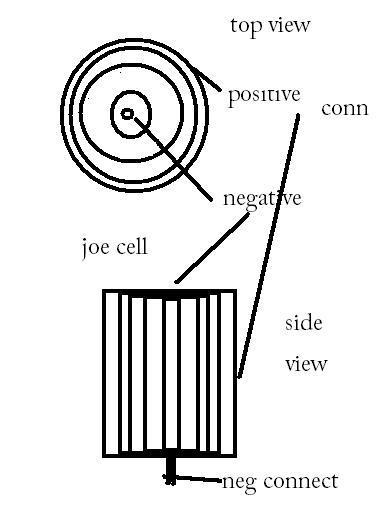

yes cnc pro plates do corode i think the negative erodes whilst the positive builds up thats due to the transfer ions affect, but the general guide is the thinner the plates the better the production of gas, the joe cell uses 5 or 6 concentric rings of stainless steel assembled together as one cylinder and spaced apart by rubber spaces one solid s/s bolt through the center as a negative the positive on the external ring.
sory about the drawing
the steel must be 316 stainless about 2 mm thick, and the unit must be seeded through 4 stages.
the water / soda was about 3 table spoons to a liter but the best way is to see the amps drawn with clean water then add soda slowly as the amps rise quickly with a electrolite, you want to use as less amps as posible for max output of gas try to find the best combo but it varies depending on salts etc in the water suply, i usualy start with distilled water as bottled water contains salts.

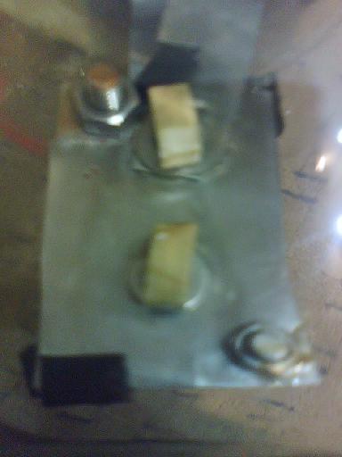

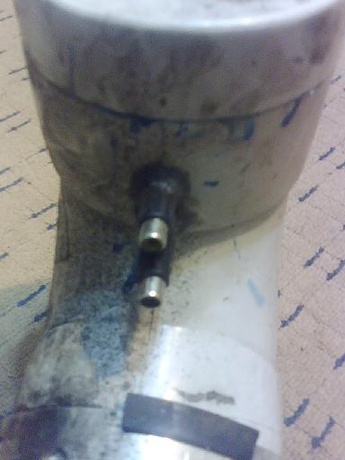

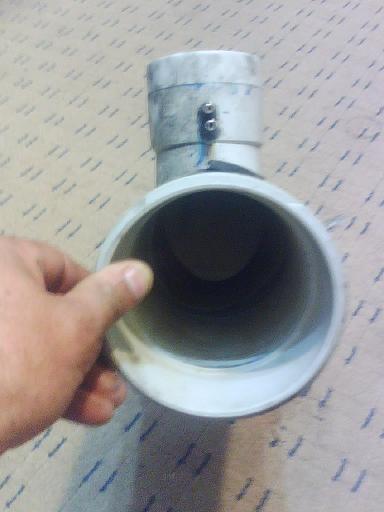

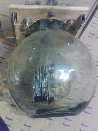

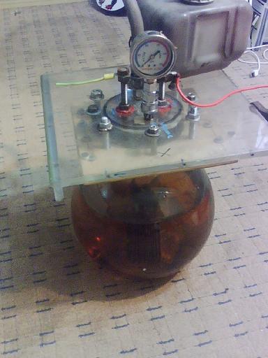

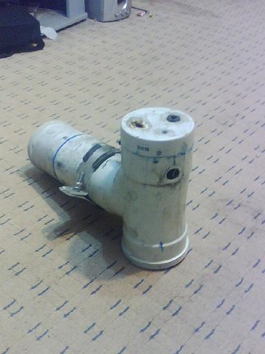

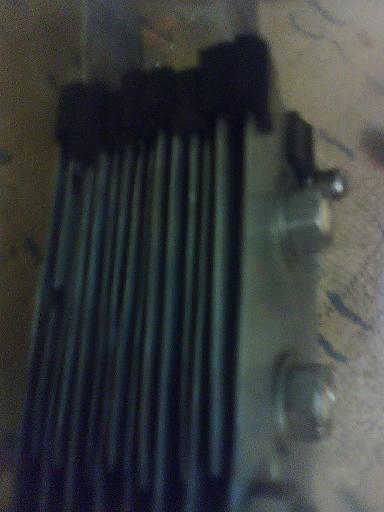

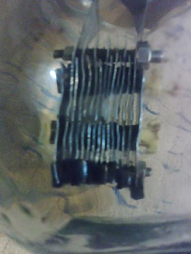

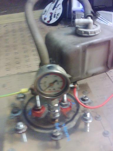

here is some pics of the old unit and test setup
this is the cell i will remove tomorow for a better pic
and the old unit i used in the pajero
the jacks in the side was for a water level sensor
thanks for the interest
