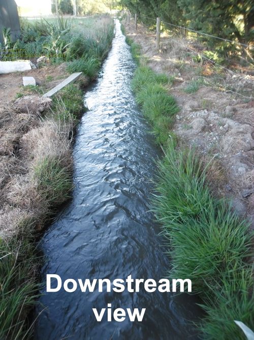

Hi, I'm looking at building a ram pump and I'm after some guidance please. On my land I have a small water race that is about 300 meters longs with a rough fall of about 3 meters (1 in 100 meters). There is minimal options to dam is as there is not much bank.
There is about 20 liters/second flow.

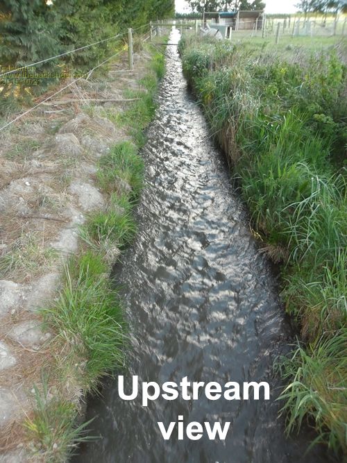

In fact you can see the 'left over Wirtz Pump' in the upstream view photo!!!

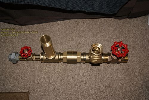

Further questions. I see that there are different layout designs online for ram pumps. Some show the check valve and pressure vessel after/beyond the swing check waste valve:
Others show the waste valve beyond the check valve:
Is one option better/more efficient than the other?

Posted: 11:54am 21 Oct 2015
Not really, both work just as well. I myself prefer the top version where the check valve is on the same line as the feed pipe, one less corner for the water to turn during the high pressure pulse stage.
You'll have fun with this. Building and tuning a ram is a bit like fixing and tuning a old motorbike, you can make little adjustments, learn the different noises they make, and really appreciate a old technology.

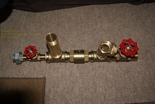

Thanks for your help. I have got most of the necessary components together, and have a couple of (maybe dumb) questions:
1: when putting fittings together and you need the all to sit vertically, how do you do this when some want to tighten beyond vertical, even 'upside down'?
2. The waste swing valve. What orientation should this sit at? In line with the pump or at 90 degrees to it?
I am still waiting on the mac union for the intake side of the pump. On back order!!
Then just build my pressure tank and supply and then the testing (AKA FUN) begins

Posted: 06:39pm 23 Oct 2015
1. Lots of thread tape. Lets you under/over tighten a bit. Or, use silicon, tighten till vertical and let the silicon set.
2. Doesn't matter, it will work either way, but you can play around with it later to get the best results.
Those cast iron unions can be a bugger, they rust and seize in my experience. Use a bit of thread tape in the thread so it doesn't rust together.

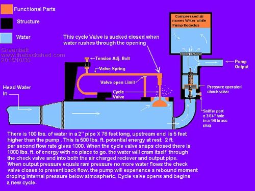

I Made up a drawing long time ago and posted on this web site, searching does not find it. Glen has had Storm damage/Power failure when he lived up north and some data was lost. I'M posting it Here as a guide to understanding how the Ram pump works.
almost any design will work if the main features are present.Sorry about the blurred Text.I Had to shrink it to Upload.
Note; The sniffer port is a small hole to ensure that the receiver maintains an air cushion. ----------Cheers, Roe
EDIT; An error exists in the drawing text,The 100 pounds of water in the feed pipe will have a value of 250 pounds Foot when averaged from zero height to five foot.
or a little less. resulting force, 250 times two ft. second = 500 lb force. this post is for illustration and does not represent an engineered system ----------Cheers,--- Roe. End Edit.
