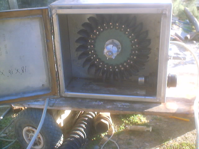

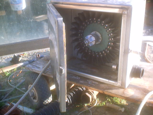

Re my set up I have Three hydro's and even then change to other units when like now we are in a drought,
Smart drives when plenty water and the older gentle annies when i have to get efficient.
I also manufacture units for neighbours etc a sort hobby business. I will include some photos of units.

Sorry about confusion yes its a pelton I call it a Pelton wheel I get blank looks if I say runner. Cups are ones eco produces. He used to source from states identical but heavier cups.
If your current decreases when winding rotor out it means you need to generate at a lower speed increase the turns/pole or in your case caps would do the trick your 7 phase so need one across each winding get old fluor ones .If this does not help try connecting them in star.
I have 120 metres head on two units 100 metres on other.
at present in our drought I have about <.2 L/sec the two gentle Annie units running that use a cup i build myself are giving 7 & 4 amps @ 24 volts.
I do admire the Water wheel of yours it must get lots of admirers . If you could possiblely get about 0.5 Metre head think about a banki or cross flow i have full designs here they are muvh more efficient if not so pretty
