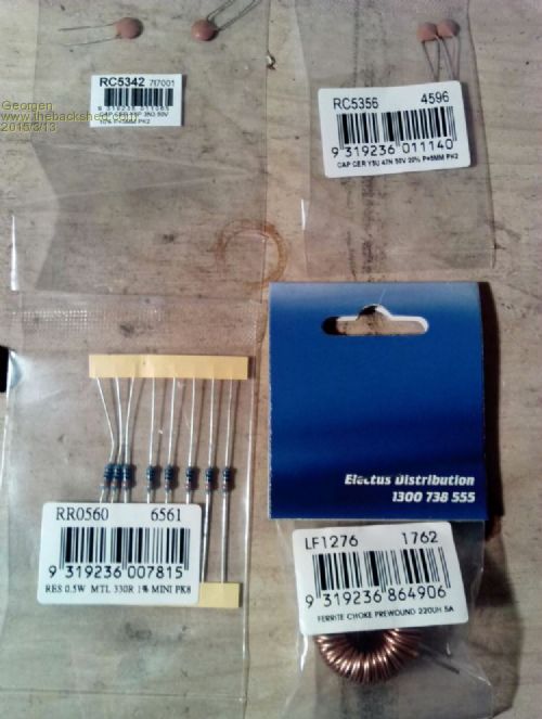

C2 instead of 0.22 uF got 33,000 pF 50V - is it close enough?

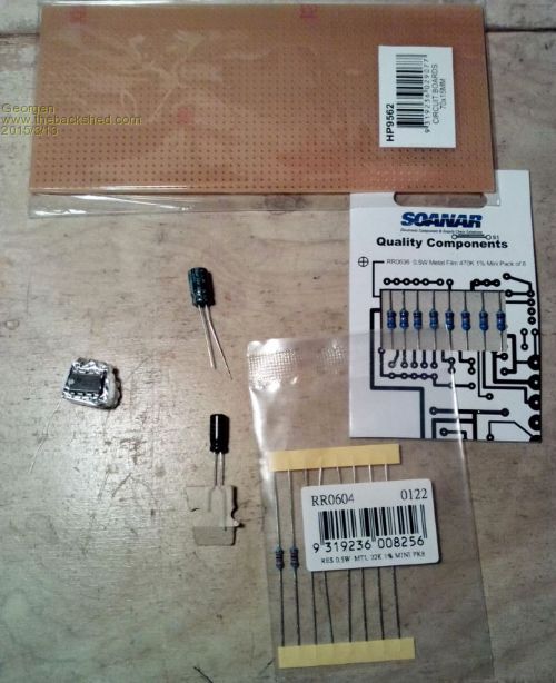

Made 2 pictures of parts

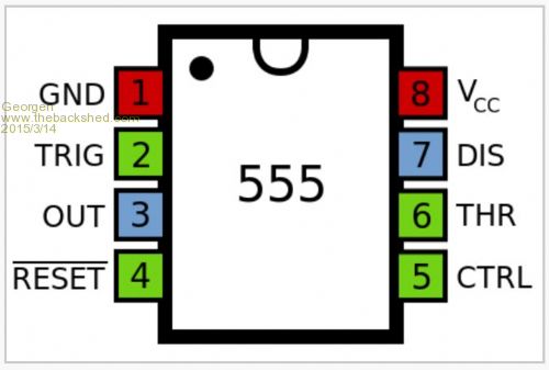

Just in case I will place reminder myself here, for reference when I will have all components to build Desulphator:
From :
http://en.wikipedia.org/wiki/555_timer_IC

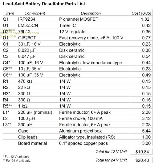

From this page, copy of the parts' list:
http://www.thebackshed.com/forum/uploads/VK4AYQ/2015-03-11_142512_desulfator.pdf

RS Components has your FET $4-95. There is no such thing as a 30uF capacitor. Well, you could have one custom made :-) But it's just a de-coupling cap. Electro' caps typically have a tolerance of about 20% 33uF will be fine. In fact you could use anything above that value (within reason, 220uf, 470uf) all will work fine. The article you link at the beginning shows an error in the value of C2. .0022uF is the same as 2.2nF which is also the same as 2200pF (Yep, just move the dot) Might want to get that one close as it's part of the timing cycle. Also check RS Components for the choke. 1000uH is the same as 1mH. Soanarplus is also a good components supplier. I use both and are both well worth a look.

Forgot to mention that C2 is 0.0022uF
and checked, JayCar has them, not sure why I was given 3300pF instead of 2200 (?)
(in post above I wrote by mistake 33,000pF , sorry , cannot change it now)

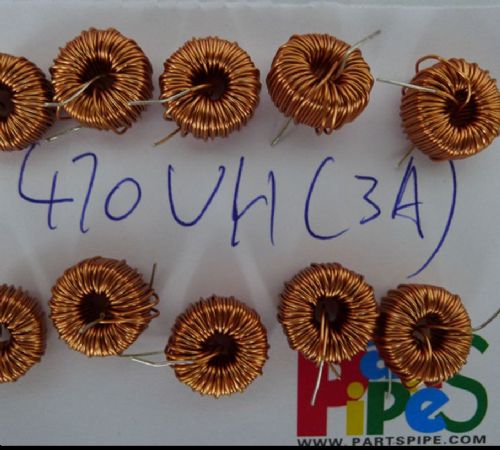

The 470 will work OK just a bit down in power, what you could do is wind some extra turns on 470 to get the inductance up a bit, all good fun. I think someone suggested two in series, but you would have to watch the phasing or one could cancel out the other. A few meters of extra wire wound on may be the easiest.
This is the one I am going to use
http://www.ebay.com.au/itm/140991936000?_trksid=p2060353.m2749.l2649&ssPageName=STRK%3AMEBIDX%3AIT

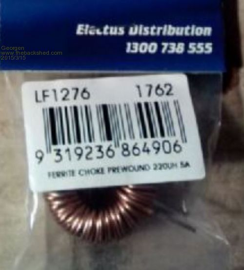

20pcs Inductor 1000uH Choke Approximately AU $6.54
Jacar Cat No…LF1267…220uF 6amp Ferrite Choke……$4.95
What fast diode did you get?
PS I used 2 by 470 uH Jacar chokes in series in my first units and 1 of the above in the other. Audio output is very similar.
Always Thinking
Georgen
Joined: 13/09/2011
Posts: 462
Posted: 12:42pm 15 Mar 2015
Rustyrod,
Ive got 'LF1276 already from JayCar
