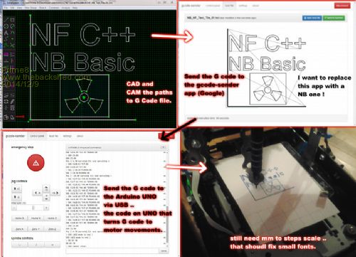

eventually the G code sender app( PC side ) and the sketch on the UNO .
I my try one of the open source G code interpreters for Arduino .
I'll edit more info on here later.

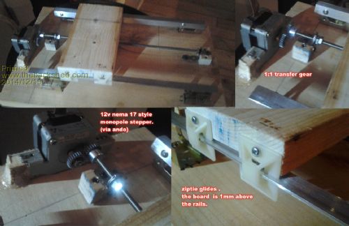

lol . the first printer I ever had at home ( i would love for the parts rite now ) was a noisy dot matrix thing on my vic20 .
the larger bed and a few other zip ties has mad eteh thing more rigid so it is working better .

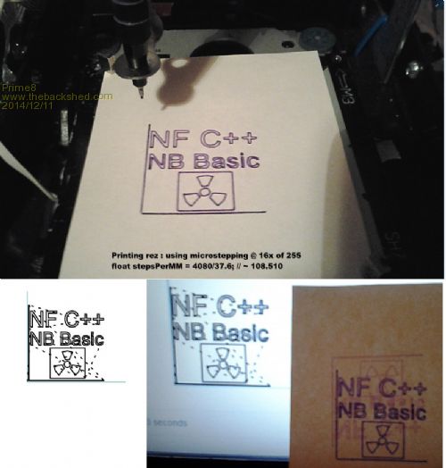

i have found that i get 255 steps in single mode and 255*16 steps in micro-stepping .
micro stepping is a bit slower . lol.
also the motor controller shield I use is I2C ~ set to run at 400khz.
I hope to edit the sketch to allow for steps per mm .
then I will support both stepping modes , using custom commands .
as it is now you can send a Q_ code to change step modes .
and the steps per mm seem to be working but I ran out of time tonight to fine tune the true values of steps/mm for both modes.
my measurements must be off for single step , as when i put in value for full X travel less 1 step it went well past by about 4 steps
but the micro-step mode , is 4080 steps for x and y . would be nice if i had a burning laser, as the plot is very smooth . heheh .
I have a few CDRW diodes , but no driver for them .
I think the error may be that I have to mix integer steps with float values, but I'll know more later .

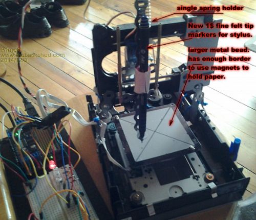

franken plotter is stiffer and more square ( still all temporarily tied and bolted ).
the non micro-stepped movements seem to cause fonts and small things to get wrong. so I have to look at what could be causing that . Its not losing steps , and it still homes and moves to exact coords fine . could just be a resolution limit .
this would be sick with a engraving / cutting laser!

lol yeah , love re-purposing old printers . + i can better sort the parts at the disposal / dump recycle stations .

i wonder about the ziptie glides and the use of wood , because iam think this isnt a good solution.
maybe it works some time but i think some ballbearings and a V shaped rail are much better.

yeah a v rail is way better , especially if the rig has to hold a bunch of mass.
i could also use brass bushings or DELRINŽ if i could find my scraps.
I have roller bearing rails but i need my beefier drivers to start that rig.

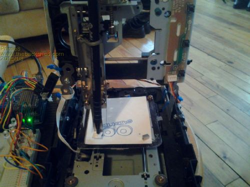

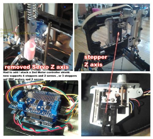

ok most of the soldering is done .
i now have 3 steppers working . I used the smaller one from a floppy drive. ( one form ando )
With the rig as it is have room / driver space for :
2 servos
2 DC motors or 1 more stepper
the focal point of the laser can be adjusted for by using a fine stepper on Z axis.
i need to make a mount point and JB weld it to the old read head mount / sled.
I have been using old IDE cable and the end to make it so it all uses bread board jumpers for now.
I have found i can speed up the rig even when micro stepping is in use.
via code i can set micro stepping values.
I hope to use a small R/C brushless motor on the servo port 2, as it has crazy torque and can hit crazy high RPM with very good speed control via PWM and the ESC.
The ESC has a BEC the has a rock solid 5V out , so i could run the logic and all from one of my big battery packs if I chose. ( portable rig )
rite now it is set so that all Z axis movements have to happen before any XY deltas. I hope to sort out a 3D line algo that will work as I want .
any how very fun .

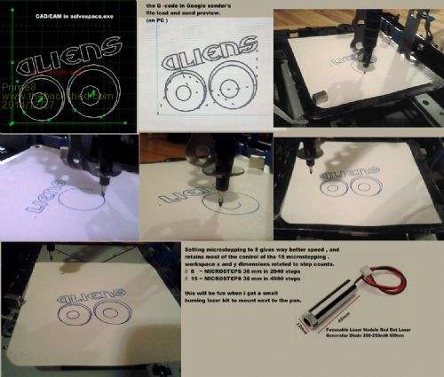

Prime_8
Joined: 07/12/2014
Posts: 51
Posted: 06:20am 08 Jan 2015
will do , seems the site here shrinks the pics ?
ah well i'll post em some place else and link for higher rez .
most places you can right click and open in new tab to see at full rez?
I did a video this am but all i had available was my cell cam
pic test no water mark . to see if the water marker is re-sizing images.
I'll up load the video to you tube in a few min .
ignore the 3 led's they are not hooked up yet , nor is the 3 tac buttons .
I need my female headers for the top motor shield to put them back on .
when i get my good camera charged up and running again i will get soem better macro shots and video .
My tablet is pretty good too but needs daylight or flood lights almost to get nice video .

Prime_8
Joined: 07/12/2014
Posts: 51
Posted: 07:57am 08 Jan 2015
hmm seems the link to the big pic died.
here it is , but these forums will shrink it .
here it is running , no edits for time , just 1:1 speed at just 8x micro stepping .

http://youtu.be/-xaNdzn2P_o
sorry all i had was my cell and it was early so its a bit blurry .
I send G code to mu rig with this chrome app , for now. I will have my own one built soon .
chrome G code sender app ( free ) Edited by Prime_8 2015-01-09
