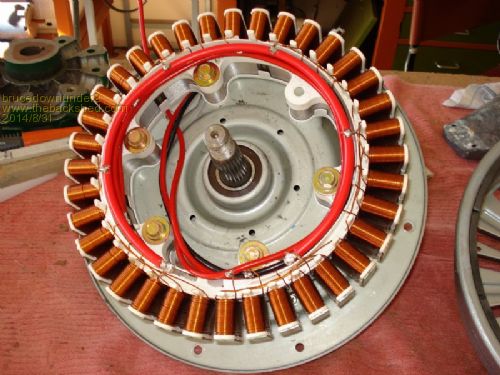

i recently acquired an lg top loader and removed the smart drive assembly.i've had a look over the forums,and found a little bit about these. has anyone got any suggestions for rewiring for a hydro turbine for 48v? i suspect, looking at the rotor a higher rpm than and f&P can be sustained safely.

Anyhow, Yep, I have some LG stators and rotors , they certainly look stronger than F&P . the windings-- I'll have a look ,one of mine is wired for 48volts, I'm sure --someone else gifted it to me long time ago -chime in if you are the "gifter"..
The pressed steel housing ,solid shaft, big bearings and completly removal stator ring could be a real advantage. Not much work has been done on these, people have moved on a bit ,I feel from F&P, Etc ,gone over to axial flux turbines and the Exmork types...
