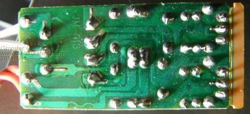

Lovely design out of China:
The RED wires are 230v AC input.
Note how the tracks for the mains come along the PCB, and are within 0.5mm of each other - lovely design!
The track just below and to the right of the mains connections, is the rectified AC, sitting at about 325v DC - about 0.7mm from the phase connection of the incoming AC......
Nasty, nasty, nasty.
Even when I design 24v AC stuff, I put the AC traces from the tranny at least 5mm apart, and that is at 24v - this is a 230v thing.
It has been "Decommissioned" - I will replace with a standard isolated tranny.

I like the PCB fuse on the track near the bottom edge.

I've seen a few power supplies like this, and I do the same, decommision them to the junk pile. If it belonged to a customer or friend, I would refuse to repair it and explain why. This sort of circuit layout is technically illegal in Australia and should not be imported.

[Quote=Gizmo]I've seen a few power supplies like this, and I do the same, decommision them to the junk pile. If it belonged to a customer or friend, I would refuse to repair it and explain why. This sort of circuit layout is technically illegal in Australia and should not be imported.
Whole heartedly agree. I don't know what voltage they use in China, but perhaps it is just a case of not caring over there, if it goes bang? Not sure what kind of electrical safety regulations are in place there.
You can get away with layouts like this for low-voltage, as everyone knows, but by the same token, you should know that you CAN'T do this kind of layout with high voltage.
