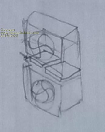

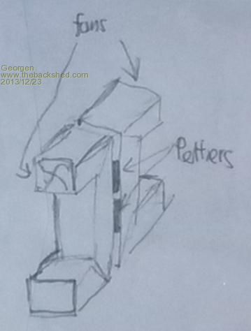

Now have to design some kind of arrangement that will take air from outside to push across hot side to be back outside.
Fan on cold side will move inside air past cold side.
It will kind of work as micro-mini AC.
Will probably get one rectangular plastic downpipe from Bunnings and few corner pieces, or just cut and glue it to get desired shapes.
Have to put pencil to paper to draw what I have in mind.
George

Posted: 12:02pm 23 Dec 2013
Rough concept
George
Posted: 12:12pm 23 Dec 2013
Sounds like a plan George. Don't expect too much from it, it takes a lot of watts to heat/cool a room, especially if its not well insulated.
The Peltier devices don't like sudden changes in temp, it causes the junctions to fail, so make sure you have some mass attached to each side, and don't cycle them off and on to quickly.
