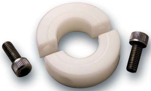

I don't like your chances of rolling the rim very far, it's likely to split. You could fit a two piece collar/clamp, there should be enough flare on the rim to hold something provided it is machined for a tight fit.
