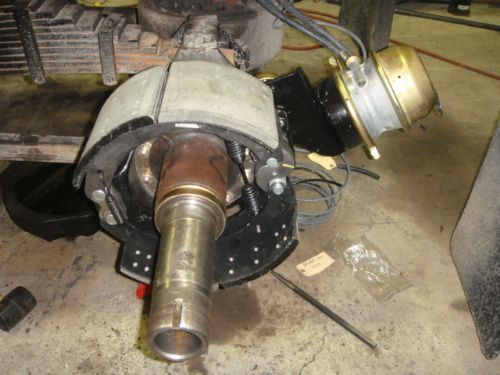

It is still pretty rare to see spring brakes on a trailer. Most of the ones I see are just the plain ol single diaphragm brakes. If the trailer air tank is empty the brakes are off.
If the red air supply hose is cut then a relay valve is triggered and the air pressure in the tank is used to apply the trailer brakes. It fools a lot of truckies because the trailer brakes are on as they start their truck in the morning and they have to wait for the pressure to get up before they will release.
spring brakes or double chamber, double diaphragm or maxi's are usually only on the drive axles on the prime mover.
The black chamber in this photo of a drive axle is the service brakes and the nickle plated chamber on the top is the chamber with the big spring in it. If you look closely there is a small bolt attached to the housing between the chambers, this is a manual release tool. If the diaphragm ruptures in the spring chamber then the bolt is fitted in the top and the spring is compressed by hand so the truck can be moved.
Posted: 02:46pm 11 Feb 2013
  Quote   this is a manual release tool. If the diaphragm ruptures in the spring chamber then the bolt is fitted in the top and the spring is compressed by hand so the truck can be moved.
Also very important to install the bolt when disassembling the Maxi for repairs or diaphragm replacement, or the spring will likely take your head off if not restrained when the retaining clamp is removed.Edited by Downwind 2013-02-13

I think spring brake chambers are more common than people think. I looked at the trailers at work today, 2 20-ton plant/8 4-ton pig/ 3 8-ton dog/ and 9 30000l bulkfuel tanker trailers. All had spring brake chambers.
Mind you (in another life), we had a tilt bed trailer roll down a hill in the mid/late 80s, this was in the middle of the night. No spring brakes on it, just air operated. By memory these trailers were modified with spring/maxis by 1990, did some of them myself, lots of fun in the bush.
All trailers purchased since then were fitted with maxi brakes on at least one axle. Would need to check the regs to see if all axles are now fitted with them, no longer on the tools (ahhh office hands).
