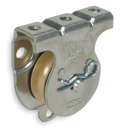

The best way to coil tube is to build a 3 wheel roller. I have one for making wheat silo base rings. I put pressure on the centre roller with a hydraulic ram and also drive the centre roller with a geared hydromotor.
The trick for getting a good coil is to find/make/bodge a pulley profile that will support the sides of the tube as it is stretched to avoid kinks.
.o5" wall thickness should resist kinking better than the thinner stuff.
The idea is to run it back and forth a number of times and work up to the curve you need. You may need to install smaller diameter centre die to finish the coil as things get pretty tight towards the finish.

A rope sheave like this in 1/4" should only be a couple of $

  yahoo2 said   A rope sheave like this in 1/4" should only be a couple of $
Hey Yahoo, do you have a link to the makers or suppliers of this sheave .

  fillm said   do you have a link to the makers or suppliers of this sheave .
Sorry no, I can tell you it is made by National Mfg Co probably called a wall mount or ceiling mount pulley and usually it is a 3/8" width nickel sheave.
It SHOULD cost about $8 and the replacement sheave $1.50
other brands I have seen are battalion and campbell.
They are not generally sold by brand, every large chain store will have their own stock codes and they are lumped in with swivels, eye hooks and snap hooks (and usually out of stock ).
