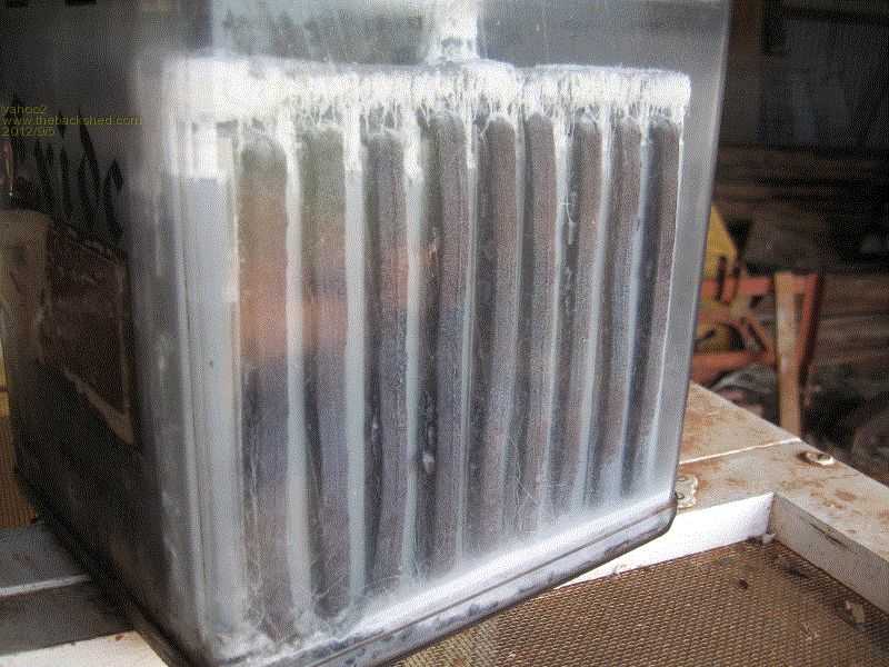

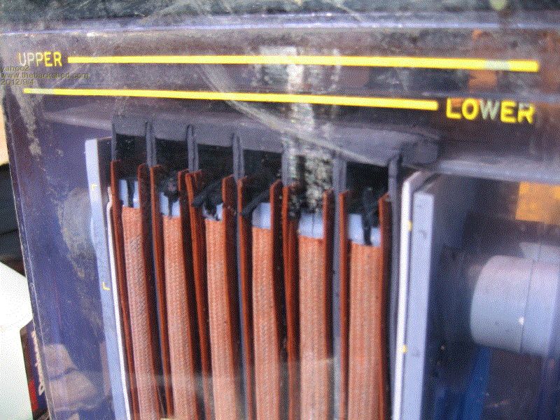

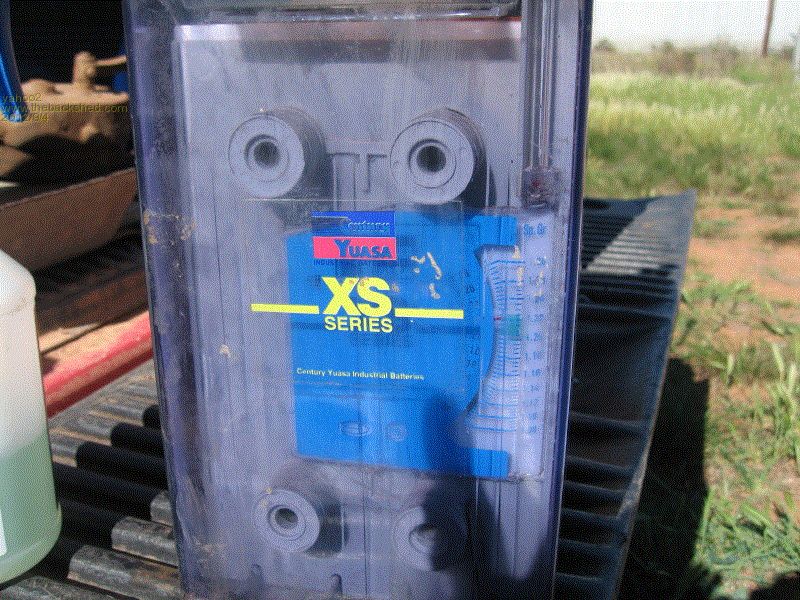

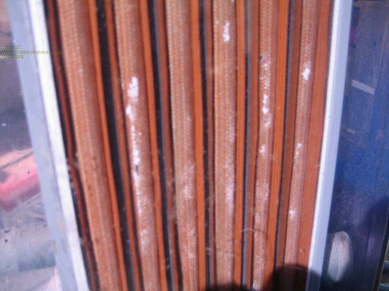

This first one is a battery originally designed for backup power. It is kept fully charged for months on end waiting for that one day when it is needed. The first thing you notice is the massive amount of fluid that it holds in relation to the area of the plates. reason???it's able to use a lower acid concentration to reduce oxidisation (essentially rust) but still have enough acid to carry out the reaction. made for low power delivery over extended periods of time. Checking the specific gravity shows a charged level of 1.225 - 1.230. This is close to what I would expect for this use. There is a specific gravity meter (broken)and thermometer built into the case, handy for quickly looking for a fault
The positive plate on these will be a lead grid that is packed with PbO2 (lead dioxide and lots of other goodies) that is held in place with plastic spacers and porous fiberglass wraps. This is designed to let the acid flow through and complete the reaction, leave room for the bulkier and less densely packed lead sulphate to form and to stop the lead dioxide from shedding away from the positive plate and falling out of the grid into the bottom of the battery. You can only see the negative parallel electrode connectors in this photo, both it and the positive one are in good nick, they are massively built, not like a car battery that is just a few MM thick.

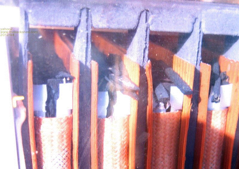

Looking at the positive plate here I can see a number of things. The tops of the grids are splintering and the plastic compression/separator plates have split, none of the dark black material is electrically connected to the plate anymore so it is basically sitting in acid with bubbles of oxygen flowing up past it, it has lost its dark grey lead look and gone black because it is badly rusted.
The white areas on the fibreglass woven fabric are where it has been stretched and torn from a massive buildup of Pbso4 expanding throughout the positive grids. At some stage these batteries have been kept in an undercharged or uncharged state for a long period of time and the harder crystalline structure has put a lot of pressure on the layers that hold the plate together.

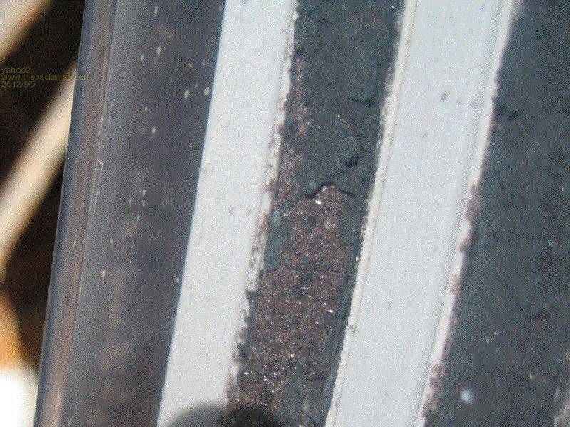

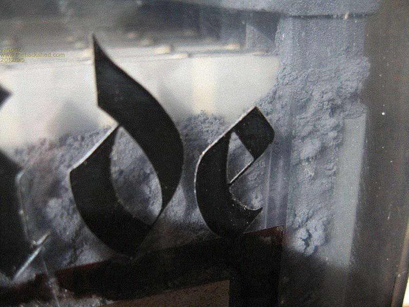

Considering their age, these batteries are surprisingly clean in the bottom, I have seen them with muck right up to the bottom of the plates, shorting them out. The light grey colour is a layer of lead silt from degradation at the negative plate, I don't understand how, over time atoms of lead are detached from the plate, I doubt it is a water contamination issue (calcium, etc) just old age. The bits that look like burnt matchsticks are from the top of the positive plates.Edited by yahoo2 2012-09-05

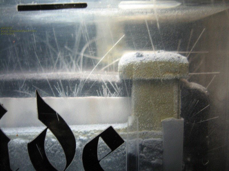

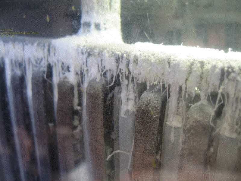

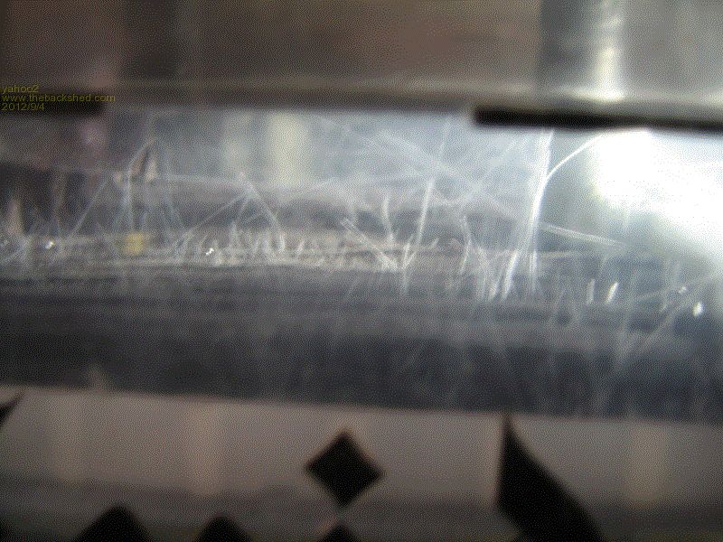

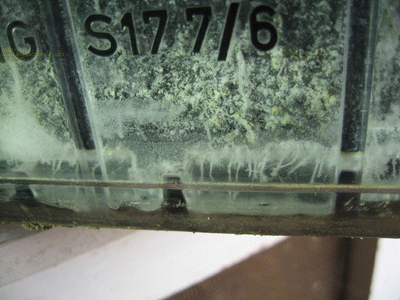

These two photos were tough to get. What we see here is lead sulphate growing as a crystal strand. Unusual to see it so clearly on a solid lead plate and to this length, way better than I hoped for. This is considered to be the good form of PbSO4 structure, very easy to recombine and react.
Notice how big the positive plate is here, it is supposed to be below the level of the white separator (same level as the negative in front of it) it has been expanded more than 4 centimeters and is almost pushed into the large bar joining all the negative plates. In this battery the yellow on the negative electrode is a sulphur byproduct and the dark brown colour just to the right of it on the positive plate is not "red lead", it is a mild oxidation (bit hard to see, I will get a better shot later).Edited by yahoo2 2012-09-05

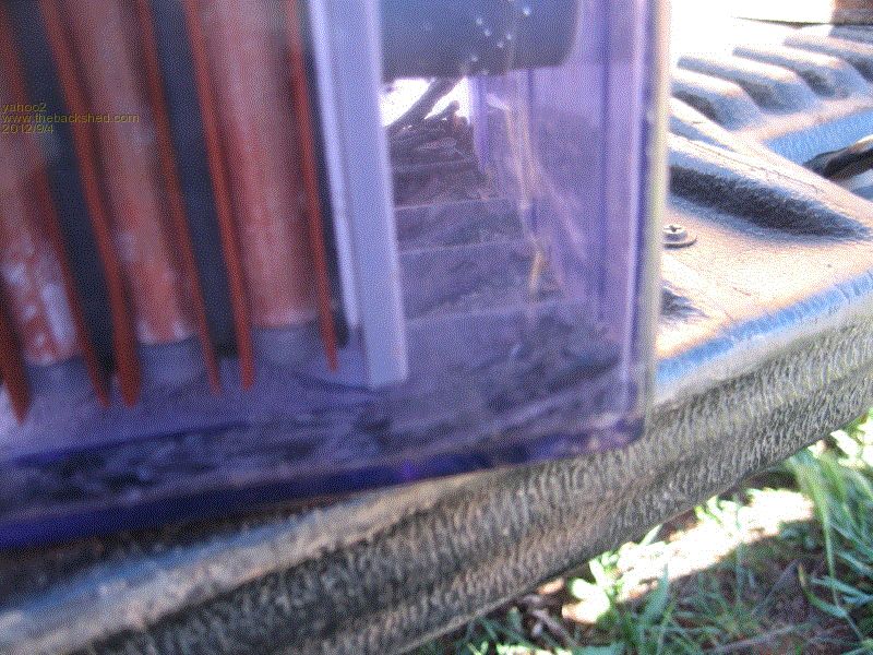

This one is interesting, it is some recent rusting probably due to low water levels exposing the tops of the plates. If you look closely, there is hard crystals growing in the surface of the freshly exposed metal.
Negative plate sponge lead, nuf said!

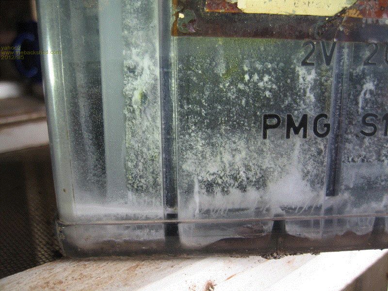

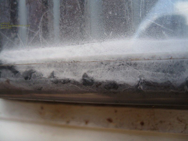

Right, this one is unusual, it is from two banks of six in series with a couple of cells that were badly gassing from low resistance across some plates. This cell was alongside one of the faulty ones and it looks like it has discharged in reverse.
That is actually the negative electrode and plates that is growing lead sulphate.
Three forms of sulphate here, the patch on the left looks like a furry mould, there are tendrils of what looks like fluffy strings of cotton hanging from the plates bottom edge and blobs and pimples stuck to the face of the plate.
Wide shot
Thin layer of PbSO4 formed due to stratification of the acid probably grown on the top of a layer of water or very dilute acid. The bright white layer is very dense and the area underneath is starting to crowd with material like the roots of a plant in a pot.

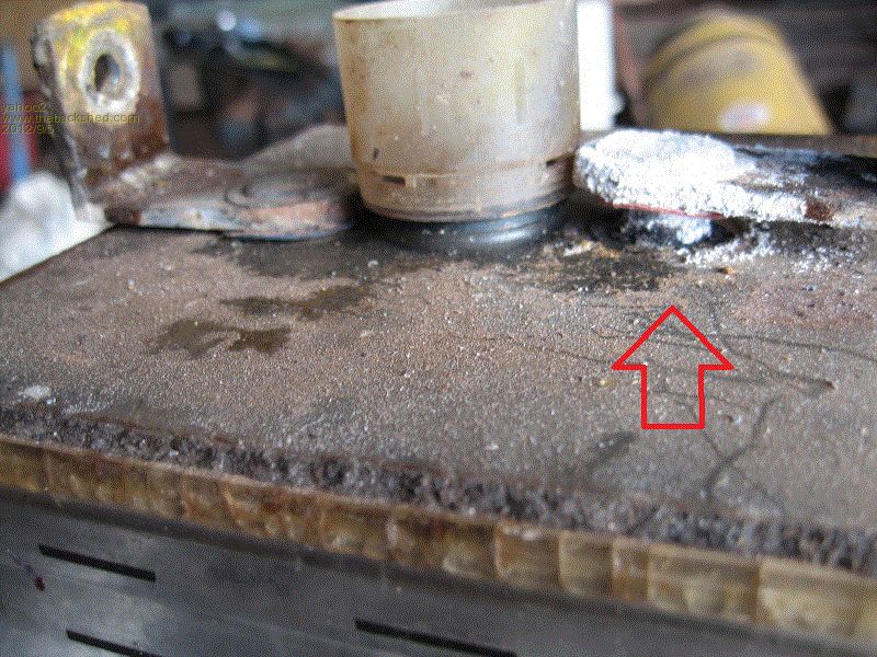

When I look at a battery bank for the first time, this is one of the things I look for.
Lifting around the positive terminal. Normally have to look very closely and compare it with the negative terminal to see a difference.
