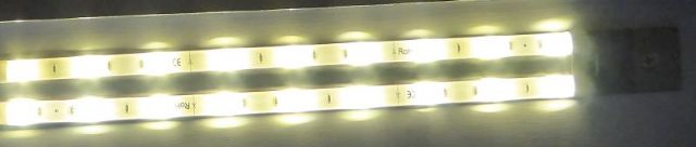

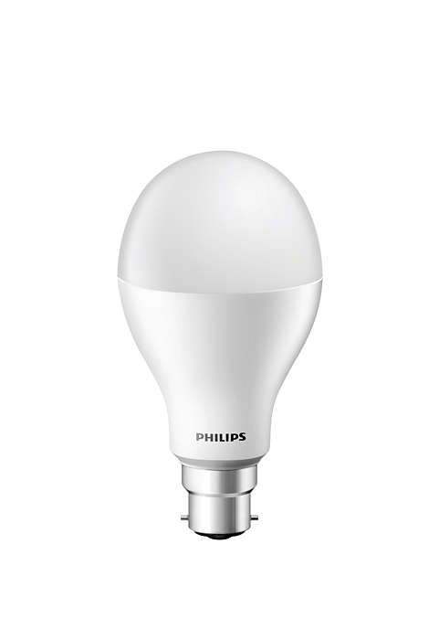

tried a philips LED bulb in a mechanics shed a few months ago. looking at the quality of the light compared to the next bay with top of the range bare fluro's we think it is doing a better job.
its an 18w cool daylight LED rated 2000 lumens (plain ol B22 bayonet fitting). the combo of 6500K temperature and frosted cover makes a difference. we are still losing some light on the roof so for the next try we will dig up some conical light shades and try pairs of 12 watters perhaps.
the 5050 LED's in the led strip are way better than the other versions for light output.

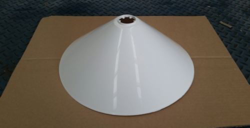

Great update, thank you! I am however a bit confused as to what you meant by "conical light shades", when the first image you shared in your post looks like, for all intents and purposes, a conical light shade. Or was that the one you are saying you wish to get? I understood it as, that you already used them in the mechanic's shed

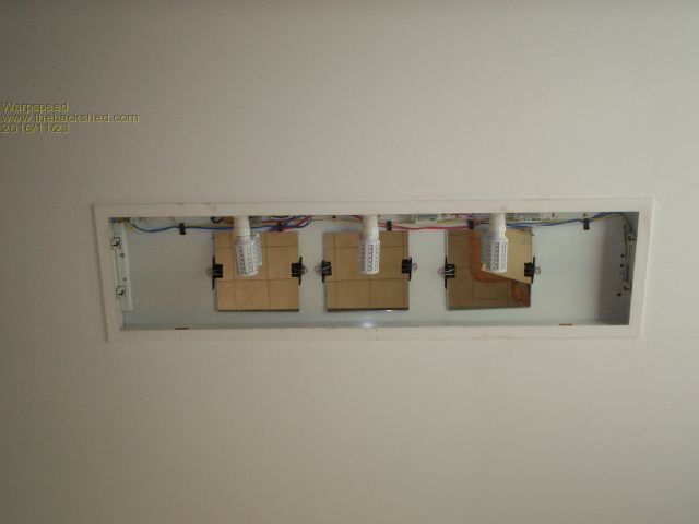

I originally had a dual fluro fitting recessed into the fairly low ceiling of a sun room. I ripped out the fluro tubes and fitted three ordinary bayonet LED light bulbs.
It became 3 x 18 LED watts versus 2 x 36 fluro watts.
It worked very well, the light output noticeably increased even further after I also fitted three mirror tiles.
Just another "what if" idea that worked better than expected.
As you can see, I cut six slots with a small angle grinder, and used bulldog clips to hold the mirrors in position. Highly recommended...
I can also fit either one, two, or three bulbs as desired.
We just put up the bare bulb to try it, but it still spills some light upwards onto the grey galvanised iron, its a lot better than an old incandescent bulb.
Unfortunately there is no "pop down to the shops" option where I live, making stuff happen usually involves ordering gear and waiting 3 weeks for freight or improvising with what we have. I am quite busy at the moment and this is a very low priority on my list of jobs, so it will have to wait.
