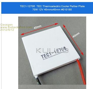

I have question about Thermoelectric Cooler
Found one on E-Bay
(Not sure if I should include page address as after so many days link will not work anyway)
My questions are:
1. Is it OK just to touch it to metal surface or thermal paste is a must
(suspect paste is essential)
2. Where would be the best place to get paste, and is it OK to buy some more or it ages quickly and I should have enough paste just for this job?)
3. Can I just connect it to 12V battery, or some other components are necessary to limit current?

1. Yes, I used the white paste that's sold for semiconductor heatsinks.
2. Any place that sells semiconductors usually has the paste
3. Yes, but its a better idea to use some thermostatic control.
These devices have a limit of the temperature difference between the cool & hot side.
I take it you know how to use these Peltier devices? One side gets hot as the other gets cool, so you need a BIG heatsink to carry that heat away. Use the biggest one you can lay your hands on. Also, the cool side is best located inside a well insulated box with the heatsink (plus fan) on the outside.
Be *very* careful with the attached leads, their bonding to the Peltier junction is not very strong mechanically. I actually managed to break a lead off (quite easy ) and carefully soldered it back but that process shorted a few junctions out.
