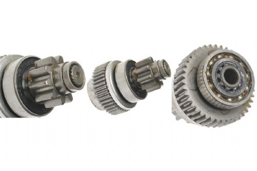

I am looking to design something that is elegant, compact and removable. Thoughts of right angle reduction boxes and planetary gears....hmmm
I have been trying to avoid modifying the pinion, I should just build one like Tinkers with less reduction and get it working. Fishing is ultra high priority, fancy engineering can wait till I get some inspiration. and tasty whiting!

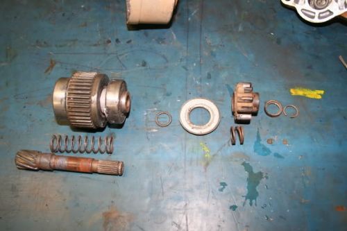

That is the reason I was going with the landcruiser starter motor Tony, what you are looking at is identical to that but with a custom casting, the 2.5 Kw reduction starter has been very popular for the old big block Chevy's for years.
Denso have been making that reduction starter for some time now it is very reliable and has heaps of grunt and is an off the shelf replacement part for every cruiser model right back to the sixties.
Don't quote me on this but I think they make a version that will take an end plate adapter so that the Denso starter can be fitted to some really oddball motors.
The only downside is the imitation starters are flooding the market now and they are hard to pick from the original, as usual the quality is poor.
Its funny, this all started with someone asking me if it was possible to build an electric crank handle for old cars and stationary motors, I thought it would be an easier build to start with the winch before tackling that one.
I know I can buy the pinion and gear, so I might see if I can modify that easily before I go all out and build the complete unit.
