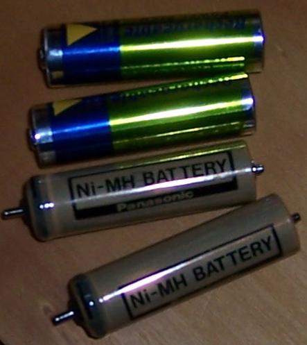

Got Panasonic shaver and after 10 years of happy usage, batteries could be loaded for 24 hours only to give up after 10 seconds of shaving.
(At the beginning could shave for 3 weeks before re-charge)
Got another shaver, so gave up on this one as replacement battery was high and E-Bay had no return policy so smelled some trouble.
(To buy this shape battery, more than $20 each now)
Panasonic does not produce shavers anymore, this one has 12 years now, so suspect spare batteries were not produced either and will be “new old”.
What surprised me that battery showed 1.24V not being charged for 2 years.
Making long story short I used rechargeable batteries (long shelf life ones), shaved internal plastic guide a bit as rechargeable batteries were bit thicker.
Rolled up metal wire to make up the distance to make contact.
Charged up on original inductive charger and it appears to work well.

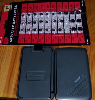

Glad my “ effort “ wasn’t frowned upon I’ll tell you about few more battery stories.
Driven by high battery charges or pure waste, like in case of timer that always has display on
I also adapted few things:

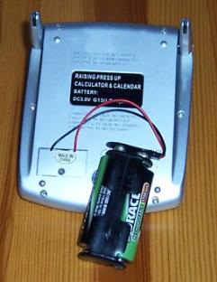

Alarm clock with rechargeable batteries and external battery holder,

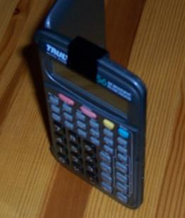

For calculator I used AG12 instead of AG11
(AG12 are bit thicker, but instead of $5 dollars for 3 batteries I got whole card with batteries for $1.50 – it was 2 or 3 years ago and now the same card costs 3 dollars)
To close battery plate I had to put cut piece of plastic that was just about right for the job.

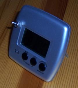

And in timer I installed switch, bit clumsy job as housing does not close and there is gap, but I can turn screen on just before I want to use it.
