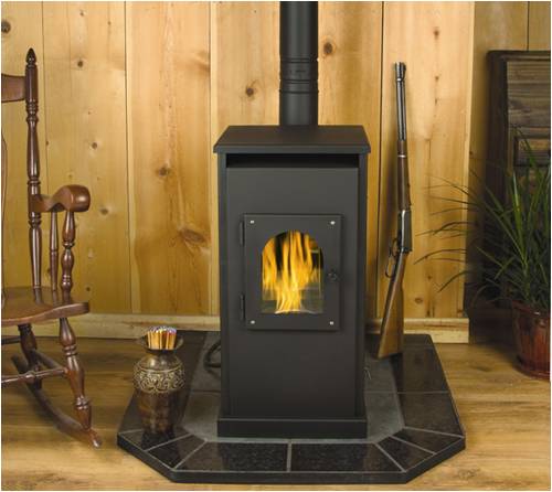

There is a couple of hurdles to clamber over with oil heaters, Pete. Mainly to do with the properties of heater oil vs cooking oil. heater oil is technically a number 2 grade diesel or kerosene, depending on the source of the unfracked crude (similar but not quite the same as diesel used for motor vehicles and without the additives). It has a thinner viscosity than both cooking oil and biodiesel, it ignites easier and burns with no residue. It takes a lot of skill to modify a standard oil heater to burn efficiently and safely with anything else.
I have toyed with the idea of importing a Kuma stove set up for biodiesel but I know that organic waste oils are starting to pick up in value in some parts of the world, so it may not turn out to be the cheapest option in the future.
If you live somewhere cooler, then good reliable heating and insulation will make the biggest change to your standard of living. I notice that large areas of rural NSW is having gas piping laid, it would be interesting to find out the cost of this as an option for heating.

What's that thing to the right of the fireplace ???

Dunno, might be some sort of fancy stick for adjusting the flue maybe? it's not mentioned in the owners manual, so perhaps its an optional extra.
I have seen a shiny bent stick like that at a couple of weddings, so it may be nothing to do with the stove at all! decoration? like frilly curtains?

It may be an igniter
keeping a safe distance from the flames during ignition cycle.

Somthing to play with while sitting on the rocking chair, keep any pests away.

I believe that the thing to the right of the fire box is called a "fire stick" and therefore is perfectly fine to be next to the fire box.

I have quite a few of the "fire sticks". The heater is nice too.

Hi Muddy
With a nice heater like that you would be better to use waste wood for heating and save the reclaimed oil for use in a diesel car to solve transportation issues, and you could use the heat from the rear to generate a bit of electricity by reversing the cooler plates to charge a battery for led lighting, I read an article several years ago from Canada where they used the stove to provide lighting and power the two way radio.

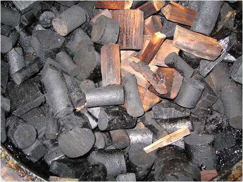

Has anyone here thought of building a gas producer something similar to that used during the war to run automobiles. The priciple is quite simple. You have two chambers the bottom one being the fire box the top one (sealed with strong door) is the oven. Also you will need a 44 gallon drum and copper tubing to make cooling condenser. The gas is fed into an amphometer constucted using extra large Tractor inner tube weighed down with rocks or concrete lid. The idea is to heat wood or even dry weeds in the top chamber while sealed releasing the gas through a coil in drumm filled with water to the amphometer. Once the wood or weeds turn to charcoal the the charcoal is burnt in bottom fire box to start the process all over again.
There has to be a non return valve fitted in gas supply line from gas producer to prevent gas from flowing back when door is opened to remove charcoal and replenish wood or weeds. (anything combustable such as cardboard, paper, cotton rags etc can be used but not plastics).
The gas can be used for heating, cooking, drive engines etc the gas pressure is only as high as the weight used on the inner tube and will remain constant while it is inflated with gas.

Hi Gyro,
I made the mistake of asking my grandfather and a few of his mates about what was wrong with the gas producers they used during the depression when petrol rationing was on. That's a couple of hours I will never get back!!! They had them fitted on a rack over the roof of their trucks and the gas was produced with a chemical reaction. They reckon the quality of the gas was the biggest problem, often the motor would splutter to a stop and leave them stranded.
My grandmother said that that cleaning and reloading the producer was a filthy soul destroying chore. For her to say that it must have been bad cos she could handle almost anything without batting an eyelid.
