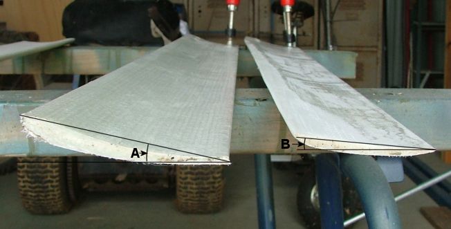

Started working on the Chinese blades, worked out how to reshape them and did one blade as a test. The fibreglass is easy to work with, I cut a wedge out with a wood saw and then used a power file to reshape th leading edge, but a normal wood file would work just as well. Then finished off with some sandpaper. Took about 15 minutes to do one blade. Then the itch hit me. Spent the next 6 hours scratching my arms, I hate working with fibreglass. Trev, your the fibreglass expert, are there any tricks of the trade to stop the itch?
Below you can see the new profile, and the reduced angle of attack at the tips. This new twist should give more power and reduced noise. The blade tip is still very wide at 70mm, only took 30mm off, tapering back to nothing at about 200mm from the root end of the blade.
Angle A was the original tip angle, and B is the new tip angle. Now I just need to work up the courage to face the itch and do the other 2 blades. When done I'll post some pictures and measurements of the whole process.

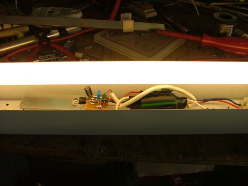

Converted a 240c 40watt fluoro to 12v operation. I used the circuit found here. Works a treat, draws about 2.5 amps at 12v. I'll write up a web page about how I went in the next couple of weeks.

hi Glen are you going put a inverter circuit on the board for the 24v boys as well?

Hi Glen &and All
I have made and lived under many of these litle inverters over the years.unfortunately i could not work out how to listen to the wireless with one running, some way to lessen the noise would be a great improvement.

Build the circuit in a diecast (metal, screw-together) box. Run the power in through feedthroughs and bypass it properly. Feed the HV out to the tube in screened cable, ground the screen to the metal box (but leave it disconnected at the fluro end) and you will be well on the way.
If you put all the electronics in the fluro fitting, as long as you have it nicely screened, you can probably get away with running the DC line through a ferrite core a couple of times as close as possible to the metal of the enclosure to stop the RF getting back down the cable.

Some good tips there Ross. I'll remember to add the ferrite bead.
Hey Matt I'm not 100% sure about the conversion to 24v, Ross or some of the other electronics guru's might be able to help, but I would suggest changing the 180R resistor to 330R, and use 30 turns on the primary instead of the 58 turns used for 12v. Might pay to drop the primary wire size down to 0.8mm too.
The one shown above was a messy build, just wanted to see if it worked before I build another one for photos on the web site. I used 0.6 mm wire for the secondary, so ended up with about 6 layers, close to 30mm diameter when finished. And I had problems with the transistor over heating, probally due to the poor transformer winding not giving the correct circuit loading. I added a bigger heat sink and used a 220R resistor instead of the 180R. Still runs warm but will survive.

Hi Glenn,
Sorry, the itch is just how it is.........
You can use hand lotion/cream, all over uncovered skin. But that gets messy all over your F/g and then you have to get it off for painting.
You can use rubber gloves, long sleeve shirt and trousers. Basically just cover up. You should avoid breathing the dust.
The secret is not to rub or scratch it. Wash with soap as soon as you are finished.
