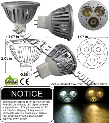

I have been running a MR16 Ledlight out on the patio for around 2 years now as a trial for when I build down south & am really impressed with the output of the 3X1 watt unit; it's only roughly done but it runs off a Panasonic sealed lead/acid 12V 7A/hr battery that hasn't been charged since I connected it up, gotta be happy with that.

barry those are great little lights i have one as a reading lamp and 2 on either end of porch illuminating the entrance gate. i got mine of ebay for next to nothing, also if you have a look through ikea if you ever get dragged there they got some go have a look at there led lights good bang for buck, and can be easily adapted for 12v use as they usually have external power supplys

I'll be down in Perth in March & there's a huge Ikea store near my sons's place, I never expected that they would deal in that sort of thing.
The one I got was around $25.00 & had to get it from South OZ but I see the prices are gradually comming down to an affordable value balance.
When I got mine I checked it's brightness against a 60 watt halogen with a light meter for my old Agfa 35mm camera & they came up the same level, so effectivly a 50 watt saving & worked out over the years should be a significant saving if costs keep comming down.

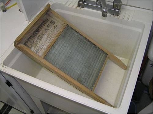

Here ya go Shawn
The perfect power free washing machine.
