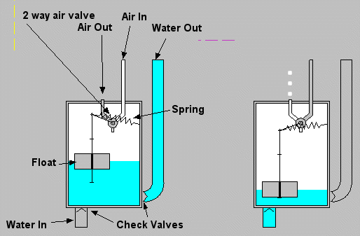

Here's a basic pic.
The whole thing is under water. A float slides up and down a push rod thats attached to a 2 way valve via its control lever. The push rod has two stops, one above and one below the float. The air valve has two positions, when down it lets air out of the chamber, so it fills with water. When up, it lets compressed air into the chamber, forcing the water out through the check valve.
The spring is to snap the valve from one position to the other, and thats the bit I'm wondering if is commerically available, or I need to make something.

If you should decide on the displacement technique using compressed air, there is a ball valve that's called an "Ortega Valve" which might be handy. Basically it's a "T" valve and the handle shuttles water either left or right of the tee.
To use it in your application, water could be let into the tank with the valve shifted to the left while at the same time a linkage uncorks an air vent. When the float signals the tank is full, the valve slides to the right letting in compressed air while another linkage opens the discharge port. One valve, two linkages, a 12-volt solenoid or two and a couple corks!
Just an idea.

Glen, could you use a valve and handle off the water tank side of a toilet? It would be quite simple to rig. The chamber fills with air, operates the handle and lift the valve. When the residual air reaches the valve, it closes and resets. Sorry.I'm not good at drawings.

Edit: Since we've been chatting on the phone of late, I thought I should clarify something. What I explained here is NOT what we talked about on the phone. On the phone, we were talking about what Glen has posted in his picture. The only difference between his picture and what I told you on the phone was that I'd have run the water-delivery outlet from the bottom of the tank with a bias-cut end and welded or sealed at the top of the tank. When high-pressure air is introduced into the filled (with water) tank, as the air expands, it forces the water through the exit pipe, drawing from the bottom of the tank. When al the water is gone, a sensor or float would then switch off the air supply and allow the tank to refill by gracity. What I explained in the first reply above was specifically in answer to your question concerning air bubbles. Hope that clarifies it.
