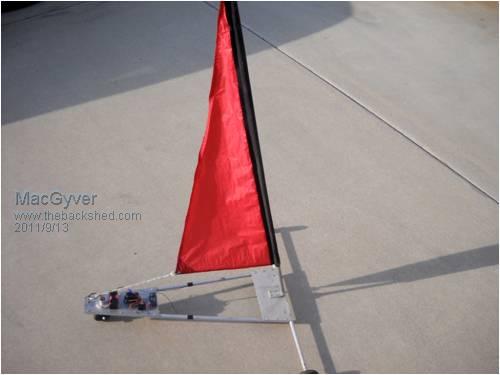

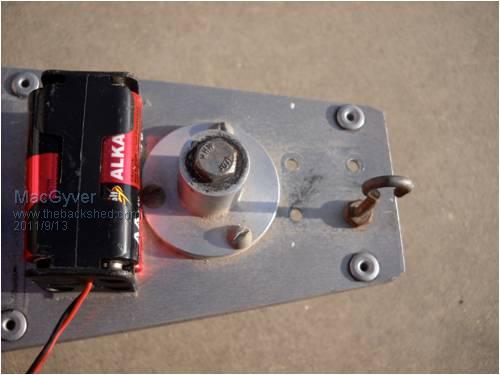

This is my little R/C sail car from the top view.
This shot shows how I "stepped" the mast. It's a pin hooked to a bent
piece of aluminum plate, which is in turn screwed to another plate that
holds the two outboard rails together. The mast is a 3 or 4 foot section
of aluminum tubing slipped over that pin on the deck. The outhaull
holds everything down when underway.

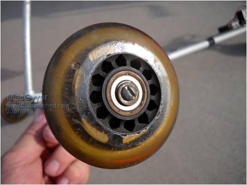

I chose a wheel from a child's "Razor" scooter as both running as well as
steering wheels. I made a pin on my lathe that slips into the front "axle"
and makes up the front of the car. I "pinned" the axle pin to the alum.
tubing with a threaded screw.

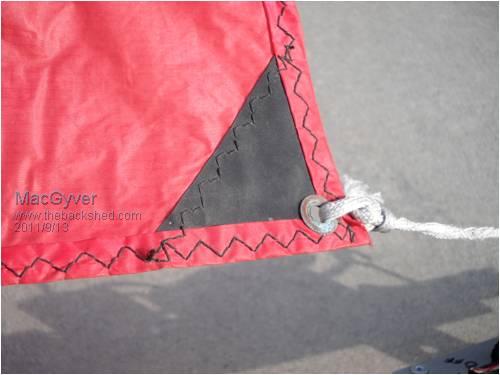

A friend who is a professional sail maker stitched me up a sail made
out of Dacron-polyester material. This is the "outhaul" where the sail
is tied down.

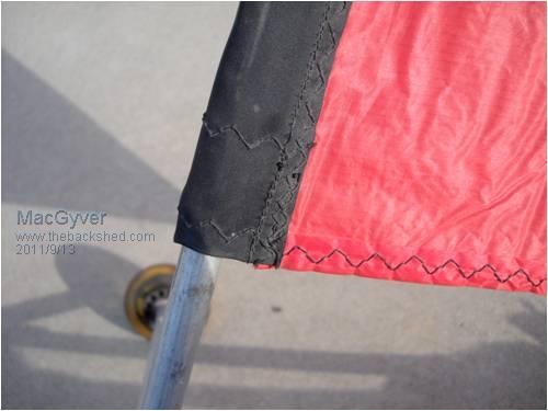

Here is more of that professional stitching. The sail slips onto the mast
using a pocket sewed into the front of the sail.

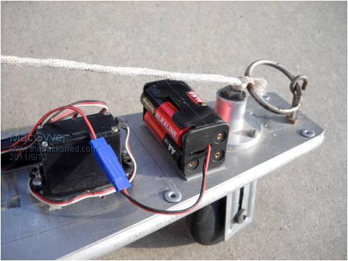

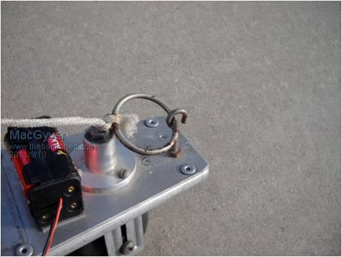

Using a threaded eye, I untwisted the eye and attached the threaded end
to the rear deck with a nut on each side to hold it firmly. The piece of
nylon shock cord (from a parachute) has a key ring attached. When I want
to run closer to the wind, I put my finger through that key ring and wind
up the outhaul, making it effectively shorter. It's like pulling in the main
sheet on a real boat. Then I let the opened eye hold the key ring and
cord and we're sailing!

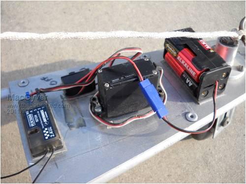

This is the electronics package attached to the stern deck with double-
sided tape. This one uses 4 "AA" cells. The other two black boxes are
a standard "servo" and the ON - OFF switch.

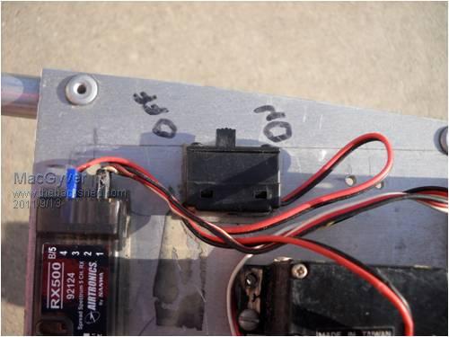

Here's a better shot. That little itty-bitty box is an ON - OFF switch.
The single standard servo is mounted upside-down on the stern deck.
The working arm passes through a hole in the deck and is attached

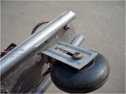

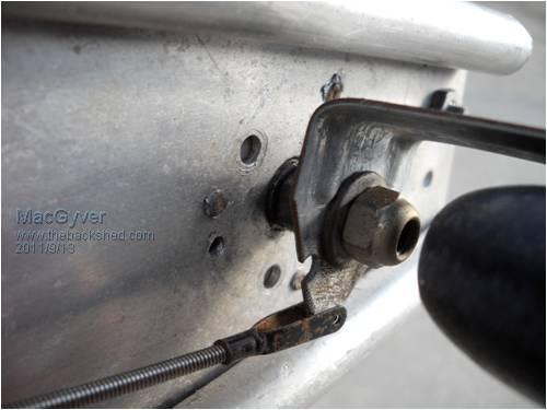

Here's a tight shot of the front end from underneath. I made (turned) my
own axle bearing on the lathe and used a bolt with a long shoulder as my
stearing pin. It works like a champ and is so robust, even a 360* spin on
asphault doesn't screw it up!

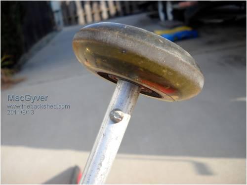

The steerage wheel (like a rudder on a boat) is mounted in a slot so I can
adjust its height as the wheel wears.

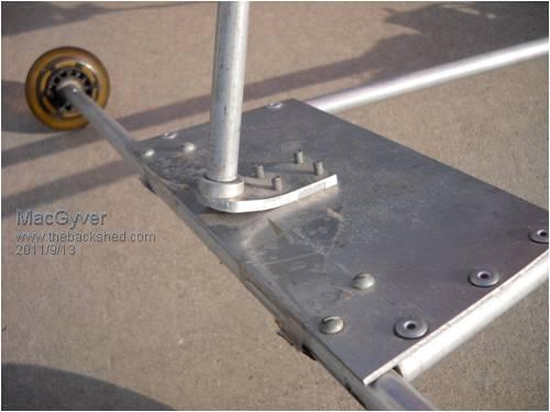

Here we see the front deck, which holds the side rails as well as the front
axle rail and mast mount. I just cut holes and threaded them to accept
store-bought screws.

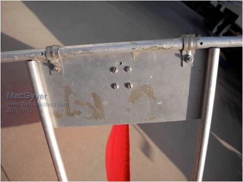

Here's a picture showing how I "pinned" the axles to the frame tubes.

Here's that on and off switch. You MUST have a way to turn things off
or the batteries will be done in while you're walking to the playground
or parking lot.

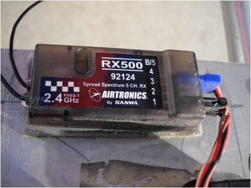

I "borrowed" this receiver out of one of my R/C gliders. This is the kind
of receiver that must be "paired" with the transmitter. My transmitter
has a 50-plane memory. I guess that means I have permission to build
48 more planes, eh? :O)

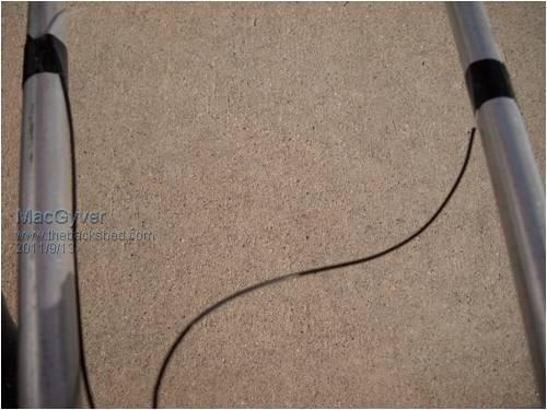

This is how I ran the two receiver antenna wires. They're not supposed
to be close to metal, but when the entire craft is metal, that's not on the
to-do list.
