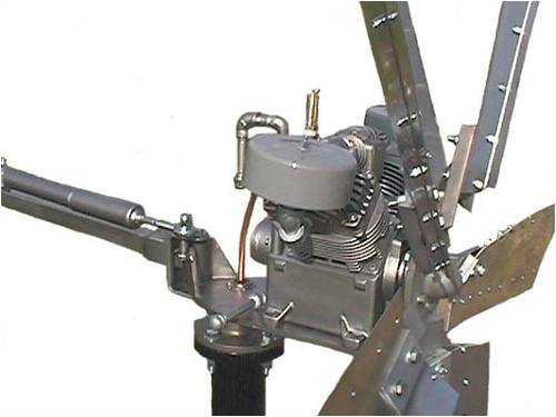

Simply put, I (used to) build windmills that compress air. I build a three-blade, up-wind device with what's called a "swash plate" on the main shaft. As the shaft spins, the swash plate wiggles from fore to aft and drives a small home-made diaphragm pump that pumps a "little" spurt of air each time the blade goes around.
The air is chambered in an on-board check valve body and then goes down a flexible tube to a copper line with a ball valve on it. When I want to stop things, I merely close the valve and the pump pumps against a dead head of air and stops within only several turns.
There is about 120 degrees of flexibility in the hose, which means you have to point the thing in the area of greatest average wind source, which for me is easy as I live on the West Coast of California and there's a sea breeze out of the west, northwest or southwest nearly daily except for the occasional "Santa Ana" about two days a year in which there is an on-shore flow.
At any rate, the little spurts of air collect in a GIANT accumulator so as to be of some use down the road. I'm a (retired) plumber and have access to many used (but not leaking) water heater storage tanks. I just tie them together in parallel and use check valves to keep any occasional leak from depleting the entire system of air pressure.
Next, I build a small "steam" engine and run the compressed air through that, which is coupled to an alternator and that lets me run for however long the air lasts charging my deep-cycle battery.

I set my blade pitch at 45* as a rule, because I'm after start-up torque and don't give a hang about speed; all I do is pump air!

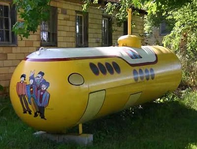

We used large propane gas tanks but you really need a good dryer installed or they rust out.
Temporary storage was 45 Kg propane cylinders with a gate valve and ryco quick coupler on top. Chuck a tank rack and a couple of charged cylinders in the ute. One will run the air tools and the other will fully inflate a tractor tyre.
Commercial air storage farms use similar tanks for low pressure, then boost the pressure, cool the air and store it at massive pressures in gangs of thick walled vertical pipes.
