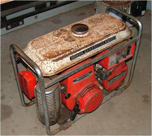

I was given a old ( 1970's ) Honda E1000E 1kw gen set the other day. It didn't run and had been sitting for many years. A fun little project, I like restoring old machinery, which is why I have 3 ride on lawn mowers!
First thing was to pull the alternator apart and blow out the dust and rust. Then I cleaned up the armature slip rings and checked the diodes, all good. Next I pulled the control box apart, blew out the dust and replaced a old electrolytic cap. Again, everything tested OK.

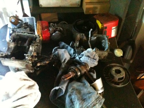

Next was the motor, a 170cc 4.3hp four stroke, Honda G40. Pulled apart and cleaned out the carb, ripped off the head and cleaned the piston top and chamber, its a flathead motor so servicing these parts is dead easy. You can reuse the head gasket many times, and dont use any gasket goo. A lot of oil in the chamber, maybe the rings are stuffed?
Put it all back together and fired it up. Started easily enough, but the motor was very noisey, mechanically, and lots of blue smoke. Bugger, needs new rings and bearings. While I had the motor running, I tested the alternator side of things and it works fine. I ran a 600 watt power drill without any noticable slow down, so at least that side of things was good to go.

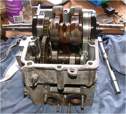

Pulled the motor bottem end apart. The crank bearings are a bit loose, as was the big end bearing. Piston compression rings ok, but oil ring stuck. I broke the oil ring trying to free it, so time to do some research and find some replacement parts.
The main bearings were easy to find. The big end bearing is made up of rollers on a pressed together crank, no way was I going to tackle that one, so I'll leave them in place and hopefully they will last. I found a supplied for the piston rings, $70 for the set, on order.
Next I'll hone the bore and give it a good clean. Its only a 1kw gen set, but I enjoy fixing this sort of stuff and it will come in handy from time to time.

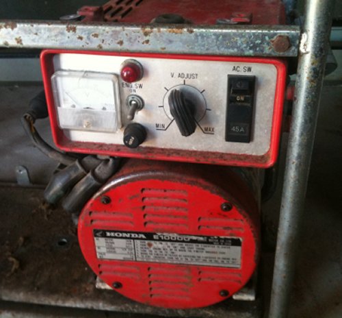

This is the alternator.

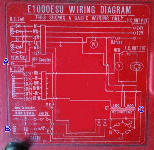

Circuit diagram, I edited it a bit to remove the voltage select plugs. A is the armature coil, B is the exciter coil in the little motor, C is the regulating transformer, its really very simple.
This is the motor in bits. Poor pic, camera phone.

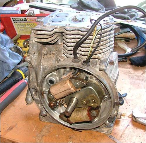

This weekend I put the motor back together. Honed the cylinder and cleaned the block, fitted the new rings and put it together. Bugger of a job
The ignition coil and exciter coil. Its a points magneto system.
All finished.
Took a couple of yanks on the cord to get it going, bit of oil smoke at first but it soon cleared, and the carbie needs a little adjustment to get it running smoothly. My lower back has been out for a few days, and pull starting this thing stuffed me for the day I wont be able to pull start it again for a few days, at least until after I see my chiropractor.
