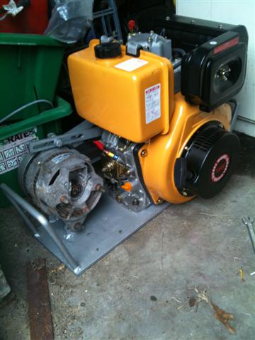

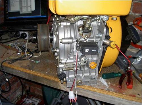

thought this mite up you guys alley
been planning on making one of these for a long time ended up doing a cashie for the neighbour wiring a VN commodore engine into a toyota, and he made up the mounting bracket and machined the pulleys and supplied a engine (great deeal!!)
a little chinese diesel engine and an old scavenged leece neville altrnator 12v 160A
and a mulit rib belt to spin it all, any way thats the mechanical bit out of the way now to make it interesting...
planning on making it auto start ie switched on and off be the pl40 g terminal via a relay, am going to use a picaxe 28m to control it all including cranking, throttle, fuel solnoid and alternator field control.
will keep you updated as i progress and will hopefully pick some of you guys clever brains for some programming help

Posted: 01:05pm 13 Sep 2010

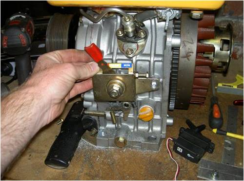

heres the old throttle lever

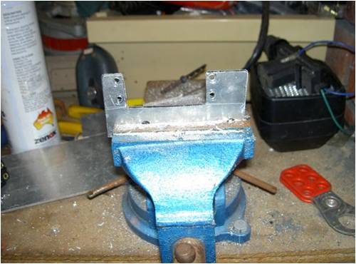

and the servo bracket

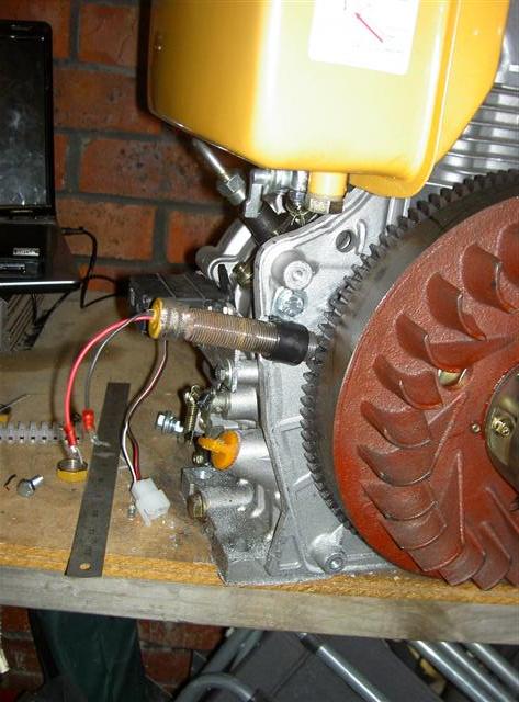

fitting pickup for RPM (yes its a bit rough!!!)
and all fitted up using debug to test servo positions, and theres not much movement to get it from stop to full throttle thats why i added the rough looking extension tot he throttle
just ned some foam rubber to mould around the pickup to block it off nicely

yeah rubber feet is on the to-do list as it does jump alot will see how the throttle servo fares??
was a 12 volt unit but field will be controled by picaxe hopefully as the factory unit is non adjustable if i cant get it to work from the picaxe i will use an adjustable external regulator
cheers
stu

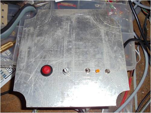

this is my little dash panel (so far) its going into a fibox enclosure with a clear openable lid on the left the start button, the pot for controling the throttle or field strength, next the switch to select throttle or field strength mode, then a power/fault LED and then run/shut down switch which enables the start button and throttle, when switched off it will set the servo position to close the fuel rack.

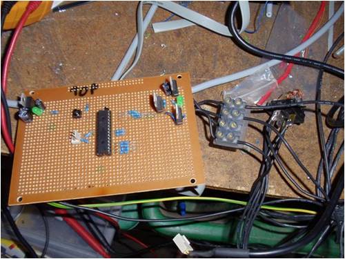

this is my pigs breakfast well it is at the moment while programming and building up, top left is the 5v reg top right 6v reg for servo, then below are 2 mosfets one for the start relay and the other for pwming the alternator field. have a little connector strip for connecting and disconnecting leads to the engine, this is vry handy as you have to disconnect the servo when programming or sometimed the servo will jump around and cause a spike and stuff up the download.
have had a few close calls, first one wad dumb hooked in the diode protected relay in the wrong way and blew a track, the mosfet and a 5v reg, noticed the picaxe getting warm. so shut it down and found 12v at the 5v rail replaced the parts and repaired the track and tried the picaxe and it still worked . i keep a spare anyway cos im a nnubie and am gonna do that stuff anyway.
