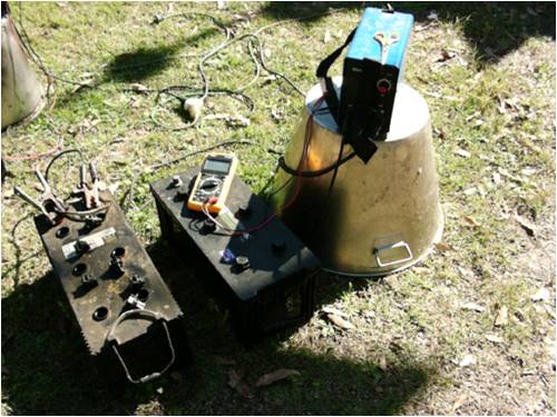

Step one: check electrolyte levels, water level OK but wouldn't move the hydrometer as expected on any cell.

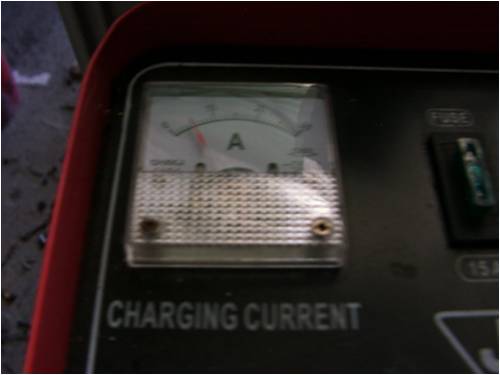

Step 2: hook the battery charger to each battery on 12 and 24 volt setting no current at all totally dead.

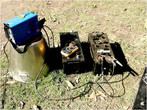

Step 3: King hit, connected my DC inverter welder with output voltage of 60 volts across the batteries one at a time 5 minuets on and 5 minuets off for an hour this started them absorbing a bit of current.

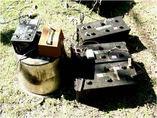

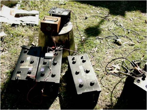

Step 4: hooked up the 24 volt charger to the battery with a desulphator for several hours, started absorbing 5 amps at 30 volts terminal voltage after 2 hours went up to 20 amps at 15 volts terminal voltage, at this point the charger cut out on overload so I went to 12 volt setting with a terminal voltage of 14 volts with a 12 volt desulphator 5 amps after an hour it was up to 15 amps.
This process was repeated on all batteries over the week and now 4 out of 5 have responded to the point that after sitting for 12 hours they maintain a terminal voltage of 13.1 volts on all four. The fifth battery has a dead cell and only reads 10.5 volts after sitting, so this I suspect was the cause of the batteries discharging in the first place, I have given it several king hits with the welder and am starting to get some cell activity on the dead cell, so will fool around with that later on.
Step 5: has been to rotate the chargers and desulphators on the batteries for 24 hours each, and there has been a noticeable decrease in the sulphate visible through the caps. I haven't given them a capacity test as yet to see how much capacity has recovered but would suspect around 30% at this time.
Step 6: next week connect in series parallel with my main battery bank with a charger connected to the 4 and a desulphator connected directly to them with an ammeter in series to monitor their interaction with the main bank with a 5 amp fuse for protection of the main bank should another cell go down, on past experience it may take several months to get them back to usable capacity.

If using the king hit method I use, be sure to time the on and off periods so as not to heat the battery beyond 40 degrees C. and observe the cell activity for an even reaction over all cells, do not leave on long enough to cause violent bubbling as the next step from that is a internal flash over and an explosion, better to take longer than blow the lot up. Do not go away and leave it on as you may forget the time and have a disaster as I did once. If the phone ring turn it all off.
This is the motley collection outside my workshop.
This is the chargers testing for the ability to absorb current No Luck.
This is my little Inverter welder which has a open circuit voltage of 40 to 60 volts depending on the amp setting, it is handy for the king hit process described here and also for a battery charger on the main bank as required with an ammeter in series to monitor feed in current, it is rated at 160 amps 30% duty cycle and 80 amps 100% duty cycle. And its a good welder too, a real bonus.

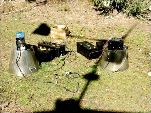

Here is the desulphator connected to the battery for 24 hours, as I have only one spare unit it has been a slow process to bring them up so far, when they are connected to the main bank they will have a dedicated 24 volt unit for a month or two.
This is the dud battery, you will note that it is a different make and model and I suspect old stock from the seller hence the dud cell, maybe if a desulphator had been fitted from day one it would have prevented this expensive debacle, who knows.

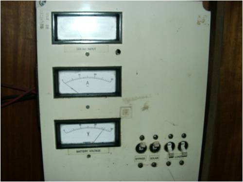

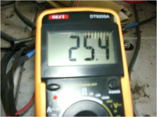

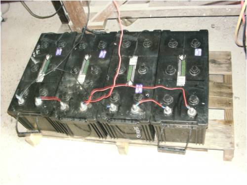

One week of charge cycling and the four batteries have stabilized at 13 . 2 volts after sitting for 24 hours, but there is a lot of sulphate still visible through the caps so it time to hook up to the main bank and continue desulphating.
The batteries are connected in series parallel to give a 24 volt nominal combination.

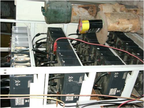

Float battery voltage of the bank while running a grid feed inverter with solar input. The batteries will be cycled to 28.5 volts once a week, I have found that with the desulphator in place there isn't so much need to go over 30 volts to equalize.
The desulphator in place across the lead to the batteries to be recovered. this is connected across all four batteries for a start, after a week I will look at the plates and see how the crystals of sulphate are performing.
Trickle feed into the whole bank total of 4 amps into approx 5000 amp hour battery, just enough to keep the voltage up to where the desulphator cuts in at 25 volts.
Solar input panel sorry the flash hid the gauge reading that was 10 amps at 4 pm so input from solar was minimal and the wind stopped so nothing from the windmill.
This one of four battery banks that the batteries are connected to, these where revived last year from being tired but not in a poor condition as the ones being treated at the moment.
The batteries will be left in place for several months now to just gently desulphate, I will move the desulphator onto each pair every few days to allow more direct contact with the battery pairs and if the cells in one or other need a bit of a boost I will connect a 12 volt desulphator unit across each battery for a few weeks.

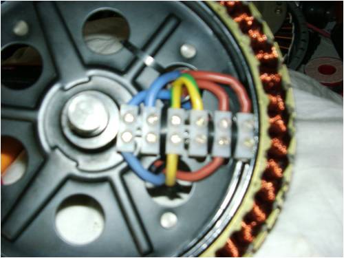

I have rewired the stator so I can do star or delta as required.
