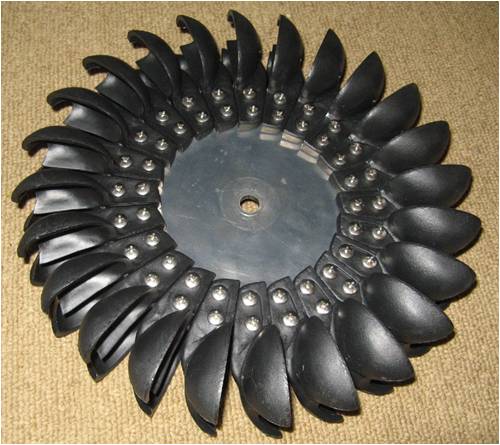

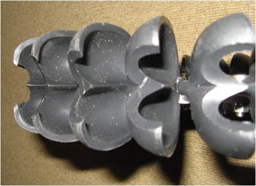

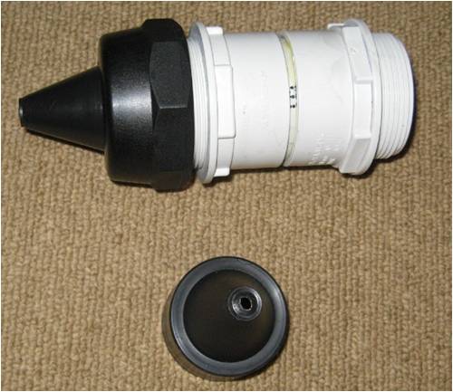

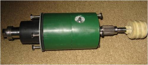

First some photos of the parts:
The pelton rotor:
With a close up of the spoons:

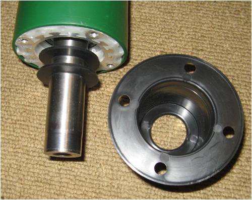

The shaft and bearing block assembly:
A close up of the water "slinger" seal:
The jet block and conical jets. The jet nozzle can be cut to allow different holes sizes for less/more flow:

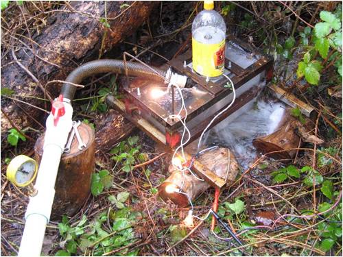

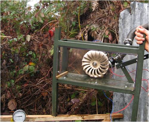

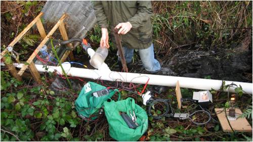

Here's afew more photo's of the old proof-of-concept hydro system (should help answer some of your Q's):
The first time turned the on the tap, i was just amazed at the power of the water just blasting out of the nozzle. The penstock contains almost 1000L of water and just by tapping the pipe you can tell it's holding back a nice little wall of water:

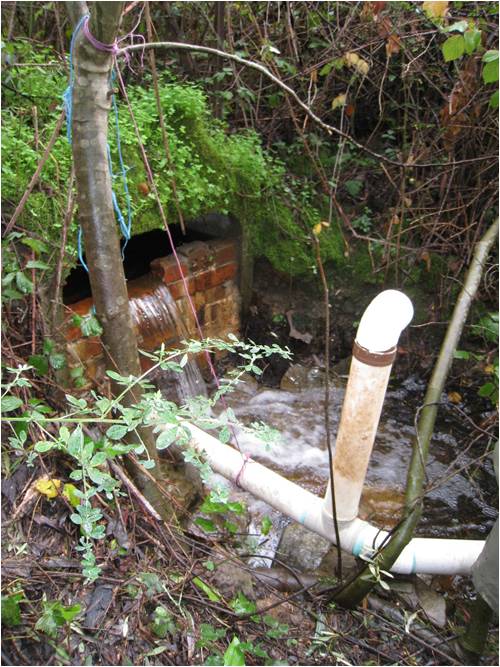

Heres the water intake, with typical flow:
The underside of the "turgo" turbine (frame now painted)
I extended the penstock down the creek to gain an extra 1.5m of fall, from the first test location.
The meter shows 43.7v and the power output is about 100W
The big light bulb is a 1000w projector lamp.
The creek is quite seasonal, it has just started flowing this month with the rain we have just had and it stops flowing in about November.
Generally For at least 3-4 Months of the year there is useable flow

Actually the penstock actually bypasses our main water storage dam, which is below the water intake weir seen in the photo.
I did it this way for a couple of reasons:
1. It gains an extra 2m of fall
2. Without raising the height of the dam, the outlet of the dam doesn't really lend it's self to becoming the water inlet weir.
3. It was easy to brick up to concrete culvert in the photo and brick the pipe into it
Having said that the intake weir does store some water, maybe a 3000-4000L
So I have had some similar ideas, perhaps a float switch that can actuate a ball valve with a windscreen wiper motor to turn on the second jet, if the flow is availiable...
Turning on and off valves on the penstock has to be done SLOWLY, as there is approx 1 ton of water on the move!!
If that comes to a halt suddenly the pipe would be shattered by the water hammer, releasing a mini tsunami.
As it stands closing the valve over a 5 seconds the pressure gauage see-saws up and down, even with a small bleed valve open to help release some of the pressure spikes
The stand pipe just below the intake weir is to stop the pipe from collapsing in on it's self due to the suction if something were to inadvertantly block the intake?!
Or if i block it off deliberately to empty to penstock...

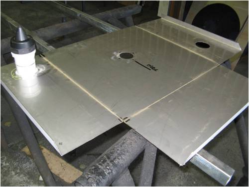

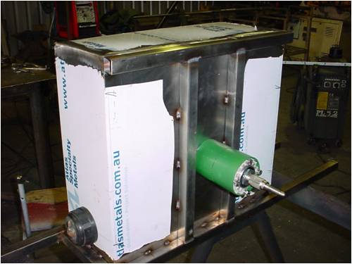

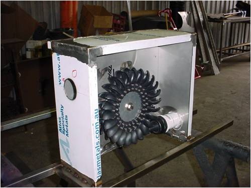

Decided not to stuff around trying to weld up the chassis for the turbine myself, i'm getting it made out of statinless steel...
We have an expert metal fabricator, Nick Besa, who's round the corner from work.
He does alot of of the cinema horn stack brakets and other odd jobs (like making a bomb proof 2m square metal server room)
Anyway he was round at work last week complaining that work had been really quiet and had nothing to do. Mainly because the poor guy got diagnosed with bowel cancer last year and had to have half his guts chopped out, chemotherapy, radiotherapy the whole works. Of course he's had alot of time away from work, hence poeple have been taking their jobs elsewhere.
So i though i'd give him the task of making up the box for my pelton turbine:
He happened to had some 800mm square metal signs made from 2mm food grade stainless steel, that were ordered but then not collected/wanted.
So he's folding up the box out of one of these panels, heres pic taken this morning before it's been folded:
I think he enjoying the slightly off-beat project, which great cause so far it is looking spot on. I'm so glad i didn't bother trying to stuff around myself

Here's a pic of the box after it's been folded and welded:
The bracing and mounting bars that run along the bottom are 25mm stainless tube
The box ended up being a little bigger than i'd planned but that's fine because it will give the spray plenty of space to fall away without interfering with the rotation of the pelton runner.
The front, which is currently open, will be sealed off with a piece of clear polycarbonate sheeting, so i can see what going on when the machine is running.
All thats left is to apply the pickling paste to the welds to remove the burn marks, pull off the plastic covering and it should be all finished!!!
AB
Einstein: Everything should be made as simple as possible, but not one bit simpler
Posted: 12:57pm 23 Apr 2010
Hi AB,
It be worth getting him to make an enclosure for the F&P as well.
From what i understand they dont handle the moist conditions all that well.
A nice box or drop over cover off the back with the F&P in it would be an advantage for the longer term.
Nice work by Nick.
Pete.
