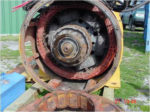

Posted: 09:48pm 27 Jan 2010
There are a few tons available in one of these if you stumble on one in your travels..... theres one outside my door actually.......
Microwave oven transformers are useful for laminates. Should be plenty of these available over there.
