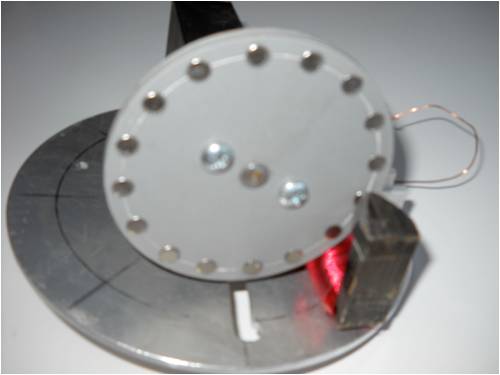

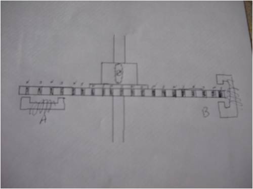

This is what I'm building and what I want to know is: Is this an "axial-flux generator or something else?
The little dark squares are 1/4" neo-magnets press-fit into a solid aluminum plate. Each magnet in the series alternates ends. One is N/S and the next is S/N all the way around evenly spaced.
The plate is attached to the main shaft at the hub with a set screw. The way I've drawn it, it looks like a slot on the hub. That is there because I was having a PM discussion with oztules about using a spring and flyweight mechanism to move the magnet rings to varying distances from the pick up coil(s) in plan "A". The idea was to start out with the magnets far away from the pick-up coils and as the speed of the twirling turbine increased, centripital force would throw the flyweights outboard and they in turn would slide the magnets down the shaft via bell cranks so the thing would be able to start with no load.
The "B" scenario is there in case that's the true AxFx design instead of the "A" one. (I'm striking two birds with one blade here so to speak.)

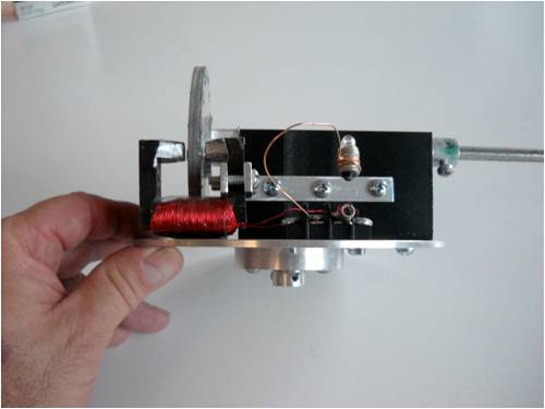

When I zero in on a design, this will be driven directly from the shaft of a VAWT. (VAWT stands for vertical-axis wind turbine for newbies).
I redesigned the Lenz VAWT using both an inboard and outboard "cup" along the leading edge of each of three blades, which all circle the tower parallel to its axis. I did this after doing a wind-vector study of the Lenz to see if I could modify the already-good design to make it have more areas of "push" as each blade swings through its 360-degree, circular pathway. I think my modifications will be just the ticket. Of course, I've said stuff like that before only to wind up with egg on my face, so hide and watch!
I finished constructing the blades yesterday and will attach them to the hub and shaft sometime today. I'll be posting pictures (likely in "Windmills" and not here in "Other Stuff") though as things progress.
Right now, all I want to know is what to call what I'm building as far as the actual generator part is concerned.

i,m confused ....B (to me) looks more like a radial design but using a core in the coil with the same magnetic poles appearing at both ends seems strange...A looks more axial but the core seems to complicate things again ... A this time sees an alternating flux through the core which seems to make more sense.....
coils using alternating flux cores are very confusing to me ......one thing is i suspect it may cog heavily (feel very notchy in operation )

[quote]This is what I'm building and what I want to know is: Is this an "axial-flux generator or something else?[/quote]
Axial flux, as the magnetic fieldlines run parallel to the rotational axis as they leave the magnets.

In both cases, there is an "N" pole and an "S" pole passing by the coil-pick-up ends. In the "A" model, the coils (I only showed one in my little drawing) are mounted under the ring of magnets. This was done to facilitate a spring-loaded sliding mechanism that was to work much the same as a governor on a steam engine. This arrangement allows the magnet ring to pull back from all the ferrous coil pick-up ends when it's not spinning and approach the coils only after gaining some momentum.
I know Peter will likely not like that I am using springs against the wind, but I'm up for trying anyway. Color me consistent.
In the "B" scenario, again, the coil pick-up ends each face an "N" and an "S" as the ring of magnets whirs through the gap, but these coils are mounted around the circumference of the thing and the windmill would have to start against a fully-cogged rotor. Since this is a VAWT, start-up torque is a joke, thus the "A" scenario.
I'm thinking that the "A" model is more along the lines of an axial-flux machine, judging from all I've read about others' efforts, like on Scoraigwind, but I'm still not sure.
Someone pinch me! I'm with you niall, I need some instruction here.

[quote=Niall]i,d appreciate a lesson with regards to axial flux as against radial flux[/quote]
In a radial flux alternator, the magnetic fieldlines leave the magnet surface radially, i.e. like the spokes on a bicycle wheel.
In an axial flux alternator, the magnetic fieldlines leave the magnet surface axially, i.e. in the direction of the axis.

the rotational axis is the shaft ...so i see the parallel connection to A
so for B the flux lines leave the magnet pole on one side and want to travel over the top of the rotor (through the core ) to the other side ...does this make b axial as well ?...
regards
niall
later edit ......the penny finally fully drops .... Edited by niall1 2010-01-13

According to what Peter has explained, I guess it's the way the magnets are aligned as to whether it's axial or radial. In my drawing, I am thinking, like you, that both "A" and "B" are axial generators; the axial-ness of it is determined by the magnet placement, which is the same in each.
If this is wrong, I'm sure Peter will chime in and correct us, but that's my take on it so far.
Now all I have to do is put all the parts together. I've finished building the blades and the hub and all the mounting parts, so I'll try to get everything together and snap a couple pics. I'm going to use the "A" configuration, as I want to be able to adjust the distance of the magnets from the pick-up coils using a home-made governor thingy I cooked up.
I want my windmill to be able to start with no load and since it's a VAWT, it's more than merely on my "wish list"; starting no-load a necessity!
I'll keep everyone in the loop.Edited by MacGyver 2010-01-13

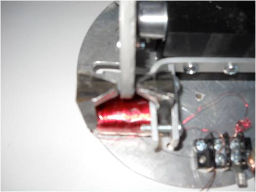

Dinges
Take a look at my drawing, please. What do you think about mounting another pick-up loop suspended atop the magnets as a method to make a "return pathway" for the flux lines?
From the side, it would look almost like the letter "O" elongated and with a slot at each end. I don't know if this would help generate more electricity or just cog like nobody's business.
Edit: herbelagenen -- my "new word" of the week! (re-calculating)Edited by MacGyver 2010-01-13
