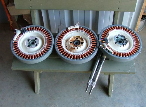

So with everything packed up, as I was saying, the projects have ground to a stop. But I still get to have a little fun. Visited the dump ( tip, refuse center, recycling center, etc ) yesterday and picked up a few goodies. 3 80series F&P motors and two shafts.

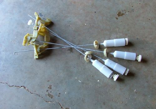

and while I was pulling apart the F&P washers I grabbed 4 good bowl dampers .

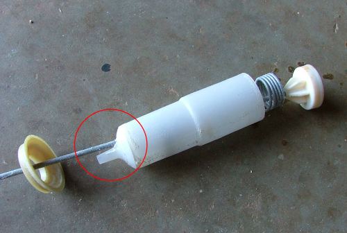

I dont know the correct name for these, the bowl hangs from them and they have a built in shock absorber. My own washing machine is a old F&P smartdrive that I keep running with the F&P spares I pick up for my windmill projects. Over the last few months its developed a habit of going out of balance in the spin cycles. Its dampers were in poor condition, the steel rod had worn through the plastic damper housing, so the air cushion inside had a bigger than usual hole to vent from.
The one above has the area circles where it wears through. Replacing all four dampers has fixed the problem, the washer has so far completed two wash cycles without missing a beat. While I had the machine apart I replaced the top bearing, a 6005. The seal was starting to leak and this bearing was on the way out. I also swapped the drive shaft for another, the old one had very deep groves where the seal was riding, so hopefully it will seal ok now. No drips so far.

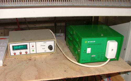

I also picked up a BP inverter from a colleague. He had bought the inverter for a client but the sale didn't go thought, so I managed to grab it for a good price. Its a 400W continuous 1000W peak true sinewave inverter, 12V input. It replaced my 600W modified squarewave inverter.
