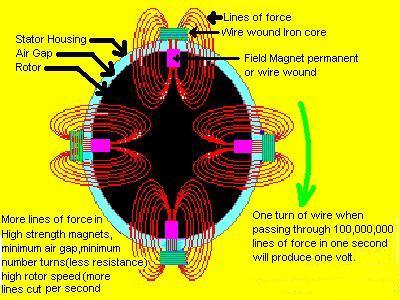

This graphic illustration of a 4 pole alternator (Maximum cogging) is to show the importance of having a good arrangement of hardware when building a generator. The best machine will be the one that captures the greatest percentage of the magnetic field (lines of force).
In the case of windmills there is a problem with having all the magnets aligned with the stator coils,The force required to pull loose of the magnetic attraction requires a fairly high wind but once it gets started the flywheel effect carries it through . In order to function in moderate and light wind the magnets are deliberately offset to cause half the magnets to pull in a forward direction while the others pull backward. this balance allows the turbine to start in very light wind.
Now an example ;
The 4 pole alt. has been wound with 36 turns #18 B&S enameled wire on each iron pole piece
To keep it simple, 4 Neo permanent magnets with a field of 70,000 lines each. can't cut all of em, but we'll fake it!
With all coils wired in series as if it were one big coil all turns wound in the same direction we now have 144 turns cutting 4 X 70,000 lines of force at 4 times each revolution. (144 X 70,000 = 10,080,000). (10,080,000 X 4 poles per rev.= 40320000).= 1-RPM . For voltage calculation the number of events in one revolution does not count,. The instantanous voltage of a single event is the system voltage However the number of events contributes to the total power of the system.(Ampere's). The wired coil magnetic flux occupies 90 degrees of stator circumference this means the neo mag will pass the coil in 1/4 the time of one revolution.
so every rev. counts as 4 times quicker cutting time. Note : it is the number of lines of force actually cut per second,. so it boils down to the number of turns in the coil and the speed of the rotor. To keep your generator within the speed of sound it should have a generous magnetic field.
So multiply the Number of turns that are cutting number of field lines in one second in one event. Then divide by 100,000,000.
The size of wire does not change this formula.
13.2 volts needs 100,000.000 X 13.2 in one second.= 1,320,000,000. At what speed will the alt. generate 13.2 volts.
I have posted this for the purpose of helping other people who are new at wiring coils.
There is much more to designing a good coil but a basic one can be made quite easily. Know the field strength of your magnet, convert specifications to field lines then know your speed of operation , from there, the voltage and number of coils can be worked out.
Impedance, reluctance, resistance. magnetic coupling, inductive reactance, hysteresis, Yea ! when you add all this
it probably will need twice as much-----Greenbelt

I have done a lot of testing on a number of areas for generating power. I have found a lot of flawed info, many seem to follow what every does.
I am a retired tech, I will try to post a pic not sure how it will work on this forum.
The so called flux lines that every one seem to go with is the formation of iron filings on a piece of paper, this has now been proven to be incorrect.
The main lines that produce a ‘force’ as in grams or kg is not the same.
If you can get a gauss meter you could prove it your self if you know how to work them correctly.
The gauss reading is the ‘field strength’ of the magnet , ‘grenbelt posted a pic and some information on calculating the voltage, I have no idea where he got this stuff from, I would be interested to know.
The pic that I will try to post four of them show you the field strength of a circular rod mag. I have found out a lot of stuff to do with wind turbines and the way that most of you are connecting them and a whole lot more, it shows that most of what is being ‘followed’ is wrong, even Hugh P’s wind turbine.
