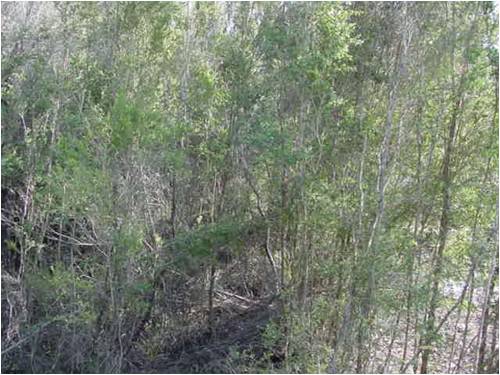

As some of you know, I have a few acres of farmland and forest. I had seen some impressive looking brush fences on the net, and decided to give it a go.
I had hundreds of acres of Leptospermum laevigatum (coastal tea tree) and eucalyptus... so I decided to give it a go. There was no shortage of "brush".

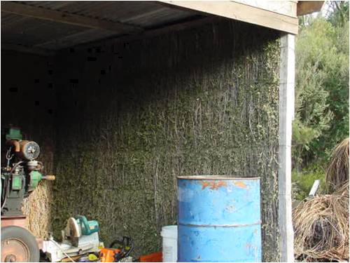

So I stuck 2 poles in the ground about 3m apart, and ran 7 runs of wire between them with a top timber to stop the wire tension pulling them together.
Well, I built the 3m fence, and it worked out so well I decided to build 2 more and turn it into a bush shed.

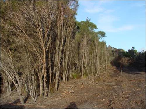

The raw material looks like this... and I have miles of it:

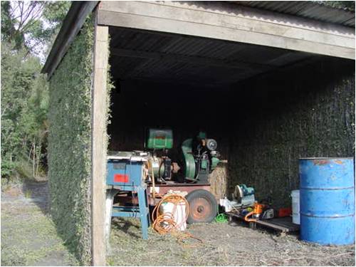

The shed ended up looking like this:
and this:

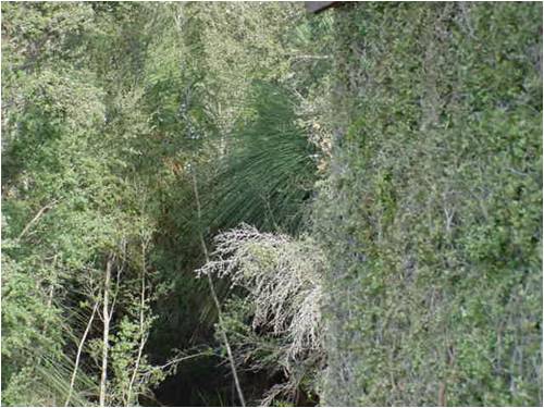

It does blend in with the forest at the moment as seen here:
It now houses my little lister gen set. and some gear to build still more "shedding".

He he.... the walls are about 5" thick and tight packed. Almost no air seeps through..... not as well ventilated as you may think.
I am going to make a taller longer one to put the Cat D6 (955L) in as a temporary shelter. It costs nothing to make, and will keep the rain and sun off the old girl.... and one for the cat 12 grader... and one for the tractor.... a whole third world village in fact by the looks of it.
I did it as an experiment to see how good it would look to do fencing around the house area... looked better than I had thought.

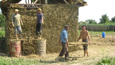

I like how it looks. And is faster than using clay and straw as here:

Are there issues with protected native vegetation?
How will the brush sheds stand up over time?
Certainly in urban situations brush fences don’t age that well.
They can also be a fire hazard.
It certainly looks like a good neat job.
I suppose if you want more ventilation you can make the wall thinner or don’t pack it as tightly

Posted: 08:51am 03 Jun 2009
Protected native vegetation.... not in this case. This is private fire regrowth... and the fire brigade should have burnt it again last year... but were over worked.
It is regarded in a lot of areas that it has been introduced as a weed, almost as notorious as African Boxthorn... particularly around Goolwa, where efforts to eradicate it and Boxthorn have been underway from 2007.
"During November ‘07 we started a project near the
Goolwa foreshore. The site is called Tokeuremoar
Reserve and the job requires that we control as
many introduced Acacia cyclops - Coastal Wattle,
Leptospermum laevigatum - Coastal Teatree and
Lycium ferocissimum - African Boxthorn as the budget allows"
This was from: http://www.naturalstate.com.au/documents/newsspringsummer07. pdf
It is a very bug retardant, and survives prolonged water and dirt exposure... Should last for 50 years, but has been in fences in SAust for at least 70 years apparently.
The four poles holding it up will rot away long before the tea tree does.... and probably the wire. (strangely enough, gal wire in the scrub over here lasts longer than 40 years, but exposed to the wind lasts 20 or so.
In Urban settings, you probably have more conventional brush fences with smaller brush woven/ferreted into the wires from the top and the bottom (brushy head down and up at bottom and top respectively), these may sag with time if not tied properly or lazily, this one is solid sticks full length, from bottom to top. In fact most sticks were over 3m when fed in, then chainsawn off at height, and the heads ferreted into the bottom to help with opacity.
Also in the urban setting, apparently they are the focus of cretins with matches, and this would preclude their longevity somewhat.
Surprise surprise... another chainsaw use Dinges.
.........oztules Edited by oztules 2009-06-04
