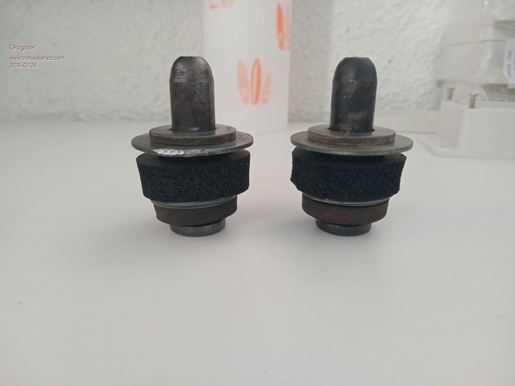

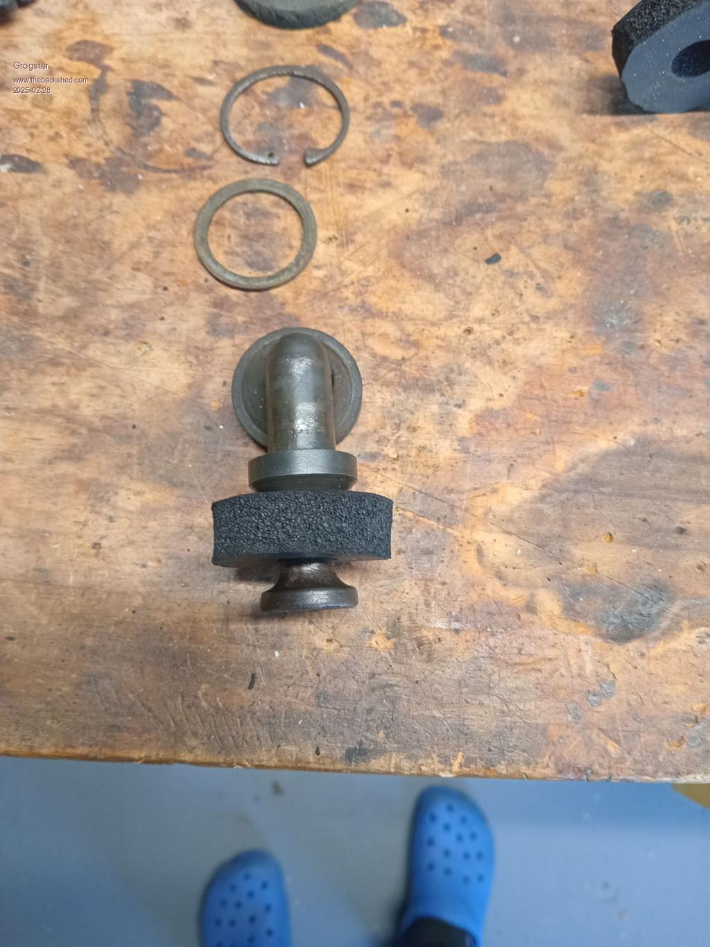

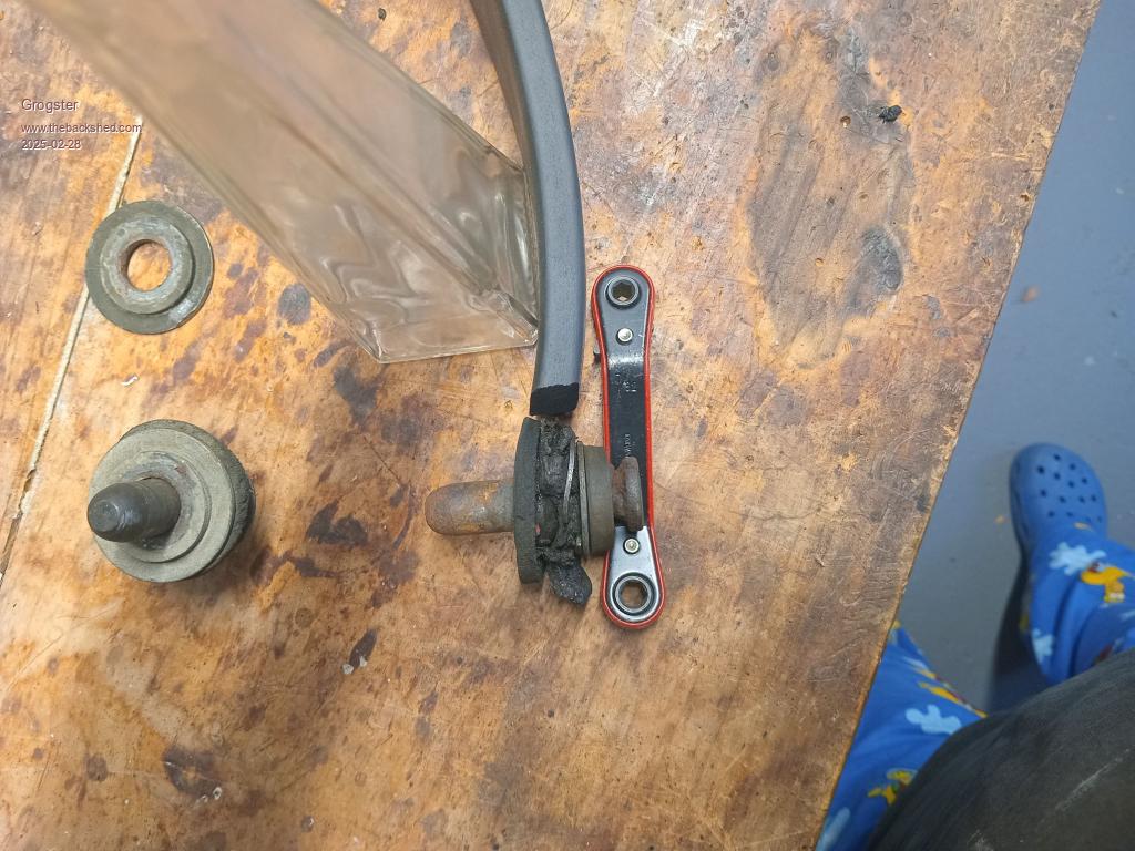

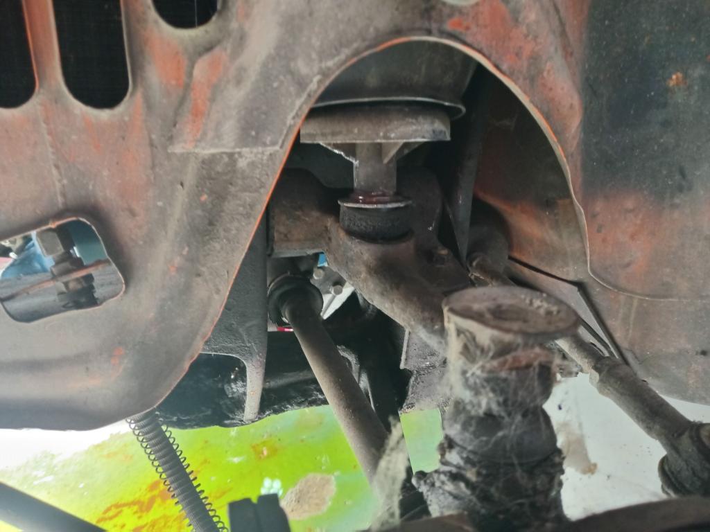

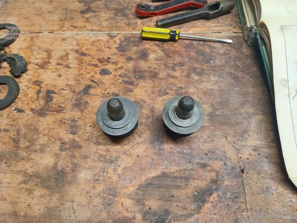

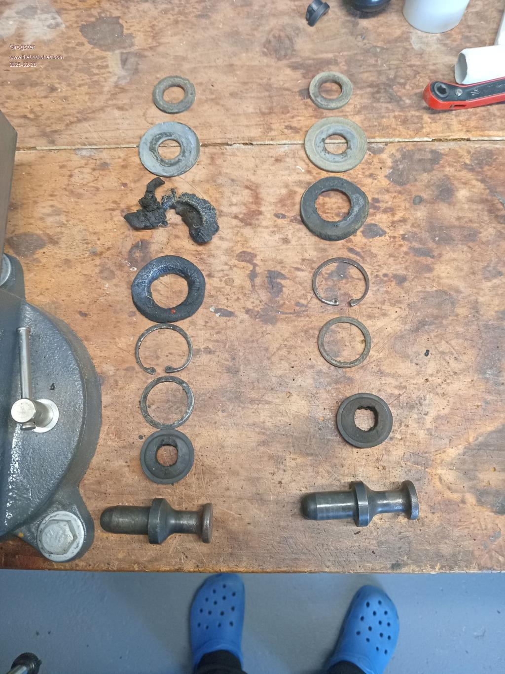

On the 1100/1300 series cars from the 70's(Austin/Morris/MG/Riley/Woolsey/Vanden Plas), the upper suspension-arm has a foam-rubber weather-seal.
It is not anything SERIOUS in terms of WOF or MOT, but it needs to be intact.

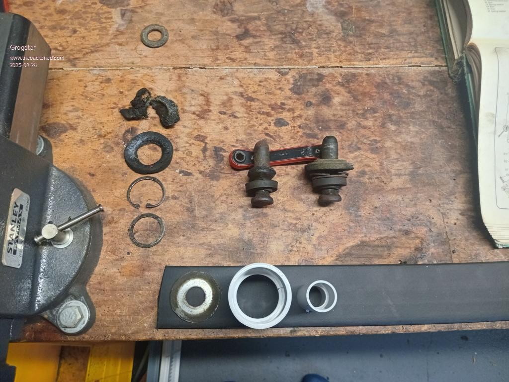

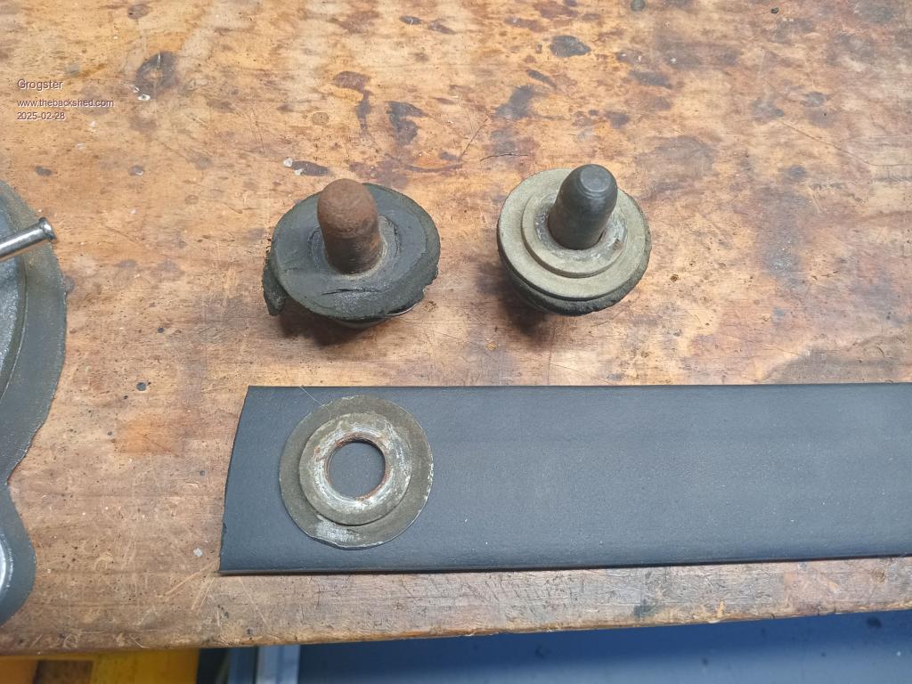

After 50-odd years, these break-down into a bubbled rubber sticky goo, and as there are ZERO after-market replacements to be had, one has to - basically - make new ones if the vehicle fails as a result of the condition of these.

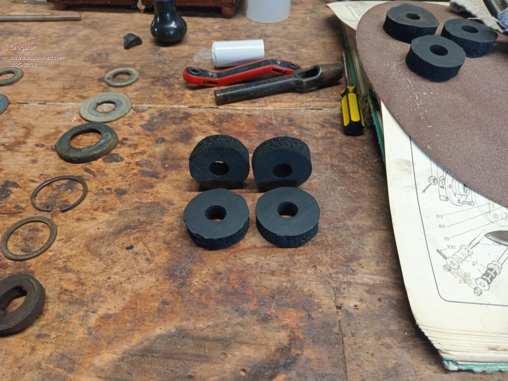

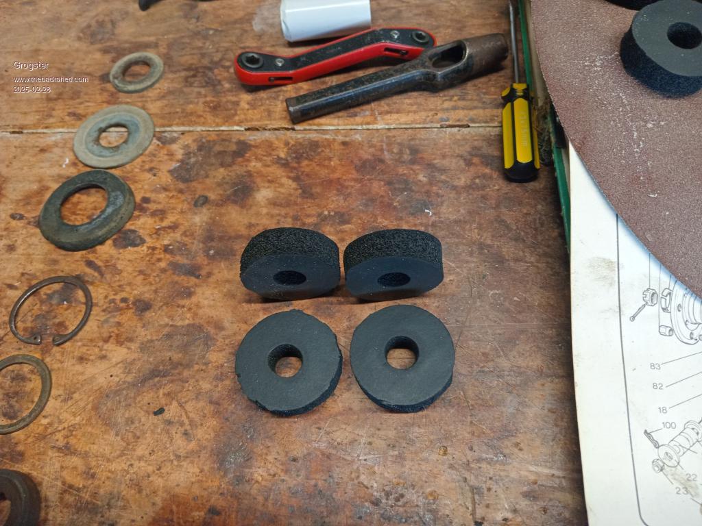

I used 53mm x 14mm MDFR(medium-density foam-rubber) for my replacements.

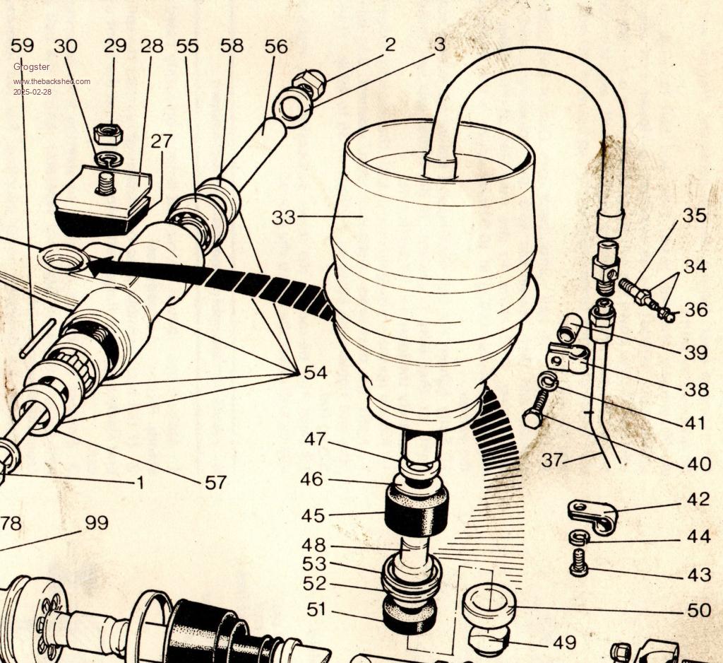

From the manual: Part #45 is the one that turns to bubbly goo...
Various photos now follow, but I am now ready to refit these on Sunday.

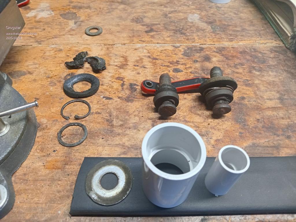

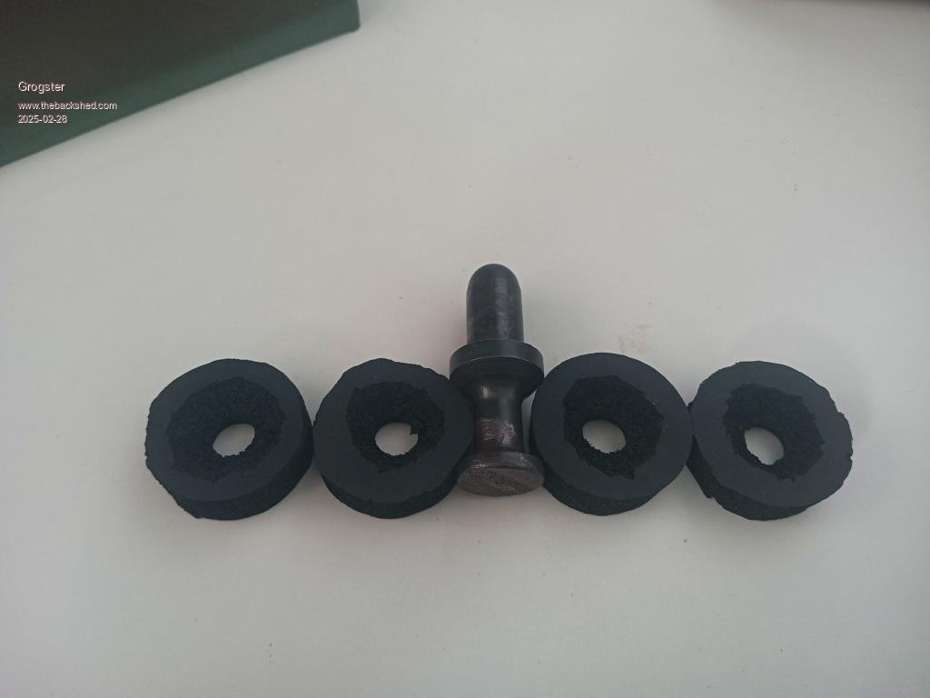

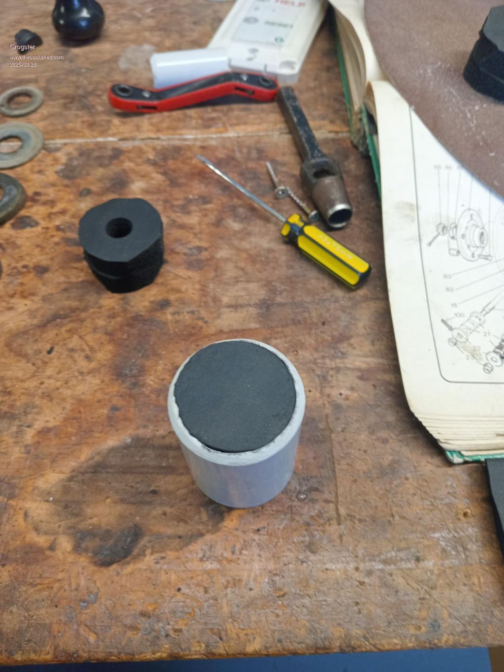

I did a rubber mount using an old Bobcat Tyre tread, a powerful low speed drill a hole saw and a lot of swearing.

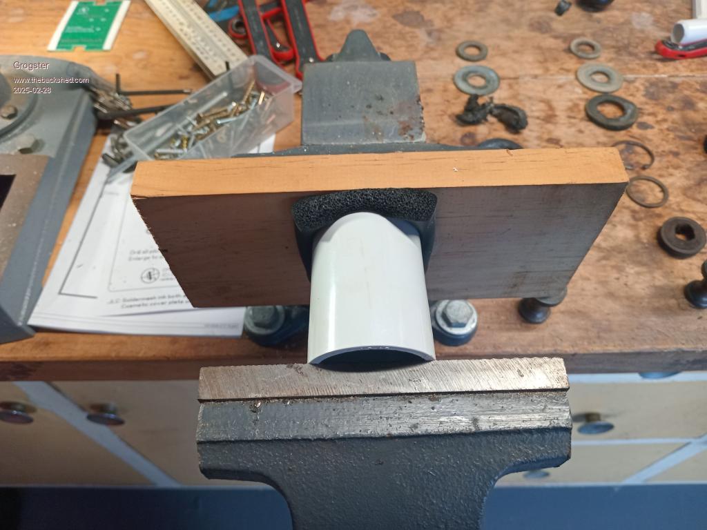

Interesting that you managed to cut it with a PVC tube section.
I have used re ground old hole saws for large hole punches, done in a vise like you.

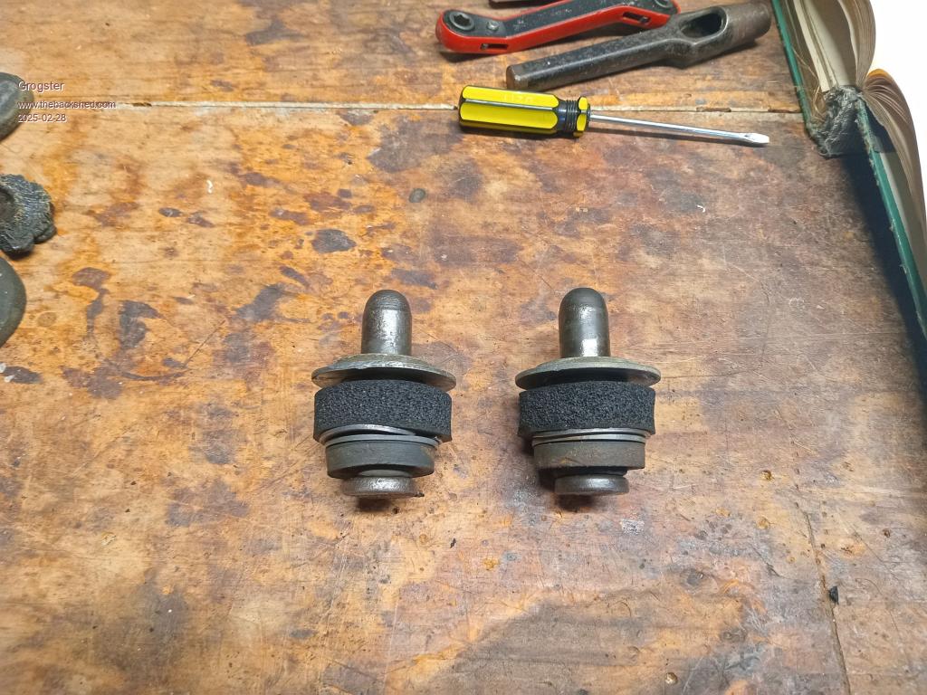

Yes, the result worked fine, but if there IS a next time - I will use 40mm STEEL PIPE, and sharpen that on the grinder.  The PVC pipe method worked OK for the ones I stamped out, but after two or three stampings in the vice, the PVC pipe had dulled, so steel pipe would be MUCH better for this kind of thing.
Here is the result:
