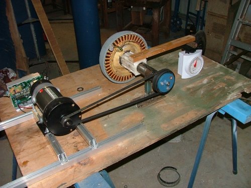

I needed a Prony brake, so I can accurately measure power and efficiency. Add a couple of meters and I would be able to plot power/RPM/voltage curves.
I used a DC 130v treadmill motor and controller. This is the result.

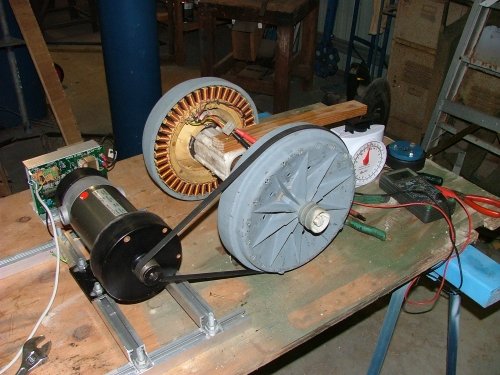

The pulley on the F&P shaft was from the treadmill, I found it didnt give enough reduction in RPM, so I ended up using a spare F&P hub as a large pulley.
Heres a closer look at the bearing.
Tomorrow I'll calibrate the thing, work out some bearing losses, and start testing. I have some batteries so I can test for 12/24 and 48 volts, I can experiment with the cap conversions, and test my staggered stators to work out the cut in speeds of each stage.

Hi Perry

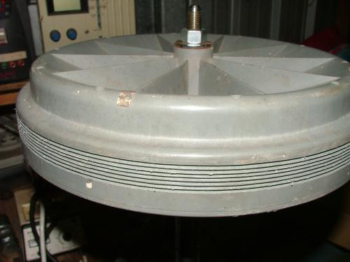

I had a problem with the belt slipping if I tried to draw any mor ethan 200 watts from the F&P. If I increased the belt tension, the F&P hub I was using as a pulley would deform. So I took the hub into a mates workshop and machined some groves to match the multigrove belt I was using.
Thats as far as I got. I havn't had a chance to try it out, but I will in the future.
