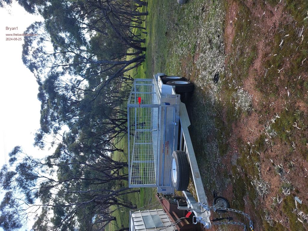

So finally registered with GraysOnline and had a look and came away with this

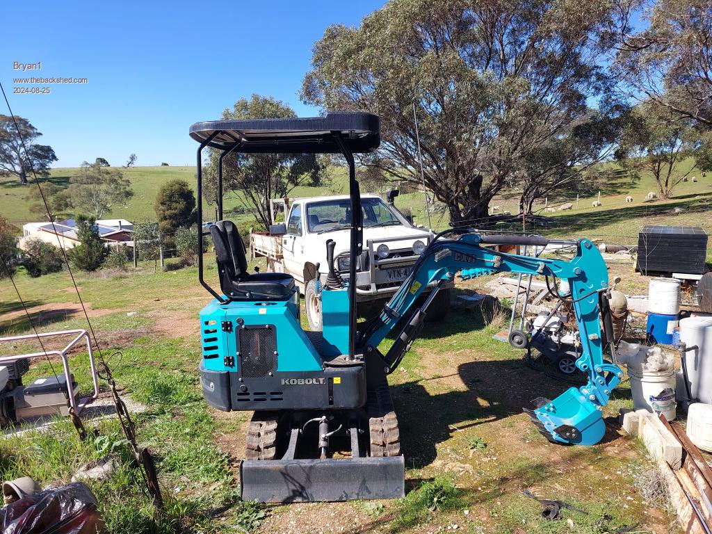

Now also looked at this mini Kobolt excavator I did win the final bid but it came under the reserve. So the next day got a call and as my final bid was 8.95K got asked for a higher bid so went 9.5K, got a call back and 9.55K was the response so this came home.
Only 166 hours on the clock built in 2023 and spent most of this year in a auction house due to one reason a oil leak.
So took one side of the floor to find one flare nut loose on the distribution block so basically got a brandnew mini backhoe.

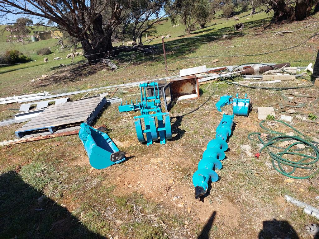

Also the attachments are still brandnew
So I can finally sort out the drainage problem of when it rains the roads wash away and the best part I can teach my daughter how to learn to use a backhoe.

Nice little thing to play with,  it will do well with trenching and post holes, the grab is very useful, just be very careful been such a small machine if you get the bucked or ripper hooked on a rock, old stump or a tree root, when the ripper or bucket brakes free under lifting load it can violently knock you around in the cab, can bust bolts and pipes, bigger excavators tend to be a bit more stable when working.
I'm sure you will learn quickly with it, keep some new underwear handy just in case you need it.
Nice retirement, the Excavator will pay for itself in no time, and you will find plenty of jobs for it.

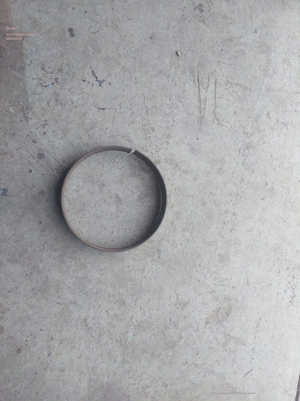

            Finally got my sectional Bender all finished and did a short youtube of the setup
Video link
https://youtu.be/5XK0roXpQow
Then as I had some 40x3mm flat bar just had to have a play and do the first roll   there is 75mm of kerf on each side which was expected using large rollers so one just 95% forms the piece then cut the kerf off to finish the last 5%.
Pretty happy this project has worked out nicely and just got a few finishing touch's to do to get it all finished.

Great, thats running nicely.
Would like to see it rolling flat bar.
Just thinking, This would be good for making vintage engine transporter wheels.

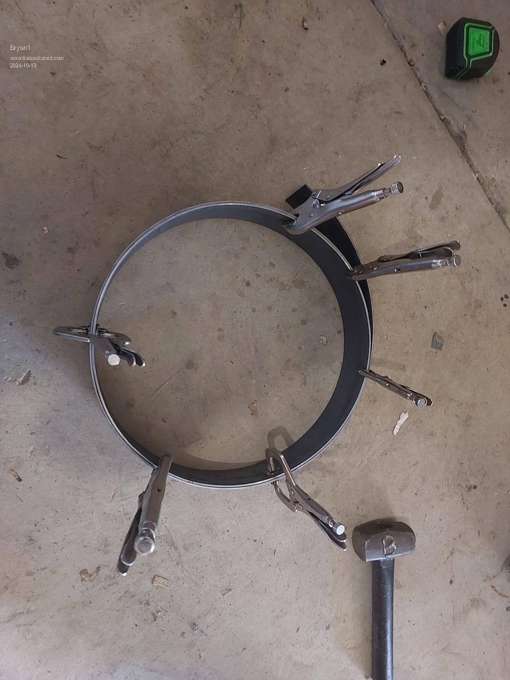

While having my morning coffee in my shed took a look at my 16hp Listeroid where that 100 year old 12" pulley is too small and the ST genhead goes over voltage and likes to kill mig welders. Well I took that mig back in and said I turned it on and it went bang so got it repaired with all new boards under warranty.
Now I worked out I needed a 16" pulley so a good job for my sectional bender, worked out I needed 1500mm long 75x3mm flat bar and did 2 lengths to thicken up the OD.
Got some 40x10mm flat bar for the spokes and I am thinking of rolling a third skin as this is a big pulley.
So next job is finally hooking up that first inverter I made so I can use my mig welder to weld this pulley up.
With the first roll I was chasing 5mm to get it totally round and looked at the time and got moving to get my lunch at the local shop with 10 minutes left to closing time. So after lunch decided the first roll can be the base and I roughed down the second skin that can wrap around.
