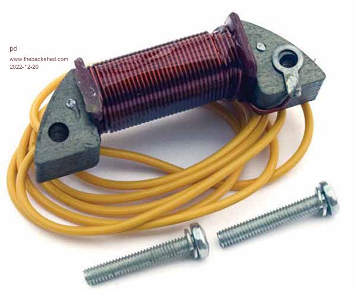

Many of the smaller motorcycles do exactly what you are trying to do.
Thea have a separate lighting coil opposite the coil used for the ignition.
many of them just have a rectifier and battery.
if the lights are not on then the battery gets an equalizing charge.
This is pritty typical of a lighting coil you would find mounted on the inside of a flywheel
