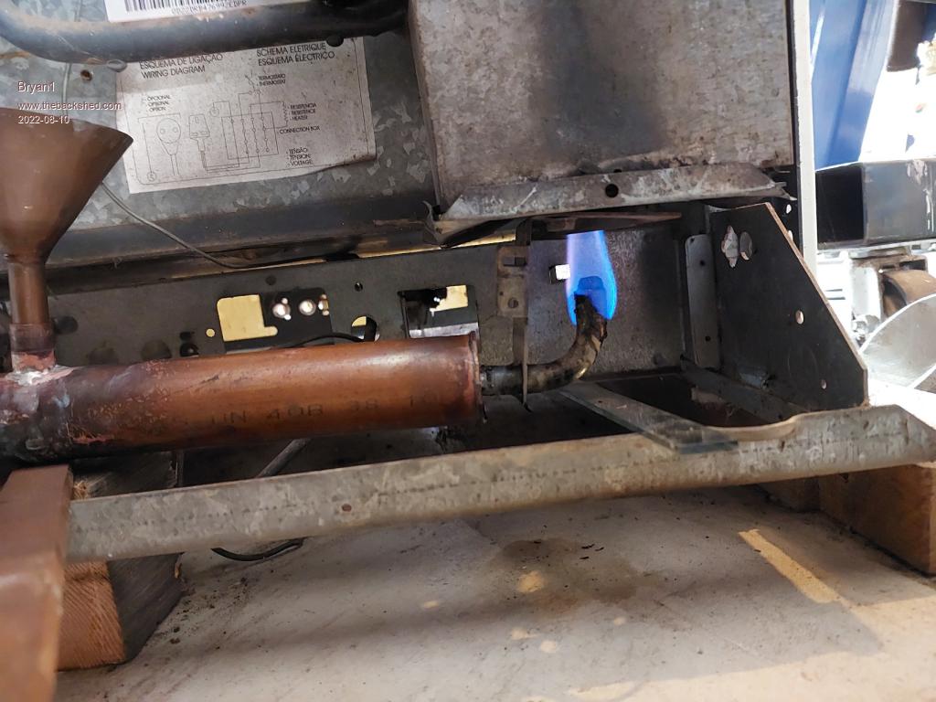

So the old gas burner that a weird thread that wasn't standard and a 1/2" pipe OD, so I made a 200mm long chamber out of copper pipe and put a 1/2" hole in one end to hold the burner.

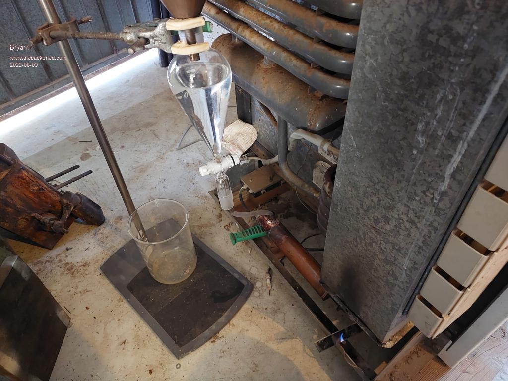

Keeping the liquid level at the right level is the key to burning a nice flame and I did find tilting the rear end up produced a much better flame and I used my separatory funnel to at first deliver a drop every 8 sec's but found i did need to increase the drip rate to about 3 seconds. Now the funnel size is 250ml and I reckon from rate of the drop it will go over night and still be going in the morning.
This is a temp setup to prove it works then I'll make a permanent setup with a drip glass window and needle valve to set the correct flow. If too much is metered it will pour out the burner and cause a fire.
I did find a copper reducer to put over the flame so it could get a good burn and in that picture is an inverted view of the flame with that mirror.

Well had a look this morning and the burner had gone out and while I had it apart to try out some air.fuel ratios silly me broke the solder joint on the burn pipe. So cleaned it up and decided mount facing down so the chamber which holds 150ml is facing down at the back. This will cause the fluid level to stay constant and I did shove some SS scrubber up the burn pipe to stop surges of fluid if I over fill it.
Well with this setup the flame is the best yet and in the next few hours see if I can get this ammonia boiling to kick start the fridge.

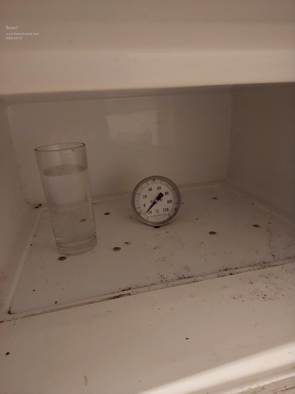

The freezer is now down to -3 degrees and the fridge down to 6 degrees so the goal is too see if this will go all night.

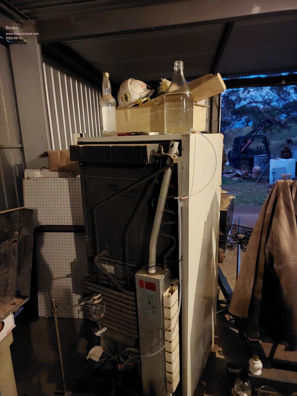

I'm making up a new permanent drip fixture and I'll use a fuel tap off a RC car and use some 1/8" teflon hose. The main hopper is a 2 litre goon bottle and I drilled a 10mm hole in and I had a rubber grommet and for a solid mount epoxied the joint.

           YAY got the fridge working nicely now and setup an overnight solution
It was fun connecting the RC fuel throttle and I found on one section it was only 2.5mm so got some 1/8" copper tube and screwed it into the tube and cut a silicon washer so the nut could press on it to ensure a seal.
Now getting the burner to just over run proved what was needed to kick start the fridge
and the best part
So it will be interesting to see with the new drip arrangement if it stays going over night and the level left in the 2 litre bottle.
