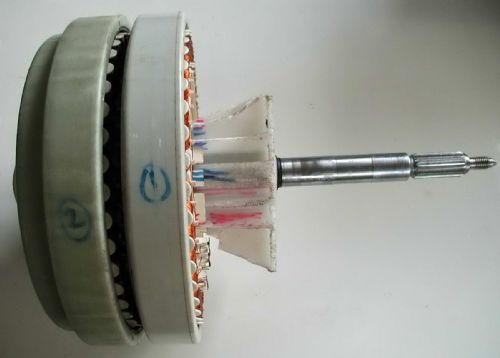

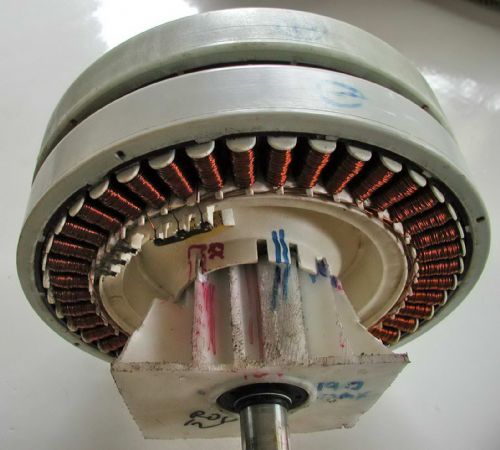

Has anyone has chopped 40mm of the end of the bearing assembly & inserted another rotor similar to this ?
Also having them so close can anyone tell me if this affect the out put ?
When I spin the Stators they only have approx. 2mm +/-1mm wobble as I cut them with a 1mm angle grinder whilst letting the grinder rotate on the bearings.
Obviously I have not connected both of the Rotors together as yet.
So, other than fiberglass is there an easier way to connect the two ?
I have seen a few that have home made bearing assembles for wind, but this is far too complicated for me at this stage of the project.

Looks good so far, i have seen another set up like this but they had the coils off set, not in line together.. I think it will reduce the clogging effect. The way you have is set in the photos the clogging will be bad..

I wouldn't think cogging will be a bad thing on hydro. Its not stop start like wind.

From what I have read to stop coging all you have to do is Ground the metal areas round, making sure not to damage the Copper windings.
For the Magnetic Hubs, I was thinking of Fibreglassing them together, I also thought of using thin sheet metal but not sure of the effect to the magnets & efficiency.

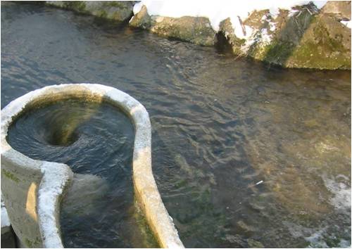

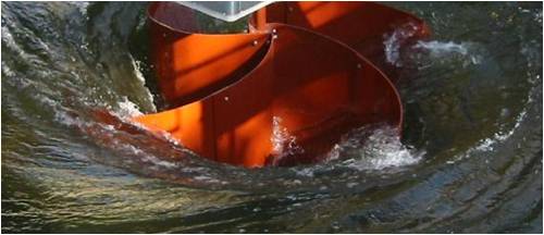

The centre blade to be built onto a geared hub belt driven to the Generator that will be housing and suspended over the structure below.
This is what I am building to place the generator housing over the centre of the vortex.
