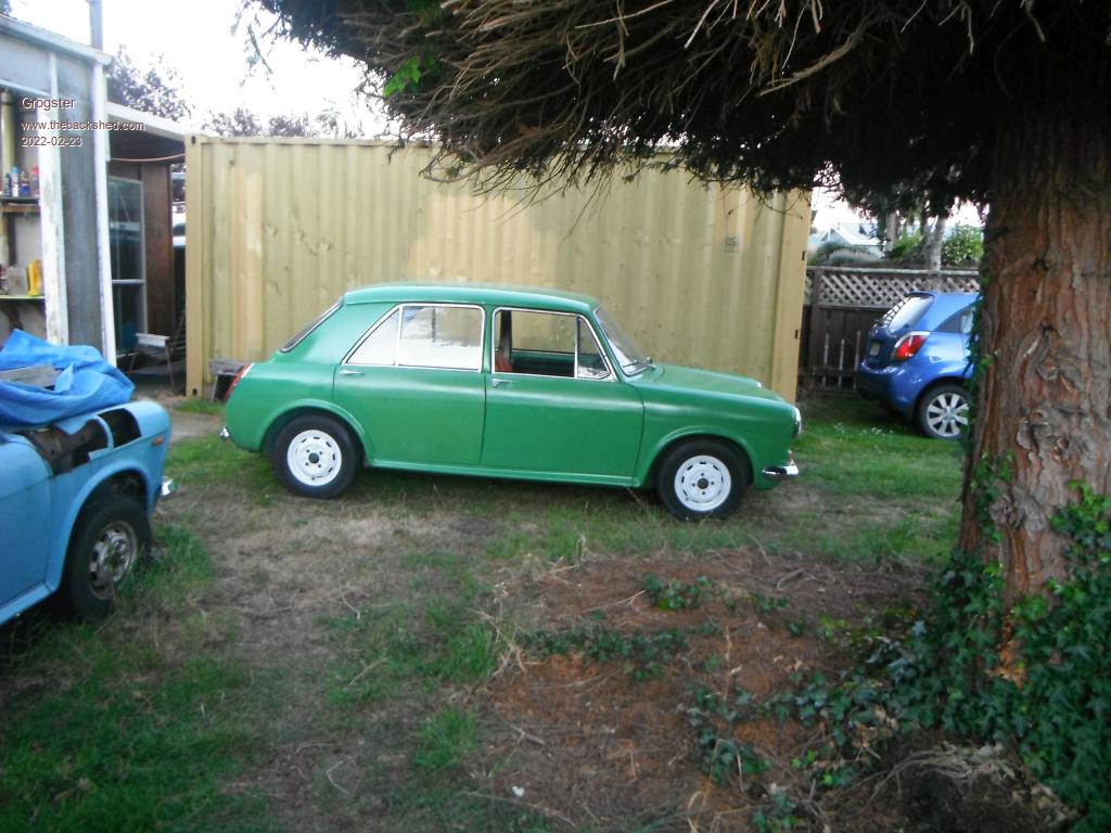

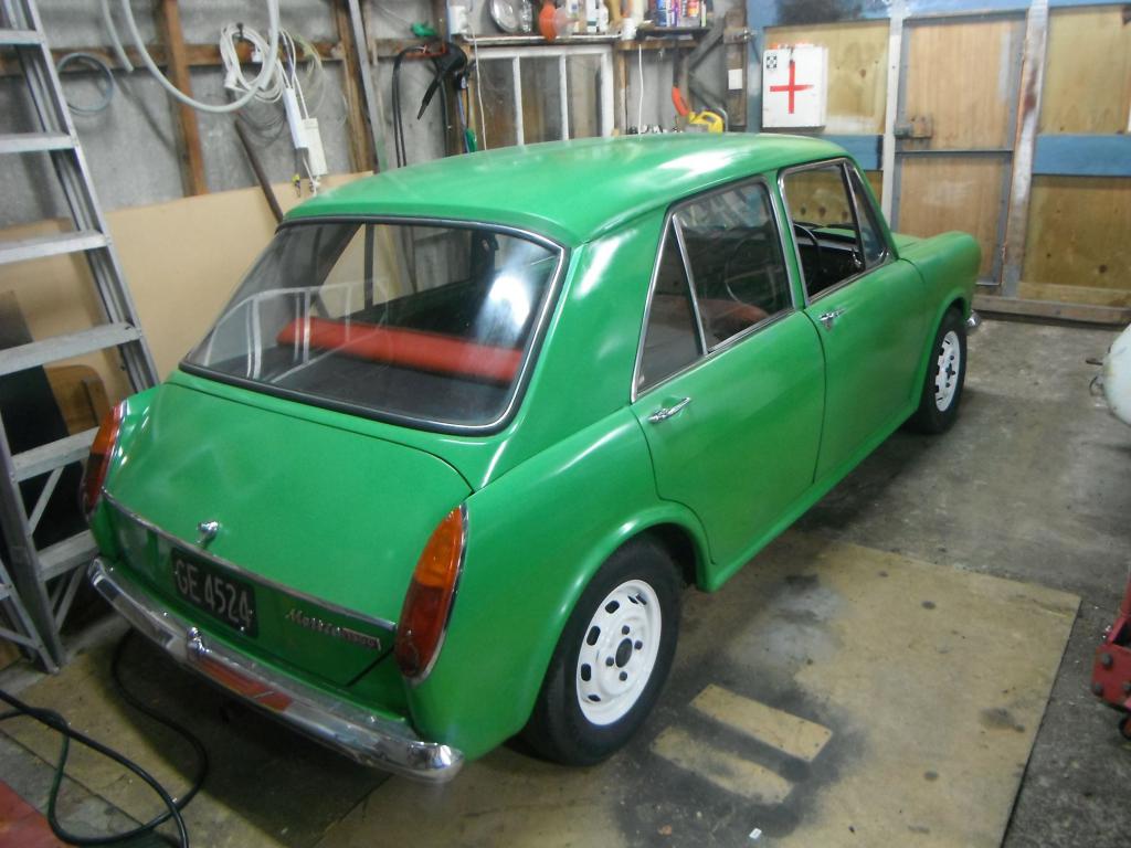

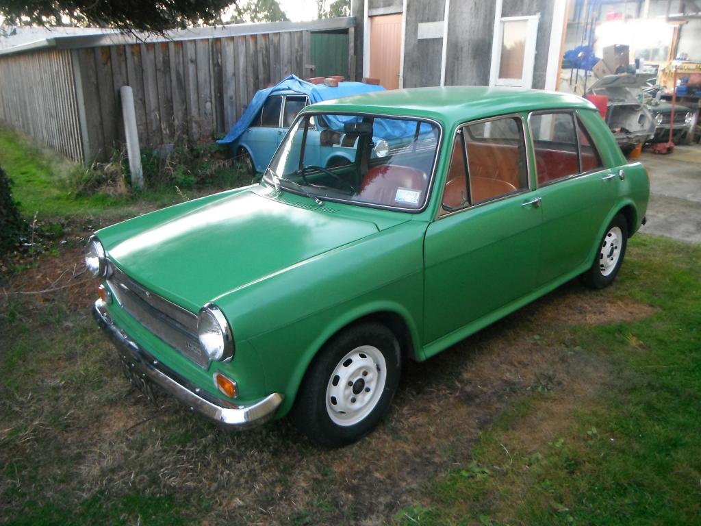

Some photos for the nostalgic....
Yes, those old, beautiful English cars still do exist.
These photos are of the car after its rebuild and having a new WOF. (Warrant Of Fitness).
I think this WOF thing is a non-issue in America especially, so long as you register it.
In NZ, every six months you MUST submit your car for a mechanical test - rust, and other structural issues etc.  You CANNOT put your vehicle on the road without a current WOF.  Just another way to bleed the people, I think, but there you go.
Obviously not that much of an issue in USA, cos they don't even have a WOF, but I digress.....
