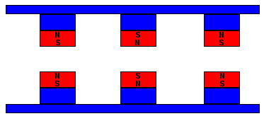

This is what I'm thinking.
Each magnet is on a steel pillar, to lift it clear of the rotor plates. The magnet path through the steel rotor is still complete, if slightly longer. The hope is a larger gap could be achieved with the same flux density. It would be interresting to see what FEM has to say. If adding steel pillars means a increased flux density or increased air gap, than its a cheaper option that stacked magnets and better power than single magnets flat against the rotor face.
See what I'm getting at.

Glenn, as you can see, I ran the simulations and made a little animation of your idea to try to improve the axial flux. However, as the animation only shows the flow of the flux lines it's not easy to determine absolute value of flux densities to compare your design with the normal axial flux. So, I ran two more simulations (for the specific case of an airgap of exactly one magnet thickness, i.e. 12.7mm) to gather the hard numbers. As peak flux densities turned out to be exactly the same for both cases I did another check and integrated the flux (area of integration is 25mm wide and exactly halfway in the airgap). It turns out that even then there is no difference between the normal axial flux design and yours... Not what I intuitively expected (says more about my intuition than anything else, I suppose...). See numbers below:
Normal axial flux generator:
Average B.n = 0.67953 Tesla
Gizmo's axial flux generator:
Average B.n = 0.680348 Tesla
Absolutely no difference between the two apart from noise.
It looks like the conventional dual rotors (with magnets on both) are actually a pretty good design. One thing I've concluded from doing all these simulations and watching the animations is that it will take a pretty clever guy to make improvements to the magnetic circuit of the axial flux...
