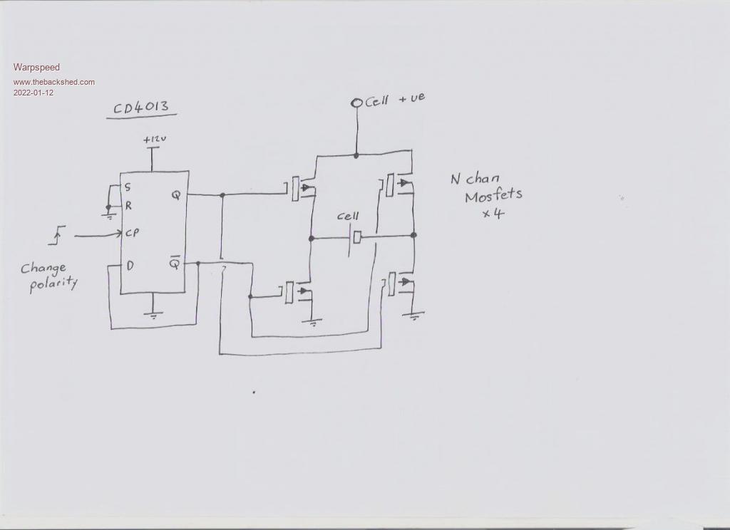

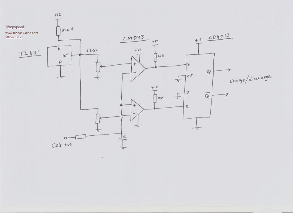

Posted: 12:04am 12 Jan 2022
O/k Leslie, first part of the puzzle, a battery cell sex changer that swaps the cell around so we are always dealing with the positive end with respect to ground.
Its just a simple bridge circuit with four N channel mosfets. The mosfets can be as large and as many as necessary (perhaps with heatsinks), or really small for initial testing.
As the "cell" will always be at less than 2.5 volts, if we drive the mosfet gates with a much higher voltage such as +12v, we can connect all our gates directly to a flip flop which really simplifies things a lot.
The flip flop determines which end of the cell is grounded, and which end becomes positive, for the purposes of both charging and discharging.
The next part consists of a stable 2.5 volt regulator using a TL431, and two potentiometers to set the max charging voltage and minimum discharge voltage. A multimeter direct onto the pot would be used to set the required voltages.
A couple of voltage comparators toggle another flip flop to either the "Charge" or "discharge" mode.  The discharge load could be a simple resistor or something a bit more complex such as a constant current load.
Charging circuit can also be simple or complex.
The charge/discharge flip flop just cycles back and forth between the two set voltages.
That can toggle the sex change flip flop so it goes through a charge discharge cycle, then changes sex before going through the next charge discharge cycle.
Its not a complete circuit, but just a concept. I think something quite simple would be well up to the job.
A digital or electromagnetic counter could count the number of sex change cycles easily enough to know when you get to thirty, or whatever.

One thing to note about the sex change circuit.
You must discharge the cell to less than 0.5 volts before inverting the polarity, if you don't the inverse diodes in the mosfets might be a problem.
Also when reconnecting a fully charged cell, it must go in the right way around or once again there might be a problem diode right across the cell that causes a high uncontrolled discharge current.
A simple fix would be to fit a couple of red leds connected to the flip flop to show which cell terminal is currently the (safe) positive side.

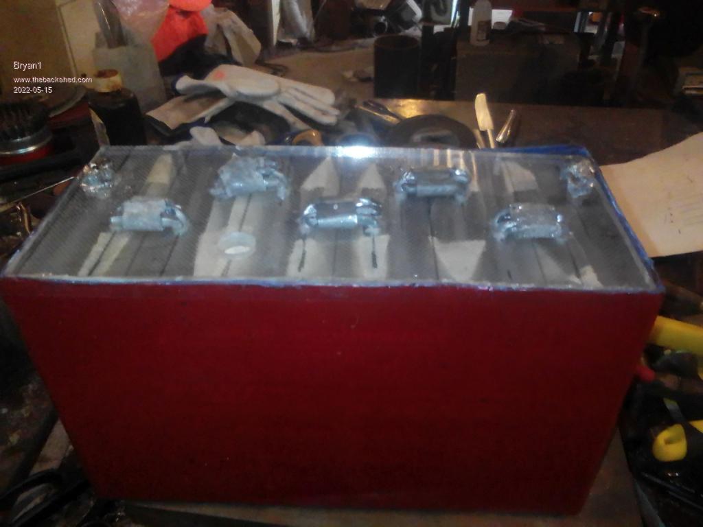

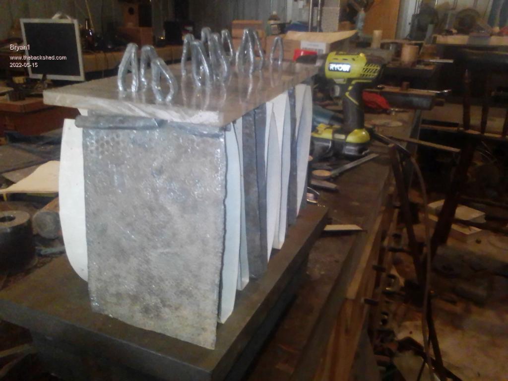

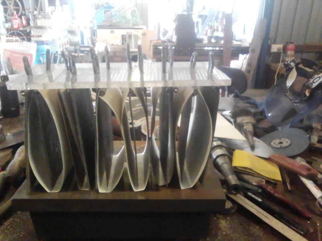

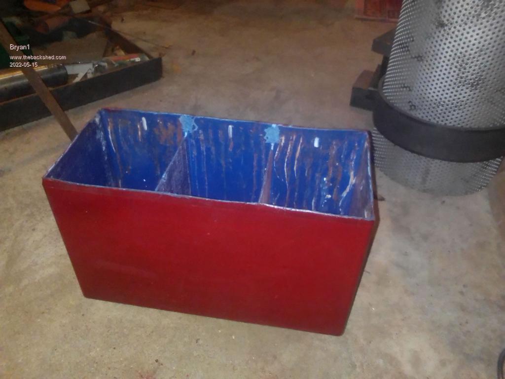

Bryan1
Joined: 22/02/2006
Posts: 2297
Posted: 05:57am 15 Jan 2022
G'Day Guy's,
           Checked the single cell this morning and with no solar input 2.33 volts so decided to drain the battery so connected that reduction motor and left it running. Came backup to the shed after lunch and that motor was still going and the voltage was down to 1.4 volts so put on the nichrome wire and about an hour later it was down to 0.5 volts.
As the sun was about to shine thru the shed door changed the polarity and put my dmm on where on the 20 volt setting it was showing zero volts so put it on the 2 volt setting and 0.005 volts. Take off the solar and it jumps to -0.7 volts so it is going to take a few days for the polarity change to really take effect.
As a precaution using the sulphuric acid I put the cell in a square bucket and noticed today some liquid in the bottom of the bucket, tested with some ph papers and it is acid. now the liquid level I set was about 15mm above the plates and it had dropped to the top of the plates so it is only a very small leak and not a problem yet.
All good fun
Cheers Bryan

  Warpspeed said  I suppose it depends if you are paying for the power.
Costs nothing to heat up a resistor.
If you are sucking power from the grid to discharge your cell, it ain't free.
I'm a little dense, so bear with me... Isn't it the same thing? The total amount of energy is the same whether you discharge through a load or if you reverse the polarity against the charged cell.
Scenario 1): Put 10 joules into a cell. Disconnect power. Discharge 10 joules from cell. Apply reverse current. Put 10 joules into cell. Total energy from supply = 20 joules.
Scenario 2) Put 10 joules into cell. Reverse current. Current is doubled because cell and power supply are in series. 10 joules dissipated as heat in FETs. 10 joules absorbed by cell. Total energy = 20 joules.
