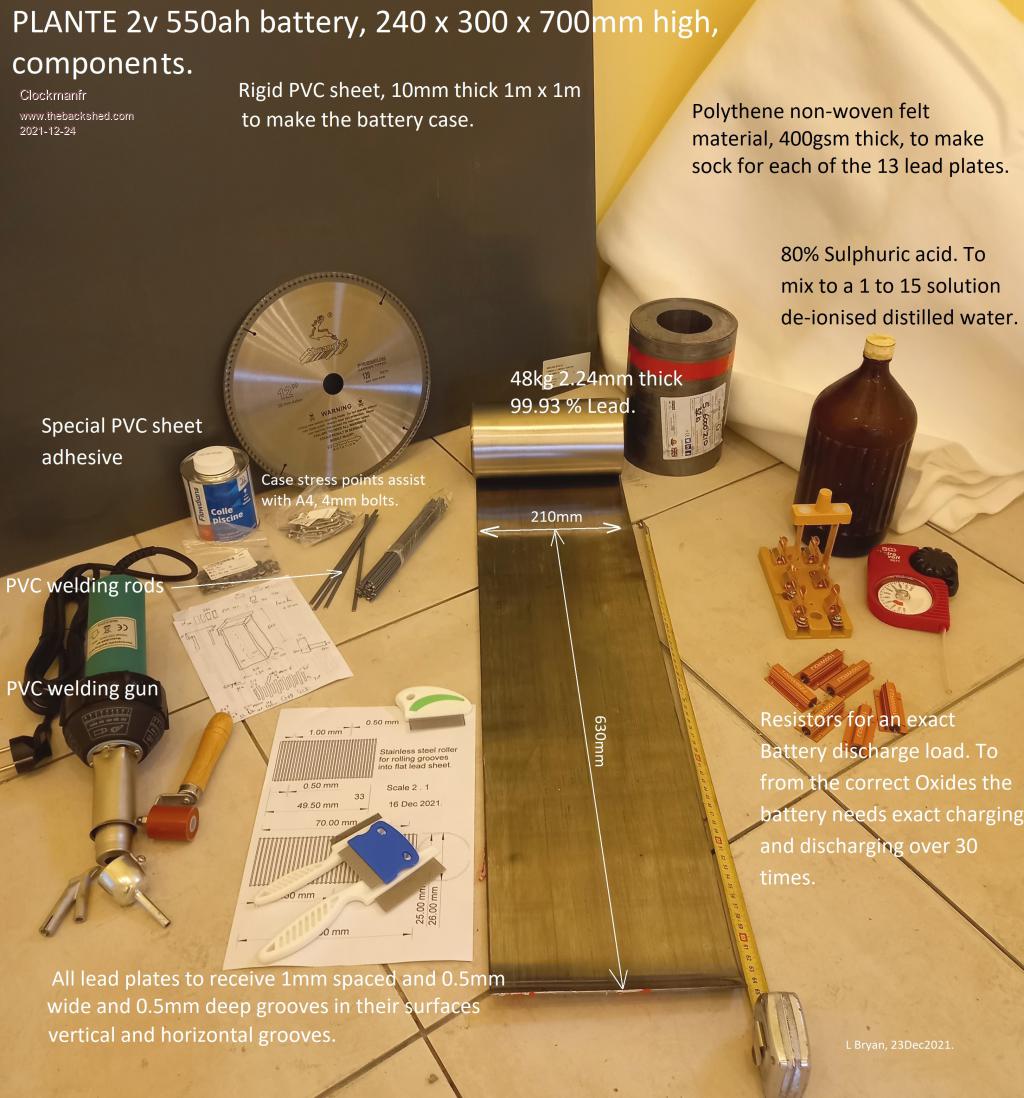

The case can not be defined to exact dimensions until i have made the socks and stacked the plates together. This will then determine the inside dimensions with the socks on.
The 400gsm polythene non woven felt Geotextile is really porous for the acid solution. Polyethene is the same as polypropylene at handling 80% pure sulphuric acid.

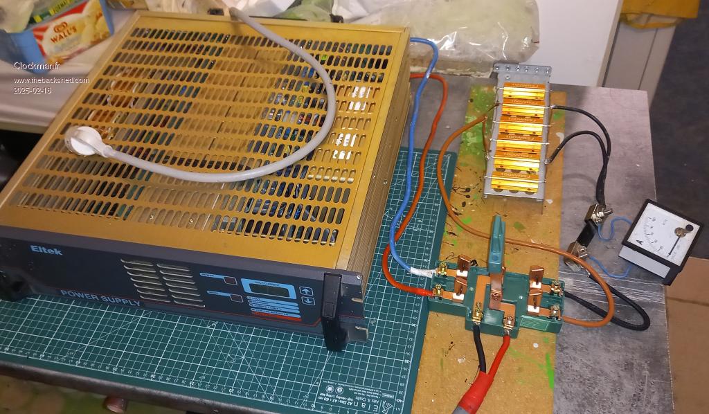

I need a knife switch as the voltage is low but the amperage is high, and especially as i have so many charge and discharge cycles required before the battery is ready for use.
The battery weight was my main size criteria ie, what can i lift on my own, so i stuck to something around 50 to 60kg.
What i am trying to do is keep equipment that is required nominal, ie what you yourself will have to get hold of.  But i will supply if needed, a stainless steel hand roller that is pre machined with the correct groves at the correct sizes, polished and about 26mm diameter and 55mm long. This roller will therefore give consistence results to all plates equally. The plates are 2.54mm thick so you do not want those grooves to deep.

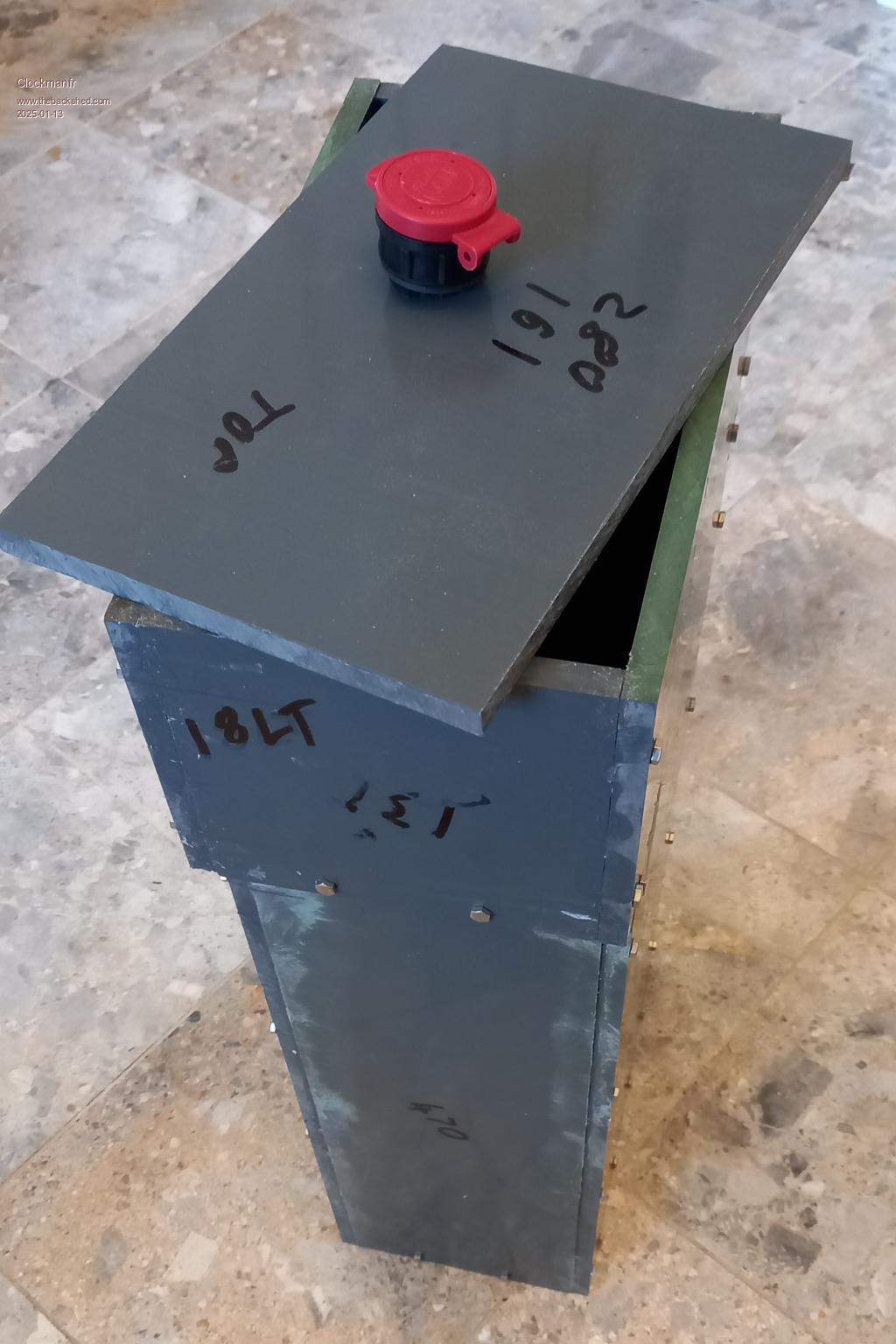

Regards case. The top will be removable ie bolted on, although still struggling to get small quantities of sealant with VITON in it for Europe.
The top has hangers and the plates are also supported at the base on alternating positive or negative supports.

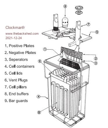

Top of the case will look like this photo.
Edited 2021-12-24 19:42 by Clockmanfr

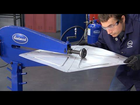

  Quote  I will supply if needed, a stainless steel hand roller that is pre machined with the correct groves at the correct sizes, polished and about 26mm diameter and 55mm long. This roller will therefore give consistence results to all plates equally. The plates are 2.54mm thick so you do not want those grooves to deep.
If I were doing this myself, I think I would buy a small bead roller machine either from flea bay, or secondhand from a tool/machinery/junk dealer.
Something like this perhaps:

Thank you for your reply. So the plates 'hang' on the cross bars of the post pillars and make contact to them due their weight? Or is there another, perhaps more secure, electrical connection between hanger and cross bar?

I am trying to keep the contacts from the plates themselves to the case as minimal as possible hence the hanging concept. But this will also need assessing and i might form small plates from the plate support bars that could take a lead rivet through them. But again needs accessing for simplicity and simple as possible build process.
Also have to work out if the battery itself were to fall over what would happen?
Yes, i have plans, and tested some stuff, but its trying to keep it simple, Robust and yet cost effective.

Posted: 09:45pm 25 Dec 2021
  Quote  a hand roller that can be manually pushed into the lead for vertical and horizontal grooves.
It might take a lot more applied pressure than you expect to physically displace lead over the width of a practical width of roller.
A decent bead roller can apply literally tons of compressive force, and a large diameter crank handle turns a relatively small diameter pair of rollers to slowly draw the metal between both rollers.
Its not obvious from some of the picture, but the upper and lower rollers are coupled by spur gears to prevent the rollers slipping on the material. Its usual practice to pair a convex roller with a matching concave roller, but almost any shape roller could be turned up fairly easily on a lathe to suit the requirement.
Bead rollers always have a fairly deep throat so beading can be done over the surface of a fairly large sheet some considerable distance from the edge, so beading directly across a sheet should be possible if the throat depth of the machine is sufficient to suit the length of your plates. A smaller sized bead roller may still be capable of putting diagonal grooves in fairly long plates.
https://www.youtube.com/watch?v=Z9hxXUYK36I
Those shiny new Eastwood machines look expensive, but something suitably old and second hand might turn up with a bit of foraging.

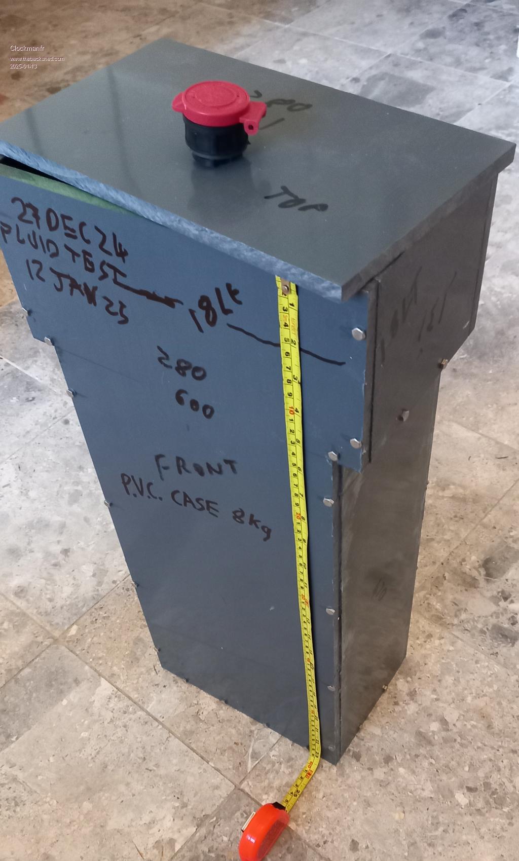

Clockmanfr
Joined: 23/10/2015
Posts: 437
Posted: 05:54pm 28 Dec 2021
This is the battery case design.
Alternate plate support at the top on that lip of the case and the lead bus bars with angle small plates and lead rivets.
At the base thinnish PVC support strips for lead plate support that also alternates.
