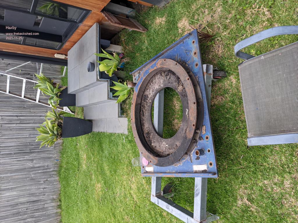

So I bought a 1m diameter bearing, a 3 horsepower 3 phase motor and a VFD as a starting point....
The bearing is courtesy of a truck coupling. This is the bit that a Prime Mover truck connects it's trailer to. I'm told it's rated for 40 tonne, so it should be plenty. It spins freely by hand.
It comes on a 12mm steel base, and is very very heavy.

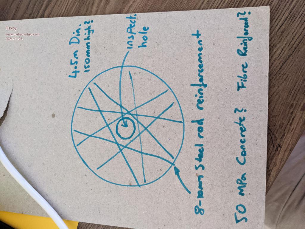

Now my original thoughts were to weld up a steel platform on top of this, and have the traditional castor wheels on the outside circumference.... but then I thought it might just be easier to form out and pour a reinforced circular concrete slab directly on top of the bearing, with a circular centre void to be able to grease up the bearing periodically. No outer castors at all, so the concrete would have to withstand a cantilever force as the car drives on top of the slab.
So my question for the group is whether there are any concrete experts here that could advise on what type of concrete to use, and what reinforcing to use. Just off the top of my head, I'm thinking 8mm steel rods running at a tangent to the centre inspection hole.
All thoughts appreciated!

OK firstly a 4.5M diameter by .15 thick slab will break on the first test if a heavyduty rio cage isn't built and 150mm is too thin to take the load of a small car let alone a 4WD.
One would be better served fabricating up a steel turn table and heayduty one at that and outer caster would be needed. A steel fabrication mob could roll some PFC to the required diameter for the outer caster/rollers which would support the weight.
but with the cost of doing all this it would be much cheaper just to do some earth works and concrete in a round about so the cars can turn around

There is a sharp bend in the driveway that is a bit difficult to navigate while reversing and there is not enough space to turn around without doing about 3 to 5 maneuvers once you are in, so the turntable is an intriguing solution.
And since I have the big bearing, I feel that the solution is to build a platform on it, either with traditional steel pieces or with some other material.
The appeal of concrete would be that it could be formed and poured in-situ.
I just have no experience in working out how thick it should be or if there are other tricks of the trade such as reinforcing with glass fibre etc.
Another thought was to form the concrete mould with some thicker ribs, and a thicker circumference, but again I don't know how to start modelling the dimensions that I need.
I can calculate steel beam deflection but concrete is a mystery to me.
The other appeal of concrete is that I could cover the top with bluestone tiles. That's something I couldn't do with a steel platform.

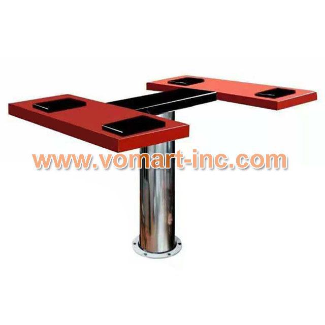

Back in ancient times, every local garage had a classic single post in ground hydraulic car lift that you could drive straight on to. Something basically like this:
Haxby's turntabe is large enough and strong enough to support something like that without needing casters at the corners.  I would just build a heavy steel H frame or X frame along similar lines to the above.
On top could be a couple of standard car ramps or a round carousel.
My preference would be for wooden decking that could be removed. Concrete would be too permanent and immovable if you ever needed to get at the turntable.

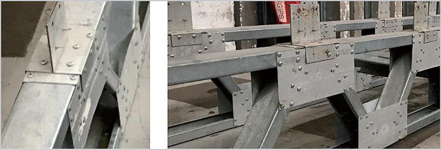

Posted: 05:22am 26 Nov 2021
If you want to build an x frame, it can have more than four legs. Maybe six ?
If you use I beams, they all radiate from the centre, bolted to top and bottom gusset plates. Upper plate is in tension, lower plate in compression.  The further apart they are, the stiffer the whole thing will be.
