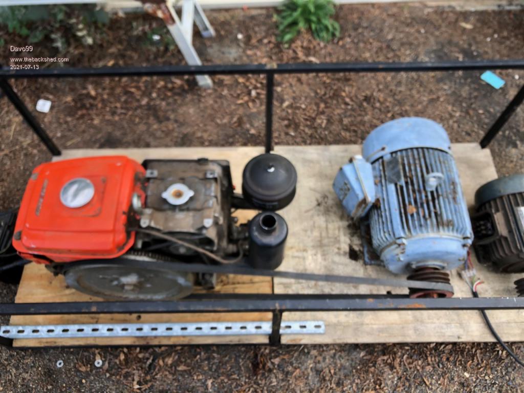

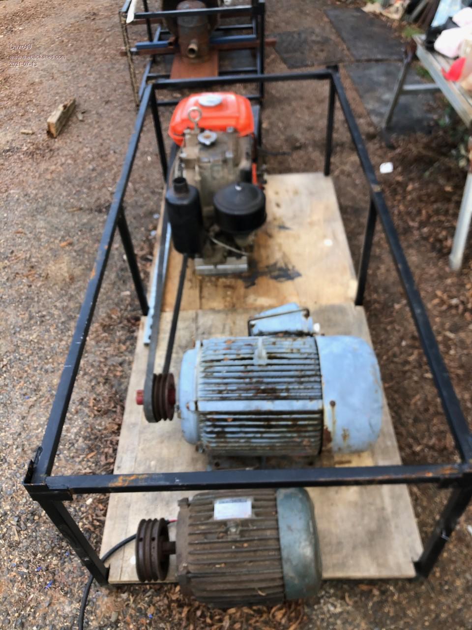

I went out Foraging this afternoon and found some steel  frames with plywood bases. They were at the local mower shop  and probably had  small rideons or garden machinery on them.
Made of 20mm steel square tube they are 1800 long, 800 wide and about 480 High.  Plenty of room in every dimension bar height. I didn't even measure any engines till I got home and found I'd really like about 800 High to allow for a thicker base, engine mounts and decent clearance.
There were a pile of the things down there that were stacked up so I'll go down again tomorrow and get another then I can extend just weld a couple together to extend the height and cut down the length to what I need. Probably a bit on the wide side but I'm not going to worry about that.
The frames are slightly raised so I can easily get the forks on the tractor underneath to move the thing but I'll probably try to put it on castors as well to make it easy to move on pavement.
I also picked up some nice pallets.  Plenty of decent slats in them, only softwood but should be OK for attaching to the frame to make sides and a lid.  I'm thinking of having the top lift up and the front fold down for easy access but still to figure best way to go about the front.  Might go down and pick up a few more of them tomorrow as well to ensure I have all the slats I need. Will just about be the right height as well, Might get away with not cutting them down at all with a little overlap at the top and bottom.

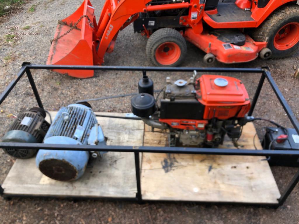

Went out yesterday and got another steel Rack.  With the two of them stacked, I probably have enough headroom for a Lister in there.
Also managed to pick up some more Ply and some more pallets.
Not sure which way to go now. Sure be a lot easier to cover this with just ply but If I do it with the pallet slats there may be a bit more soundproofing. and it may also look a bit more decorative than the plain play.  Be a hell of a lot quicker and easier with the ply as well.

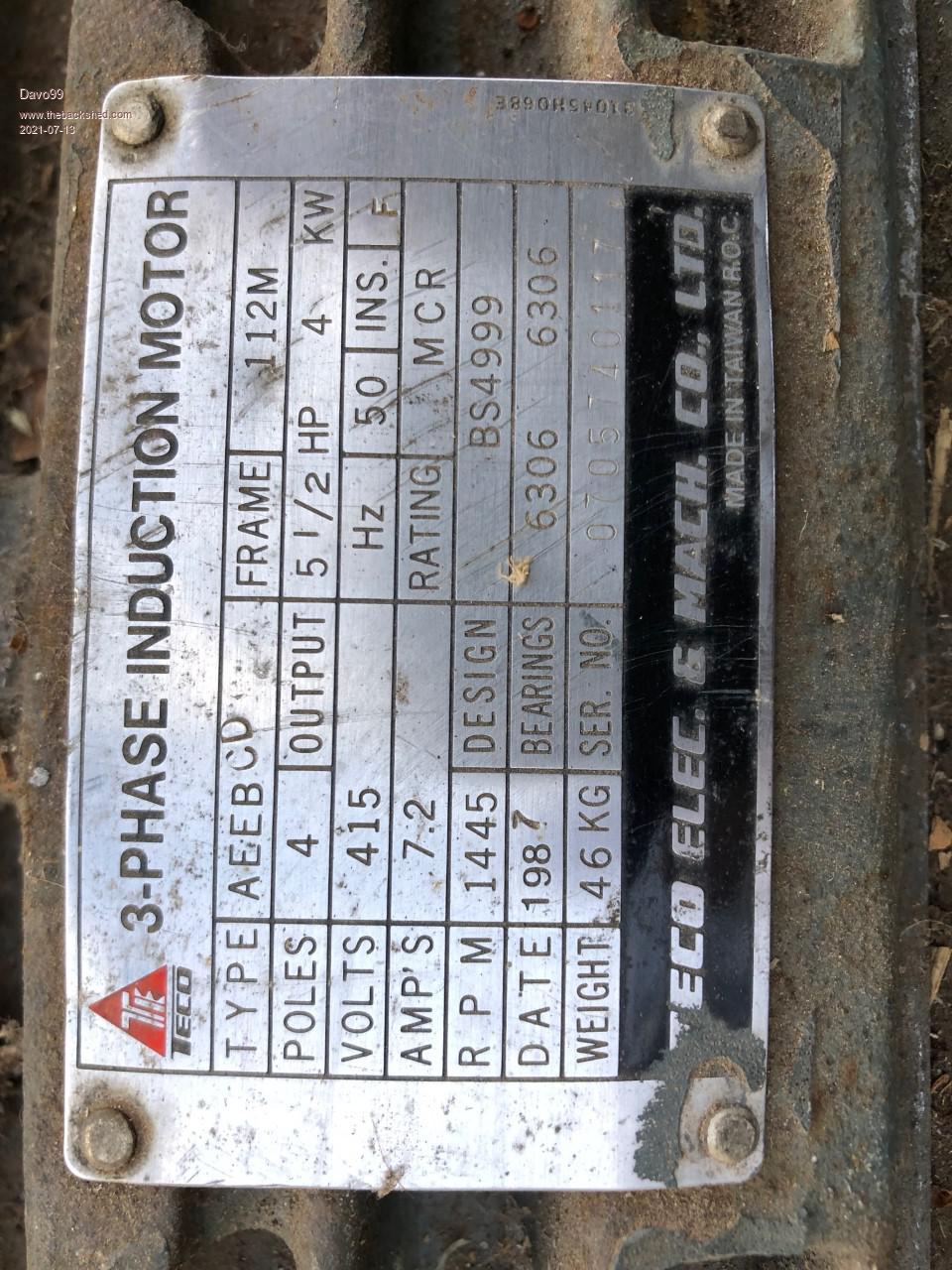

I realised yesterday that the Big motor I have is a 2 speed. That may be handy for gearing as the engines I have use 3 Bolt Pulleys which are hard ( impossible) to get in larger sizes and really too small for the pulleys on the motors which I don't want to make any smaller and have problems with belt slip due to limited contact drive area.
It's a big motor though and would be so under driven for the weight and size I'll really have to think about this.  I'll look at the 12 Hp Motor and how that will fit in the frame work.  That is going to make for one heavy setup there so then I'll have to look at the all up weight and see how portable it's going to be and if the tractor will be able to put it where I want.

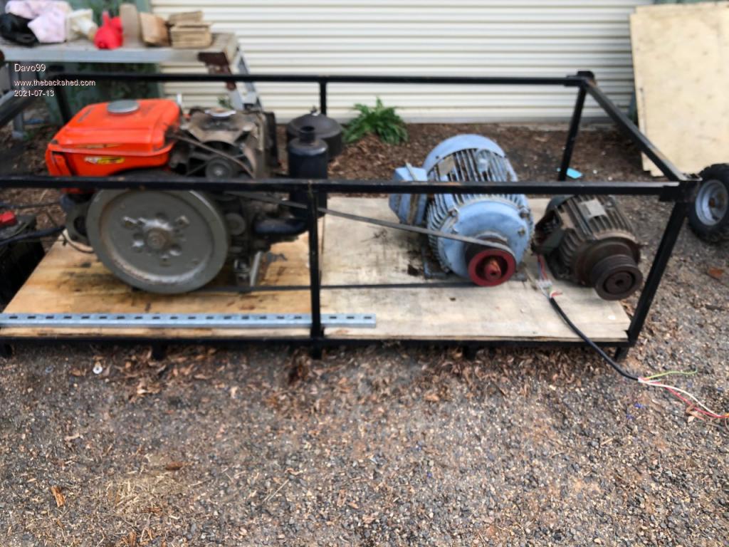

I might try and Drag my 12 Hp engine out today and see how it fits up in the racking I got. If that's OK I'll get out the big motor and try that then see how heavy it's all going to be.  I remembered there may be a 5 Hp up Diesel up there but can't remember if it's electric. Actually, Now I think of it, I believe it is but I seem to recall it's also an air cooled.  Bugger.  Spotted it buried the other day while Digging around. That will take some exhumation.  Also found an 8 Hp but that's Air cooled as well.
Think I should sell some of these and put the money towards an inline Kubota.
