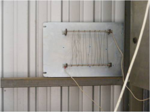

Well with summer coming on my original dumpload wasn't cutting the mustard as it only drew 8 amps and my main battery bank was going over voltage. . Anyway yesterday I decided to make a new dumpload and the first attmpt was disaster. The ohm load measured 0.24 ohms and I didnt get upto the shed early enough this morning and the fet on RossW's controller board was toast.
The Version 1 Dumpload

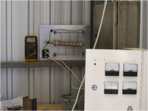

The next pic was taken just after I finished connecting everything up. The dumpload was sitting on 24.5 degrees which was the temperature in the shed. The guages on the left are for the main bank and I had 250 watts of PV going in, the guages on the right are for my backup bank which spends it's life on float.

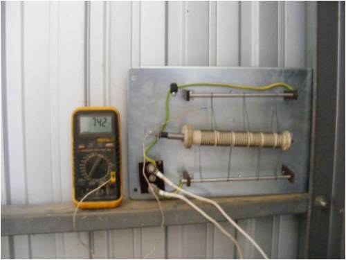

The next pic was taken about 10 minutes after the dumpload started kicking in, the new fet was switching nicely and as shown it didnt take long for the dumpload to get to 74 degrees. . The fet was getting warm so I put a decent heatsink on and the white former in the middle stayed cool as . Time will tell but hopefully I got everything right and this dumpload will see me out.
I managed to get the ohm load down to 1.5 ohm's so as I get the dumpload to kickin @ 28 volts thats about 18 amps of load.

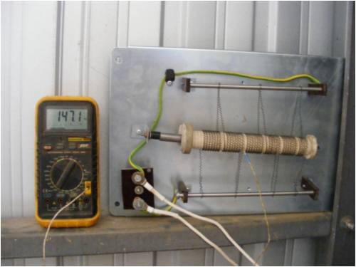

Edit: This pic was taken 1 hour after and I did see 150C but when I took the pic the temp dropped.
